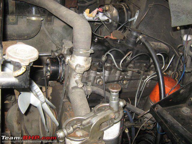

Mechanicals being done...
Finally the mechanical works started.I had an expectation that being a 98 model jeep the
engine will have to be overhauled even though the meter showed only 15338 kms. Once the
engine was fired there was no smoke visible.The 4 cyl, 2.5 litre, heart XD3P, turned out to
be healthy. Just a good oil flush/change and the pump/nozzles serviced with new diesel
filters used. Ofcourse the water pump,starter motor and alternator needed to be serviced,
but no major spares required.
