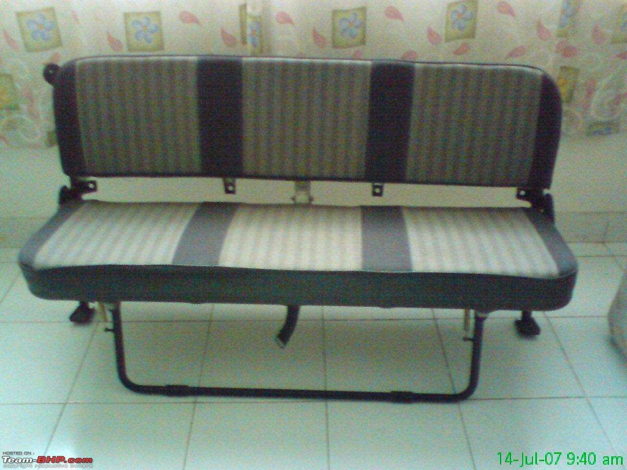

I still have my original rear side seats, and jump seats if any one interested PM me.
My Army Spec "Demon Gypsy": Project Complete-gypsy-orig-seat.jpg
My Army Spec "Demon Gypsy": Project Complete-gypsy-seat-.jpg
