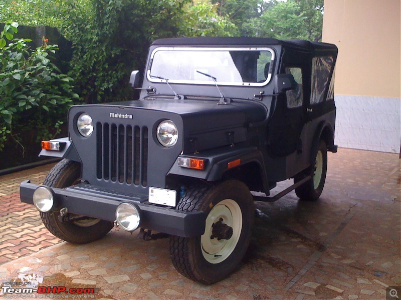

Did it have both 2wd and 4wd. How about the cc and gearbox. Is there a specific way we can identify that it is real CJ500 only, for eg like the company etched name or so on engine block or on the specification plate can we rely on which is usually found near the ignition key on right next to steering column. When did they launch CJ500 and till when was it available. Can you give a brief on CJ500 jeeps, the major pro's an con's of the vehicle, and in case I am about to purchase and use it for mild off roads too.
Attaching the photo in case. First time trying this option.
rgrds
prsn
