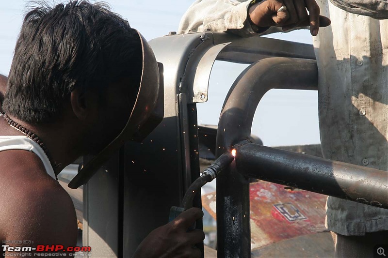

roll cage
4 points of the 6 point roll cage DONE DIY redoxide paint job will be painted mat black soon
The idea was to have a 6 point roll cage made without having too get rid of the doors and the b pillar and the stock soft top/fitings.
Thanks to my friend Sanjay Kale (another jeep nut)
Shaym the pipe bender.
Dinesh and gang for the fabrication.
will upload wip pics soon

what kind if welding is used TIG or MIG ?

David, a few queries:-
1. What size pipes are those 1.75" or 2"?
2. What thickness mounting plates have you used, they look pretty thick. Have you provided reinforcements under the panels?
If you have plans of getting Front facing seats fitted along with Seat Belts (ELR type), you can get 7/16" UNF size threads tapped on to the roll over bar at appropriate locations (otherwise the ELR will not work properly)
Looks like it is MIG welding. Can't see the filler rods also!

I think he's using one plate on top and another under the body panel.Will the panel still need reinforcement?
Also is this the best way of installing a rollcage?Are there any more methods of installing a rollcage?

Mig
If you have plans of getting Front facing seats fitted along with Seat Belts (ELyR type), you can get 7/16" UNF size threads tapped on to the roll over bar at appropriate locations (otherwise the ELR will not work properly)
Spike
PS- Please use washers also if possible.
These are 2" seamless pipes , cold bending was done, a very good job done by the bender as there was no crumples on the pipe at all
The plates used are 5mm thick, one plate is on top and one is under the body and body is sandwiched inbetween.
Is there more reinforcements under the panels required ???
no front facing seats im going to get my bench seats cut and fited
Yup mig.
Yes washers with new nut bolts will go in once the paint job is done
This is the best was hahaha well its sure is the easy way
