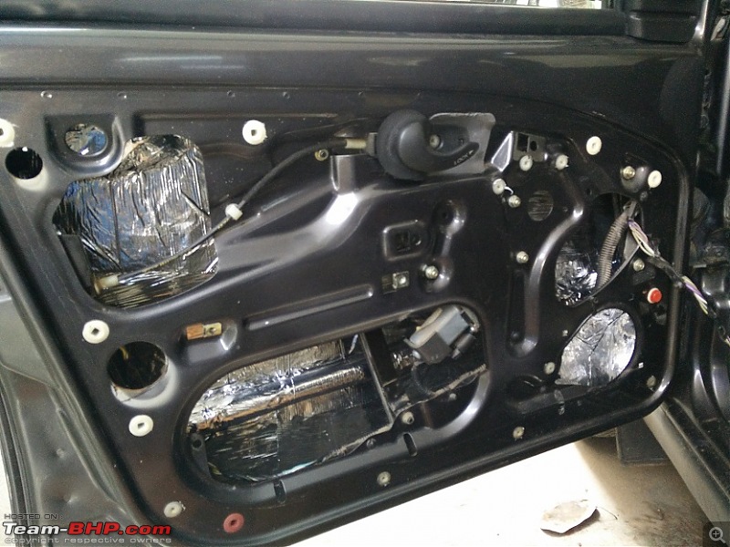

I have damped my car similar to what ::CMS:: has done. Few pictures :
Front left door WIP.
Front Right door WIP
One layer of tar sheet skin added to close off any holes after damping the interiors
Hatch finished in the same fashion
Boot, spare wheel and rear floow damped
Rear wheel arches not spared :p
Whatever has been done works well but I'll take it to the next level, inspired and with lots of help from ::CMS:: :thumbs up
