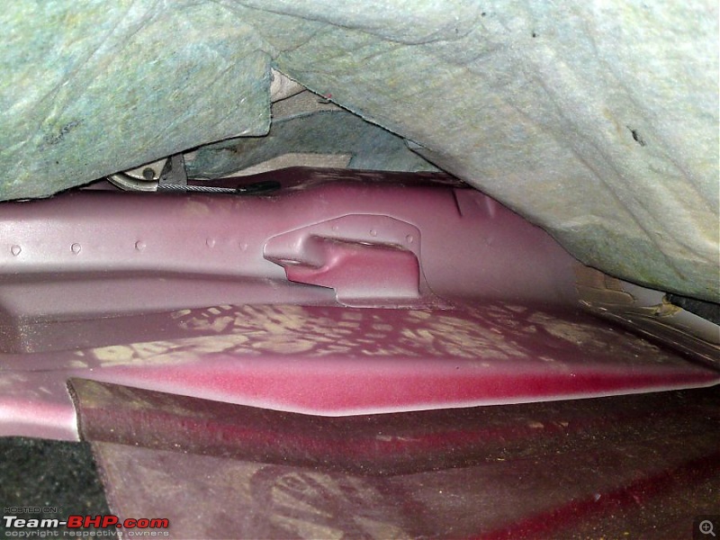

@Nirmal, if you are going to damp the floor, then try 3M / Wuerth under-body - as pointed out in recent posts. I dont think applying sheets inside will help that much. Any way, the manufacturer would have already put in at least some amount of sheet there (from inside).
Here's a pic of the damping by Ford, in the Ikon. Section is the left passenger (rear seat). The sheet is in the lower section of the pic. The black part on the left is a fabric sticker. The middle one-third shows the bare-metal mid-floor ridge, which is not covered.
