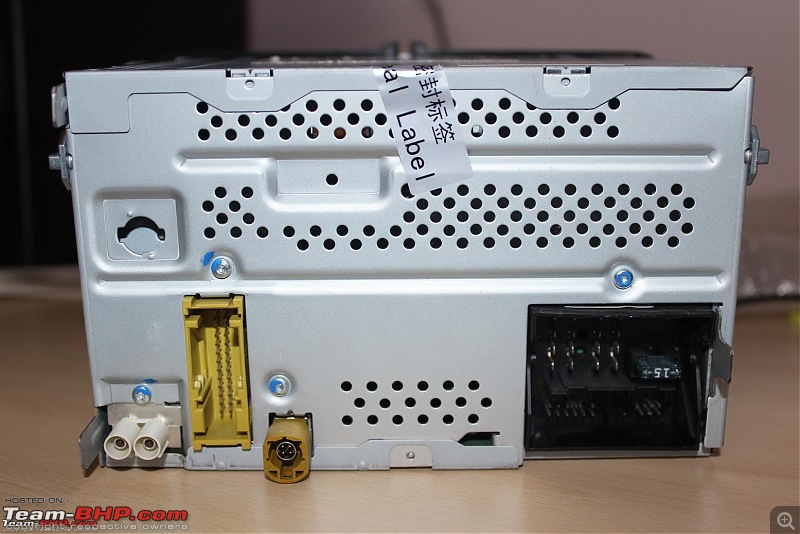

also depending on the manufacturer support for Reverse camera differs, RCD510 have been manufactured by both Delphi and Bosch, but only one of them support a reverse camera input, But I don't remember which one.
The Delphi variant. Here’s a pic of the rear of the Delphi unit with the mustard yellow 26-pin connector:
