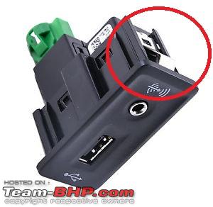

How about the space in front of the cupholders here?
Image link
Thanks Ganesh.
I was hoping to find an enclosure that'll suit the clips highlighted in red below and then slot that enclosure in the space you pointed out. Else these clips may tend to vibrate over time.

Originally Posted by ventoman View Post
Thanks Ganesh.
Attachment 1831255
It's a push fit USB socket with metal clips to hold it in place. You don't need any specific enclosure. Just get the sizing of the hole right by cutting one on a small piece of plastic sheet first. Start from a smaller one and use the Dremel or a sharp hobby knife to chip off the extra material. Insert the socket and check if it fits snuggly. If it is loose, try it again starting from a smaller hole.
Measure the dimensions of the final hole and transfer it to the place you'd want the USB socket to be placed. That's how I did it on my ride.
