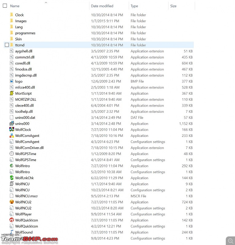

To all those having doubts about how their root directory on Pen Drive should look like, I am posting a screenshot of the same to help ease the install process.
Dear BHPians, we can also change our Medi@Skin theme. Copy and Paste any skins you like into, WolfNCU->Skin

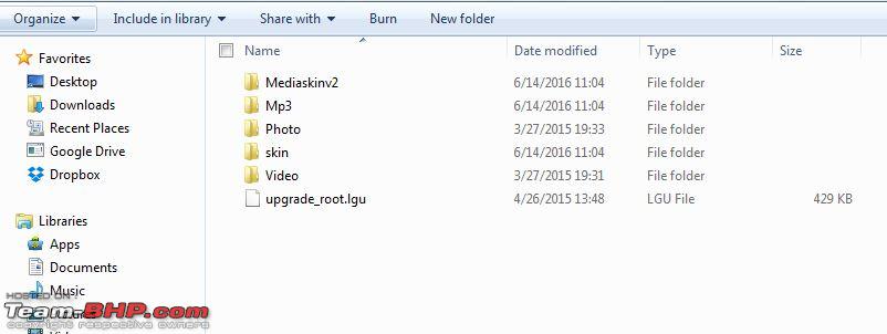

I've tested this today a lot & everything except GPS seems to work pretty good but that's a known issue. This project is in continuous development so expect stable releases in future. There are some slight procedural changes i had to make to get it working for me. But there got to be more than one way since it worked for Wilson. I'll list what worked for me & how.
One of the first things i did after bringing the Kwid home was map & firmware update. So before getting to know the technicalities of enabling video, i inadvertently upgraded to 4.0.6. Then i went looking for system access for video playback & came across Menavrus & Mediaskin. The former is paid & the latter needs 4.0.3. I had to shelve the plan since i couldn't find the older firmware anywhere then for a re-flash.
Fast forward, this thread happened. And it works. Also, even 4.0.6 is now supporting Mediaskin versions but i downgraded to 4.0.3 already before reading that. It still works, so be it.
What worked for me:
Resolution 400x225 @3000kbps w/ 128 kbps audio
Format MP4 & MP3
How it worked for me:
Downgraded to 4.0.3
Copied USB folders to root.
Copied the lgu file to root.
Plugged in & let it upgrade a 2nd time. Unit Restarted.
Rest of the process is as below.
ONLY THIS EXACT PATTERN worked for me. Otherwise, button taps won't trigger Mediaskin. Might be different for others.
Also, only this skin had access to all options & looked less gawdy. Sadly a better dark skin available has the music option missing.
This is how my drive root looks like.
DIY: Enable video playback on Renault's ICE (Kwid / Lodgy / Duster)-root.jpg
Anything above 400x225 causes gradual increase in screen tear & stuttering but audio plays smooth. 400x225 gave seamless playback for me & it looks pretty good. The screen is good quality with great field of view from the sides but it's a pity the processor can't handle much.
The performance would be much better if the unit itself is flashed but then there is the warranty thing. Since the video playback is smooth, i'll stick with live disk for now.
