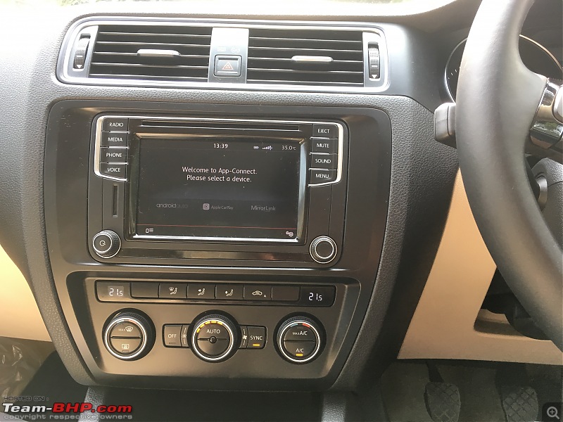

If you own a late model VW Polo / Vento / Jetta with the MIB II system, you're in luck.
Big thanks to a Team-BHP fan (who prefers to remain anonymous) for sharing the following information:
I'm happy to inform you that VW cars sold with MIB II now have the option of getting App Connect (Apple CarPlay, Android Auto, Mirror Link) activated at the nearest VW Service Centre. I got it enabled on my 2015 Jetta which came with MIB II.
To enable it, the service centre installed the following components:
1. App Connect package, part number 5G0054830A ₹17717.51
2. USB Port, part number 5NA057342A ₹9039.65
These are available officially at VW Service Centers (some dealership executives might not be aware of the same). I got it installed from a Mumbai VW center. VW has sent an mail to all workshops regarding the procedure to enable App Connect and Voice Commands.
You can also enable Voice Commands, but the licence for that has to be purchased separately.
Once the phone is connected to the car via the USB cable, the voice control button (on the steering wheel) can be used to interact with the voice assistants on iOS or Android.

Hi
Would be grateful with some help on this
I got the App connect activation as well as the USB port,
But apple car play doesn't work
Before I changed the USB port, I would get "USB: Device not supported" error
So got the USB part number mentioned here
Now after the USB port change, there is no error, but system doesn't recognise the iphone.
I use a iPhone 7plus
For the record I have tried all other models of iphone too from 5s to7plus
The system doesn't recognise media on the phone, images on the phone, nor does it show up on the app-connect
Also peculiarly, on the app connect main
Android auto
Apple car play
Mirror link
Shows up in the settings, for preferred connection, it shows android auto and mirror link only
Please advice

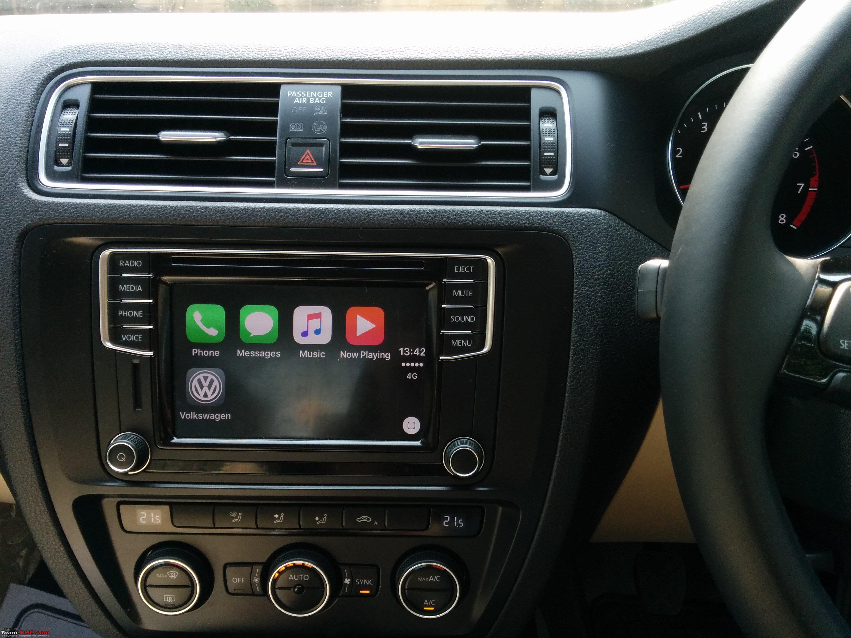

Hi
Finally succeeded in installing and using car-play in the VW jetta MIB2 unit.
Had to procure VCDS cable from Ali express.
However, now the feature is enabled and working
