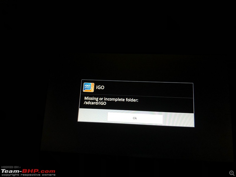

I am getting this error since some days. Tried to pop-out the pop-in the sd card containing the map.
Pls see attached screenshot.
any idea what could be going wrong?

Your sdcard that contains maps is not getting detected. Either it is removed or corrupt.

Okay thanks and can we fix it or have to take it to the Honda dealership ?
