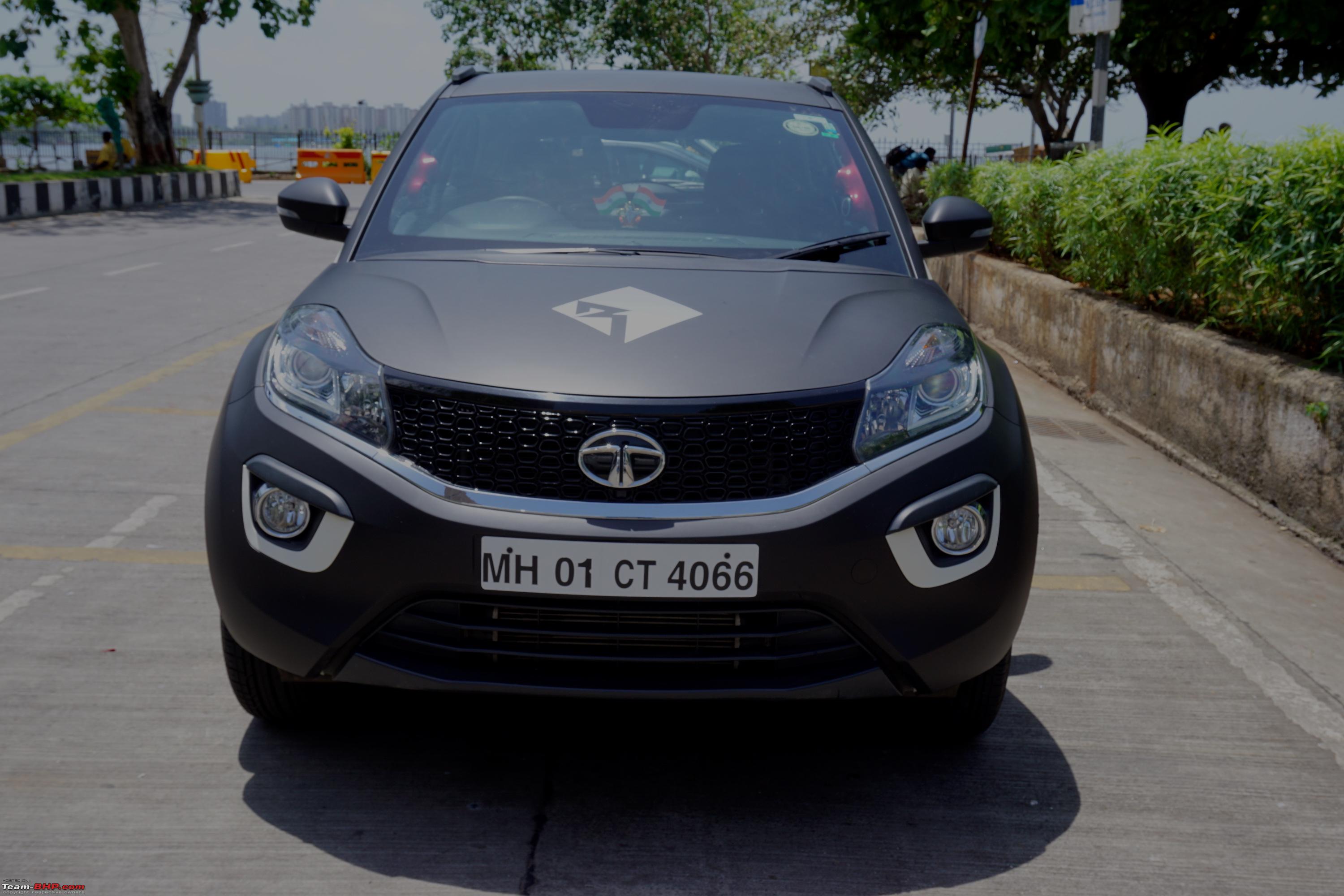

Looks like a regular Nexon, minus the wrap job & branding:
