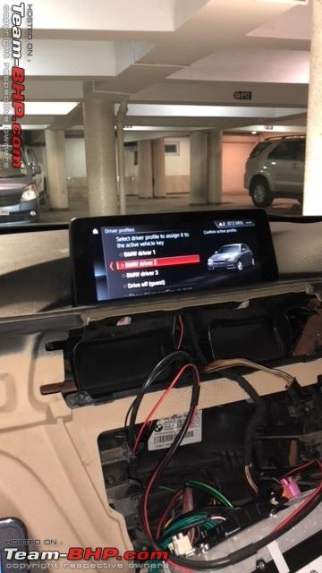

Finally one rainy Sunday in July 2019 after all the parts had arrived (took more than 2 months), I went to a friends enclosed parking area to start the retrofit process. Followed several youtube videos and eventually got everything disassembled and then installed, tested & programmed. At the end of the day, I had carplay working however I was unable to get any car information on the Idrive display as I could not update the car firmware as I needed a special cable. I left the car in this state as I didnt really need anything else and didnt have the time.
DIY : BMW 3-Series (F30) Head-Unit NBT EVO Upgrade-img_5076.jpg
DIY : BMW 3-Series (F30) Head-Unit NBT EVO Upgrade-399d43677e8949ea9ca973e1a457d1a3.jpg
DIY : BMW 3-Series (F30) Head-Unit NBT EVO Upgrade-55e7c732bce14f26ae97d53fb7a11153.jpg
DIY : BMW 3-Series (F30) Head-Unit NBT EVO Upgrade-cf3fafb6927b40a88bc38e2b976fe179.jpg
DIY : BMW 3-Series (F30) Head-Unit NBT EVO Upgrade-b0bab14f0e6e49b8814b02c0f453daf7.jpg
DIY : BMW 3-Series (F30) Head-Unit NBT EVO Upgrade-img_5106.jpg
Fast Forward to Jan 2020 and BMW refused to carry out maintenance because no DATA - So decided to 3d print and make the harness - Put in the new FW - Attached the OFC and voilla everything showed up. Project was finally complete.
