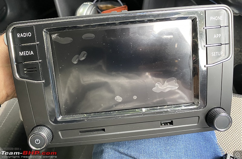

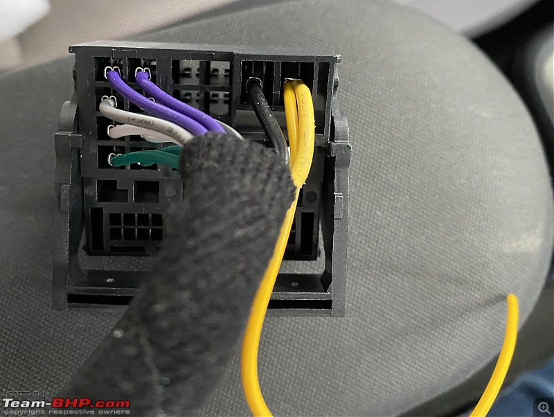

Hi,
I just received this RCD360 pro from a friend. It has carplay and android auto.
Looks like this is for the MQB platform.
The adapter cable which is supplied is for PQ-MQB.
I have 2 issues once the unit is plugged
1. The unit does not get the signal that the ignition is turned on. So Bluetooth, steering controls and music system button lights are not working. However Apple CarPlay is working.
2. The auto AC is in a continuous ON/OFF cycle, which is the main worry.
Is there any decoder or something which is needed to be connected to the yellow wire which is hanging loose in the adapter?
The yellow wire is connected to the battery pin on the system.
Anyone has been successful in fixing these issues or it’s better to get hold on an RCD340 .
Need help form the gurus.

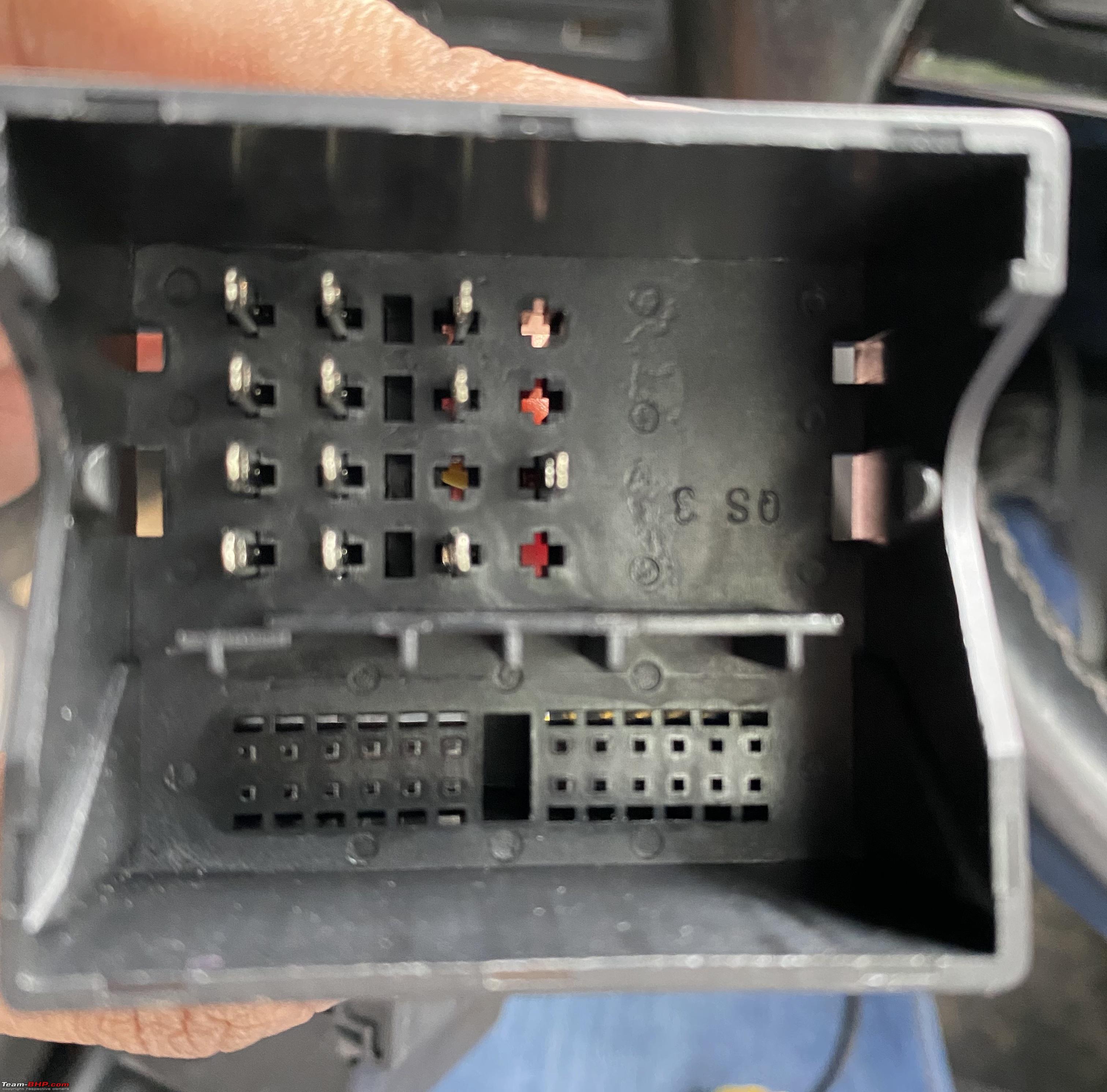

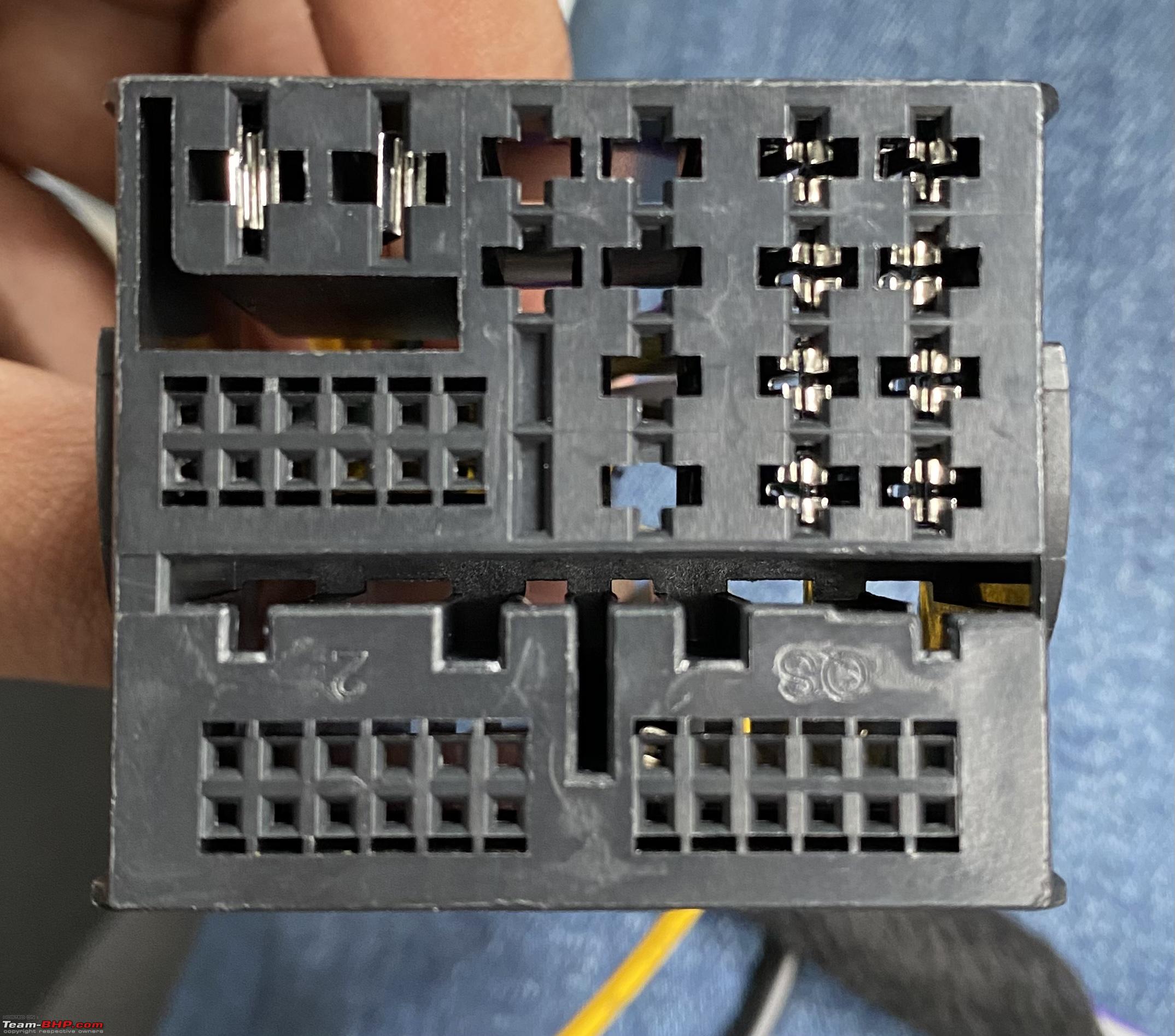

Originally Posted by prajnya View Post
Hi,
Trust the cables from the quadlock connector are wired properly? I see that the CAN + and CAN - terminals in the unit have moved to the smaller 12 pin of the quadlock.
How to get Apple CarPlay in my VW Polo?-fe01fe032e4c40a2ae3089256e7d08cd.jpeg
For the earlier RCD units, it was in the main connector. Plus, the quadlock connector itself is different.
Please post an image of the terminal side of the connector.

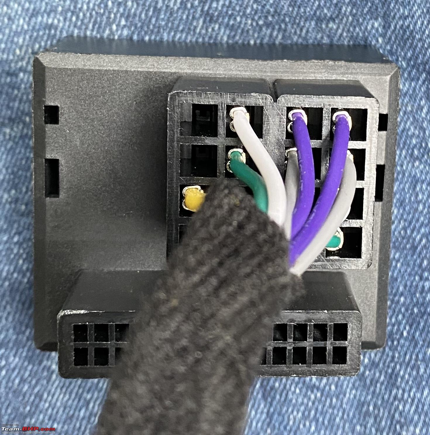

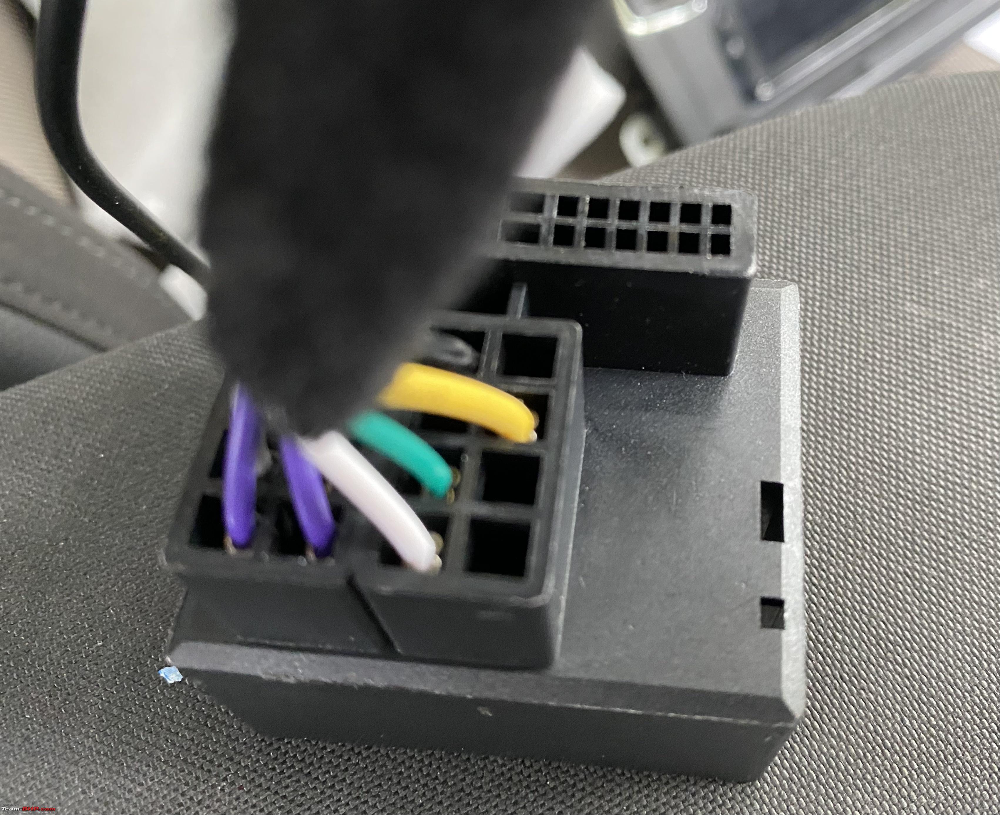

Join Date: Oct 2020
Posts: 38
Thanked: 83 Times
Re: How to get Apple CarPlay in my VW Polo?
Yes.
The positions of BAT, GND, CAN+ and CAN- have changed.
But the connections seem to be correctly configured.
First three pictures are from the adapter which connects to the stock quadlock.
Last two are where the adapter connects to the new head unit.
