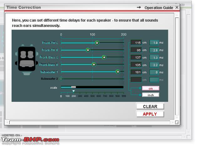

Originally Posted by Autophile View Post
Tweeters are never delayed as they are the reference points of the system and adding the delay to the tweeters will ruin the imaging. Thats why competitors prefer kicks as it gives maximum physical distance to the tweeters from listener. Midbasses are delayed to achieve stage height and better integration with tweeters finally the subwoofer is delayed to match with the front stage.
From your answer here you are saying that sub will also get some time delay.
I think you are 100 % wrong here. In a front + sub setup the sub will never ever get delay as it is the farthest from the listner. So by giving delay we virtually make it more away. Which I think is wrong.
Here is a screen shot of the alpine site hope you will understand what I am saying.
I10 - ICE Installed - Opinions and Reviews appreciated see page 24-ta-screen.jpg
Here you clearly see that the furthest speaker gets no delay unlike you specify.
A little more.
I10 - ICE Installed - Opinions and Reviews appreciated see page 24-time-alingment.jpg
