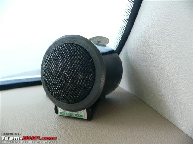

Pictures
I have tried to click some snaps.
Not come too good - too much glare, but should be OK to see;
I10 - ICE Installed - Opinions and Reviews appreciated see page 24-ispbarik-clamp-shell-load-sub-woofer-i10-illusion-leccent-2008-1.jpg
I10 - ICE Installed - Opinions and Reviews appreciated see page 24-ispbarik-clamp-shell-load-sub-woofer-i10-illusion-leccent-2008-2.jpg
I10 - ICE Installed - Opinions and Reviews appreciated see page 24-dynaudio-tweetr-custom-housing-assembled-installed-i10-april-2008-1.jpg
I10 - ICE Installed - Opinions and Reviews appreciated see page 24-dynaudio-tweetr-custom-housing-assembled-installed-i10-april-2008-2.jpg
I10 - ICE Installed - Opinions and Reviews appreciated see page 24-dynaudio-tweetr-custom-housing-assembled-installed-i10-april-2008-4.jpg

B,
dont tell me you are going to leave teh tweeters open like that. besides do the stegs have enough room to breathe?
Sir,
I had a custom housing made for the tweeters;
Yes, they will sit where I have shown them. The Angles may change - depends on the sound. Will keep changing & experimenting.
The Stegs - as of now - seem to have a long way to go.
I have put them 3 o'clock position & 5 is max power. This is for the components.
For the Subs, they are @ 2 o'clock. The Luccents cannot handle too much power. Specifications are best answered by B & T along with LBM. Gentlemen please do oblige.

Tweeter placement looks good to me. As it is on axis to the listener on the opposite seat.

Spot on !
You are perfect; Left tweeter fires @ driver & Right Tweeter is on axis to co-driver.

Dear "B" Almighty, is the tweeter blending well in this position. I am but a mere mortal but I would like to know, so do forgive me if this is a stupid question.
