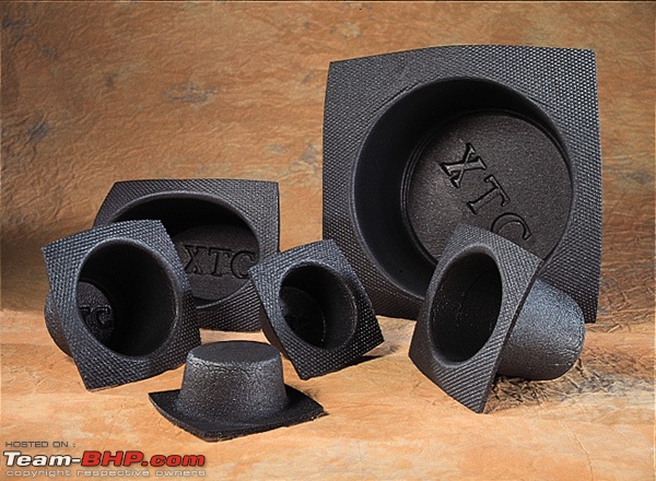

EDIT: by any chance adding a cup like this behind the speaker play have any undesired consequence, i want to buy it for this car. so that it wont cost me another set of components gurus advice please?

PS: Yup, those cups should help protect the speakers.

Beware. I looked at them before installing my speakers, and noticed that Crutchfield has really negative user reviews for those rubber cups. Apparently they really screw up the sound.
