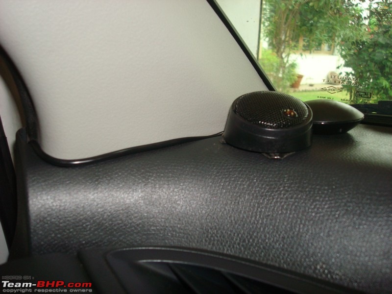

New location of my GPS. Locked the position quite fast now.

Nice.. Whats the GPS receiver make and model. Also did u integrate it with CF2.0 or had to load different maps specific to India?

Kiran. GPS Receiver is GlobalSAt BU-353. And yes i have purchased the Satguide Map.
all you have to do is copy the Map Folder into CF Dir. and load the MAP in CF.
