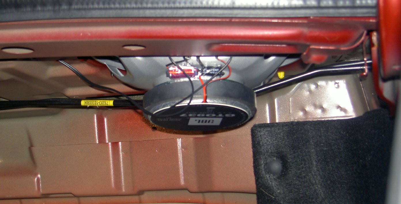

Ok guys this is one of the weirdest things I've seen in recent times. My friend had bought a Verna and on my suggestion went to get a setup done. Unfortunately the installer is a relative of his so he couldn't supervise much of the install & the following stuff was installed:
Velocity VPc172 components
JBL GTO 937
Pioneer 6850
Now when I checked the setup out I find that an inductor & another black object (don't know the technical name!) have been tied to the 937's with tape. I couldn't understand why so I took a few pictures for you guys to see.
The two parts in question
Now two questions arise.
1. What is this intended to do?
2. The setup has a problem that the 937's on being played at high bass levels are making a jarring sound as if it's grille is striking something. Now the Verna has 6"X9" pods in the back so no cutting has been performed. But I could not understand the reason for the jarring, I even tried it after turning down the Bass in the EQ but it remains.
Sam/B&T/Navin/Gunbir can you clear this up please?
LOL, it's not stuck with tape yaar.It's part of every GTO937. That is the passive crossover.
You got me all excited and now I realise what you were talking about.
Baaki bacha the vibrations could be cause by the speaker touching a metal portion. I suspect the installation can be improved a bit.
GTO937s have a tweeter attenuator. Some kind of push switch placed between the mid and the tweeter on the speaker that you push to contorl the highs. The contraption on the speaker probably has something to do with that. Sam?
Rags, I guess there isn't an amp in the setup, right? So it can't be a problem with the gains settings.
Do both the rear speakers have this problem? If it is just one, it could be a problem with that speaker, or with the wiring to that speaker. But if both have the jarring sound it must have something to do at the HU end.
Are both speakers screwed down real tight? If not, the sound could be them vibrating.
Is the vibrating sound coming from the speaker, or the area around the speaker -- loose plastic trim parts?
EDIT: WHoops! Looks like Sam answered while I was replying :-)
Arrey how do I know there's a passive crossover on the 937's, that's why I called & asked you. Anyways chalo learnt something new today!
No amp yet, so no problems with the gain there.
I think it's both but will check carefully once again tonight. Another friend who sat in the back said it's coming from one speaker so not absolutely sure.
Will check this too. Can anybody advise how to remove the stock grille of the Verna parcel shelf? Sam???
