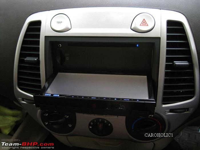

hey guys here's a pic of my new i-20 CRDI ERA
HU installed-Pioneer 4250DVD
i20 - Aftermarket HeadUnit possible?-189589_206965152652892_100000182253757_931638_630085_n.jpg

Wow! looks great!
Any pics or video of it in action?
and damages, if you don't mind me asking!

Thanks bro
Since i bought the ERA model the car came without any audio, but still i had to get the panel to get the double din installed in it. Posting a few more pics.

Nice pics bro. HU looks good.
Couple of questions.
1. How is the visibility in the daylight? Can you operate easily?
2. How much did it cost you? Does it come with bluetooth?

The visibility is good enough even in the daytime. The HU cost me 25,000(with 2years warranty) & no its without the bluetooth.
