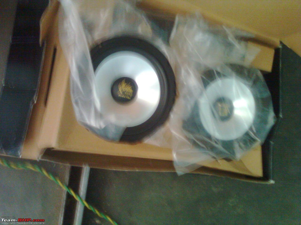

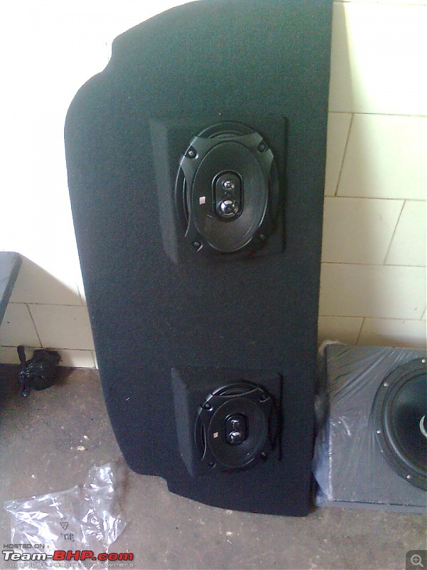

Here are the first batch of WIP pics. Today managed to make some time in the evening and got there right in time when the ICE work had begun.The custom made rear parcel shelf had arrived.What a lovely sight and right next to it was another lovely sight, the custom made sub enclosure with the Illusion sub neatly installed. Was waiting to hear them real bad.
For the rear fills the gto limited edition 947 coaxials were chosen. Not bad at all albeit a little too bright for my taste. Nothing a little tuning can't fix (I hope)
The front components will be fitted on the doors in the usual manner by using some space and depth of the map pockets and the tweeters will be placed on the door panel as well. Three mdf rings have been glued and screwed together for each channel. The mdf rings needed a little reshaping to fit the front comp speakers. The install will happen tomorrow. Expect finished pics of the install tomorrow or the day after (good quality).
Was waiting for the moment when all the wiring was done so as to power the amp. What a lovely feeling it was to see the blue glow of the indicator when the amp was powered on.
Once he HU connections were made to test the sub and the rear speakers, the excitement was hard to describe. The moment the cd went in and nd the track started and the gains were being adjusted, I was completely speechless. Then the bass kicked in and it felt real sweet. Every bit like how Frank had described. However I went in for a 1.3 cu.ft enclosure. Sorry and a big thank you franky.
The only thing missing now is the speaker cover/guard for the electras 6.1, that did not come with the speakers.Originally didnt bother about it as they were going to be installed in the Linea's stock location and needed no protection. If anyone has a spare pair I'd be very grateful for your generosity.
Can't wait for tomorrow when the components will be connected and the ICEin will be completely done!
Sorry about the picture quality. The usual phone cam stuff. Have had a really tiring day so its a very insipid post but the excitement within cannot be expressed. Finally my very own decent ice setup!

the custom made shelf does look good and also most importantly hides the sub from prying eyes as well as has its utility as a parcel shelf and aslo gives me adequate luggage space beneath it.
We have used 3 mdf rings per component mid bass and they were mounted on the door panel, by cutting into the map pockets.
The tweeters have also been placed on the door panel itself.

Mr.Pranav, from where did u get the rear tray for Wagon R? Is it custom built or readily available in Bangalore? If so, please give the details.
Regards.
B.R.S.Rao is offline
Old 11th October 2009, 18:31   #29
pranava999's Avatar
Join Date: Aug 2006
Location: BANGALORE
Posts: 845
Thanked: 23 Times
Regards.
Mr. Rao to the best of my knowledge it was custom built for the Wag. Have to still settle bills for the install and stuff so am not aware of its pricing but am sure it is within 1.5 to 2k. Its well finished and heavy and has been screwed to the brass holder/clamp
