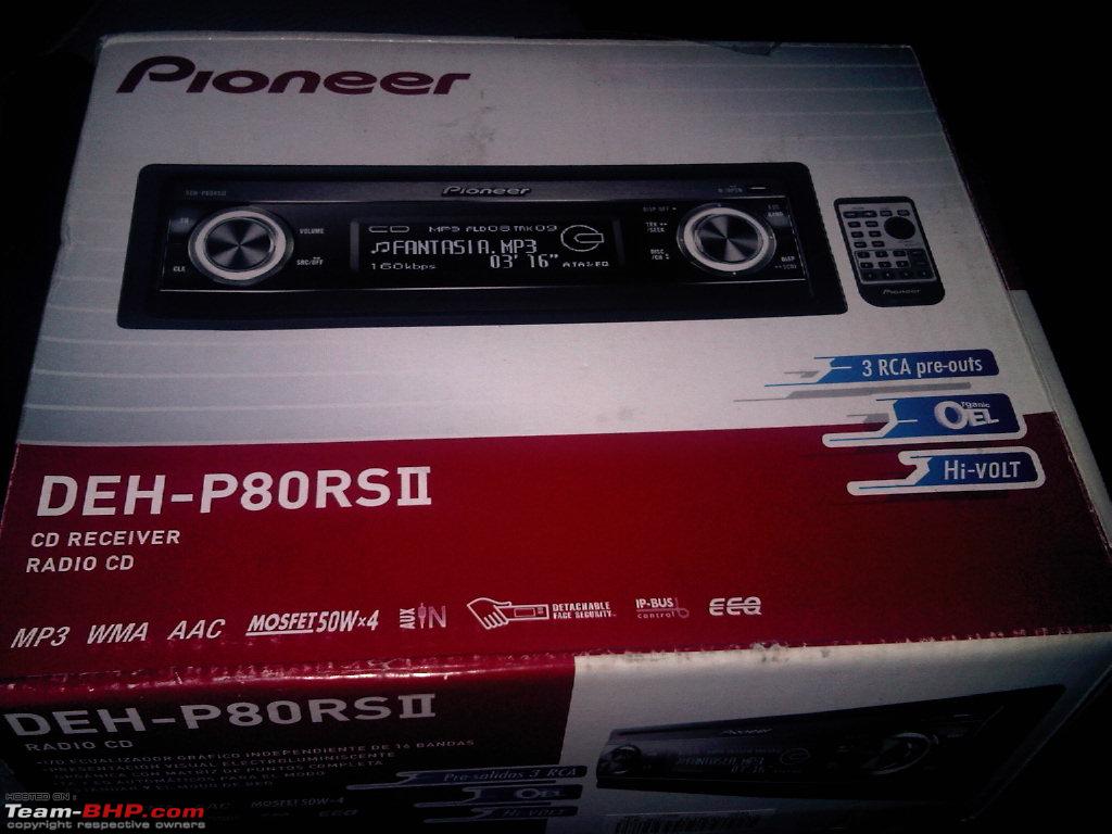

Update - Head Unit Upgraded!!!
Hey guys,
After a good number of posts on various threads and numerous PMs fellow members I finally took the plunge and finally upgraded my head unit. Yes, I do refer to this as taking a plunge mainly because of the cost involved in purchasing such equipment. As I had mentioned before, I had been thinking about upgrading to a high end system for a long time now but it never seemed to be the right time or my budget was always blown out of proportion. My previous head unit was the Pioneer 6950IB and it served me for a good 5 years and I was in love with it mainly for its full speed direct iPod control. It had 3 RCA outs with 4V each and sounded good. I had in a way gotten used to it. My speaker upgrade changed everything with the amazing clarity and I was very happy with the purchase. I thought that would be the end of my ICE upgrade and that I would be satisfied. But no, something inside me (probably Team-BHP) kept telling me that more can be achieved. I didn’t want to change my amps and it was no point changing my sub if I didn’t plan on changing my amps so the only way to improve sound quality was to change the head unit. Besides, I kept getting irritating alternator whine, hissing and other sounds which existed even after using good wires and RCAs. The culprit was diagnosed to be the pico fuse of the head unit. Now, I was in two minds here too as I was either looking to go in for a high end head unit or just a similar head unit to replace my 6950IB but didn’t know whether it would be worth investing in a high end head unit for the equipment I am running. Many said to go for it & many others said that it would not be worth it as the rest of my equipment; especially my amps would not compliment it. My high end options were the Alpine 9887 for 20k or the Pioneer P80RSII for 22k and the regular replacement was the Pioneer 7250SD for 8k. Huge difference in cost so my mind was telling me to go in for the regular head unit keeping in mind the budget, but my heart was telling me to go all the way once and for all!! My main requirement was direct iPod control which only the 9887 & 7250SD had. The P80RSII required a separate iPod adapter. But then was told that the P80RSII was better than the 9887 in terms of sound quality and tuning capabilities.
So after troubling a lot of BHPians especially B&T, I finally took the plunge and ordered the Pioneer P80RSII and had the same installed today and man all I can say is WOW!!!!! My system is a whole different ball game all together and I am just totally in love with my music system as I am hearing sounds from tracks that I have been listening to for ages and never knew such sounds/notes/tunes existed in these tracks!!! The result is just outstanding. But, I must give credit to the installer and tuner as B&T did a wonderful job in not only arranging the equipment but taking time out of his busy schedule in doing a neat install and brilliant tuning. I am totally blown away by the clarity which is now more soothing to the ears and can be listened to for hours on end. The Pioneer P80RSII looks great and sounds even better. All in all a superb investment and I can confidently say that it was totally worth it!!
So this is what I have now:
Head unit – Pioneer DEH-P80RSII
Front Components – Morel Tempo 6
Rear Components – Morel Maximo 6”
4 Ch Amp – JBL GTO 75.4
Monoblock – JBL GTO 301.1
Sub – 12” Infinity Reference 1200T in a sealed box
Damping 04 doors & boot - Noise Kill
Note:
1. All my issues with alternator whine, hissing and other irritating sounds which I have been complaining about have totally vanished after installing the P80RSII which confirms that the 6950IB was the culprit
2. If I am in awe while listening to music on the JBL amps, imagine what will happen if I change them to a more sound quality oriented amp? ;-)
3. Awaiting arrival of the Pioneer CD-IB100II iPod adapter.
Pics below
'ICE Upgrade In My Swift.......Finally - Morel Tempo & Pioneer P80RSII-p80rsii-box.jpg
'ICE Upgrade In My Swift.......Finally - Morel Tempo & Pioneer P80RSII-pioneer-dehp80rsii.jpg
'ICE Upgrade In My Swift.......Finally - Morel Tempo & Pioneer P80RSII-pioneer-dehp80rsii-motorized-face-plate.jpg
