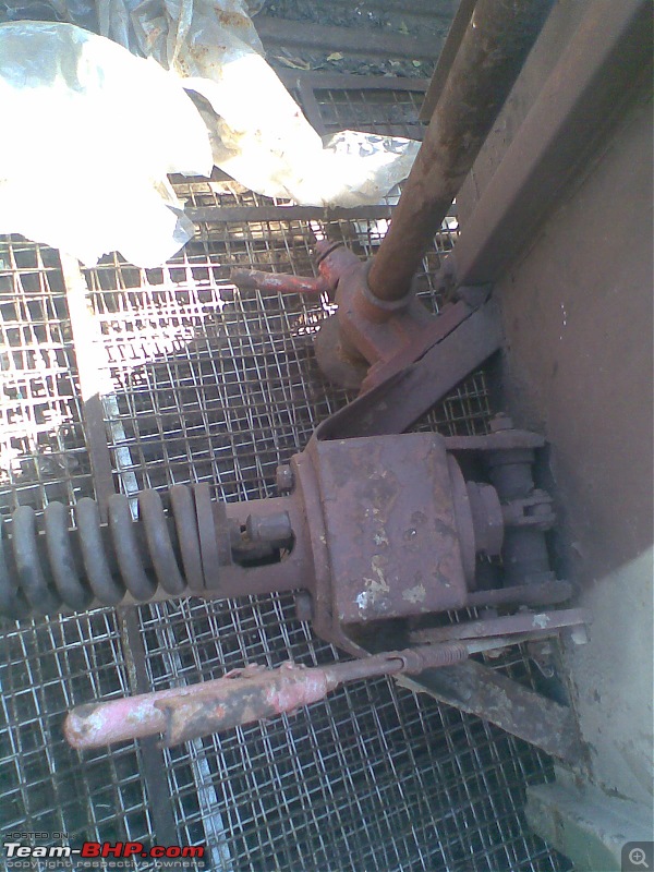

Finally I managed to acquire a Trailer for my Jeep. Had options to choose between Mahindra (Dunlop) trailer and Bantam trailer, since my Jeep is classic and opted the Mahindra Trailer.
Another reason to choose the trailer is that, this one comes with the break setup from tow bar. Whenever break applied to the Jeep the bar engages the breaks so the Trailer won't hit the Jeep damaging the chassis.
Here are the pics of my Trailer.

The difference between Bantam and Mahindra trailers are:
1. Mahindra Trailers are equipped with Break assy. with the hook bar and emergency breaks.
2. Mahindra Trailers got cross bar to manually pull the trailer, this could be folded down when towing
3. Mahindra Trailers are got smalls hooks inside and outer side of the body
4. Mahindra Trailers got tools box on the right side of the outer body wall
5. Mahindra Trailers got Quadrilateral shaped mudguards and box typed mudguards
1. Bantam Trailers got no break assy but equipped with emergency break
2. Bantam Trailers got round shaped mudguard
3. Bantam Trailers got wiring for rear taillamp which could be attached with the Jeep (advantage)
4. Bantam Trailers were easy operatable when taking reverse as there is no breaks attached in the tow bar, the Mahindra's normally hit the break and makes bit tough for reverse operations.
