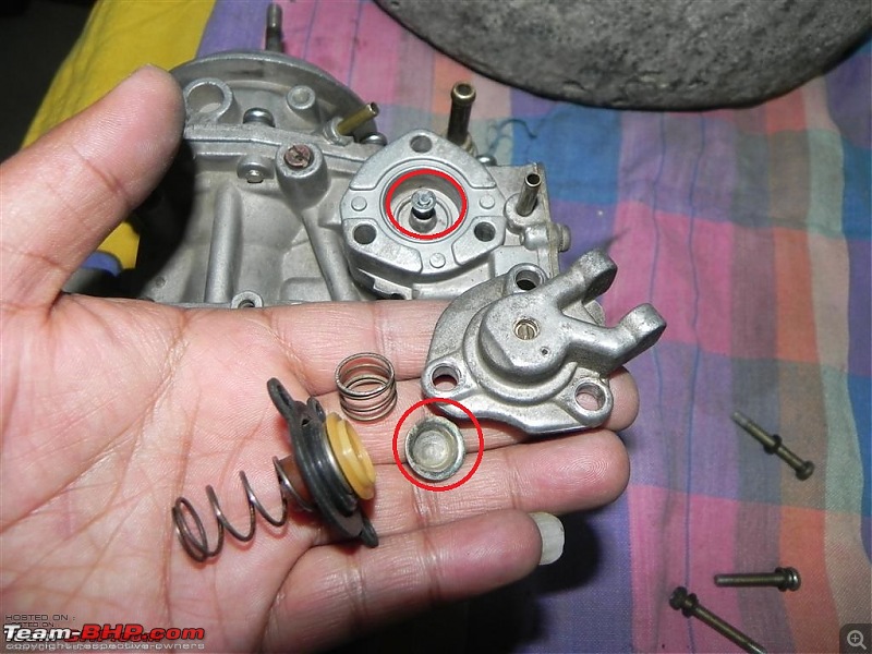

Hi,
I just opened up my 118NE Mikuni carburetor for a thorough cleaning. In a hurry I had not taken pictures of the power valve / enrichment valve diaphragm assembly. Neither able to find any info from the internet.
I am looking for 1 info.
1. In the attached picture, the first circled component. Does it have any spring like in a ball pen?
2. How is the metal cap circled below oriented. The convex side towards the diaphragm or the cover?
Thank you.
