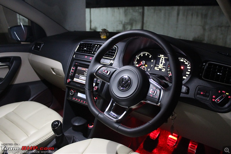

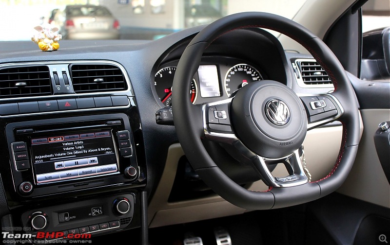

We swapped the stock MFSW (VAG speak for Multi-Function Steering Wheel) with a Mk7 unit last weekend when we did the cruise control installation (DIY link) and it was an easy affair.
VW Polo DIY: Mk7 Flat-bottom Steering wheel upgrade-img_1462.jpg
VW Polo DIY: Mk7 Flat-bottom Steering wheel upgrade-img_1468.jpg
Takes less than half an hour at best and is a plug-n-play swap. I’ve detailed the procedure below. If you wish to change the steering on your Polo (or another VW/Skoda car) look no further!

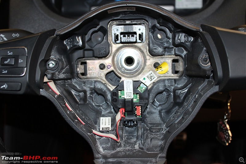

    I would also advise removing the airbag unit and the connectors beforehand. Insert a flat-blade screw driver in the slot and push the spring loaded clips as indicated below to detach the airbag:
    VW Polo DIY: Mk7 Flat-bottom Steering wheel upgrade-img_1329.png
    VW Polo DIY: Mk7 Flat-bottom Steering wheel upgrade-img_1332.png

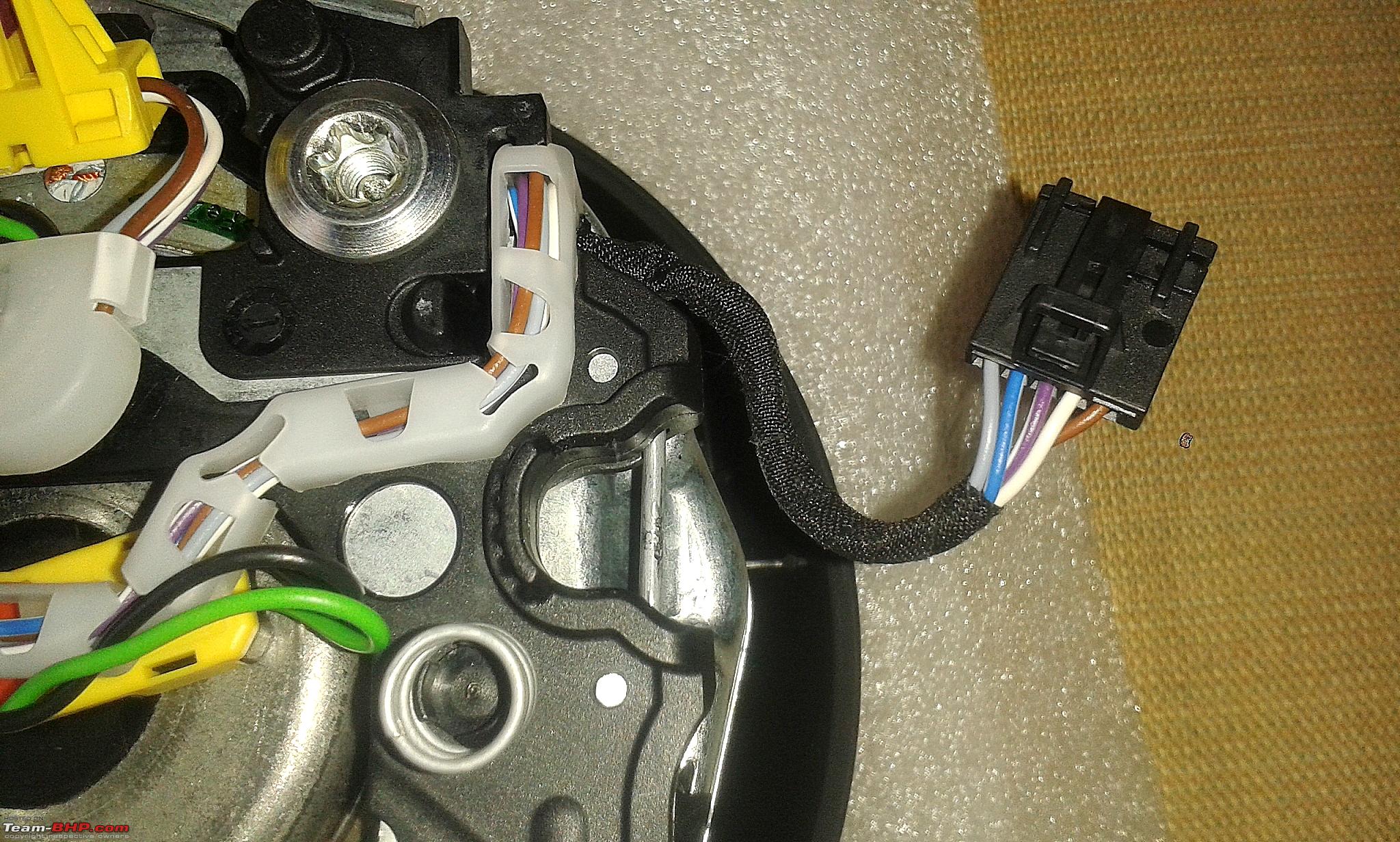

    Once the airbag is detached, undo the 2 connectors - one 5-pin black female connector for the controls and the yellow female connector for the slip-ring contacts:
    VW Polo DIY: Mk7 Flat-bottom Steering wheel upgrade-img_1343.jpg
    VW Polo DIY: Mk7 Flat-bottom Steering wheel upgrade-5pin.jpg

  11. Connect the black female 5-pin connector from the harness to the socket and the yellow female connector on the slip ring connector while holding the airbag unit.
    VW Polo DIY: Mk7 Flat-bottom Steering wheel upgrade-5-pin-connector.jpg
    VW Polo DIY: Mk7 Flat-bottom Steering wheel upgrade-img_1337.jpg
    Slide in the airbag unit (notice the AIRBAG logo alignment at the bottom of the horn pad) and lock the clips into their respective slots.

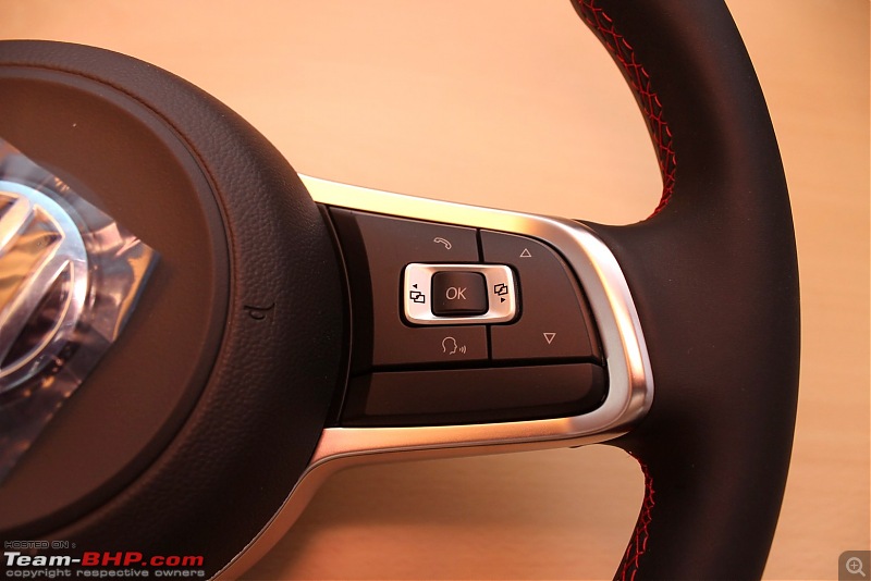

  13. Check the functioning of the media/phone/MFD controls, horn and the backlighting. Adapt the windows (roll up/down all the windows 2-3 times for the auto-up/down functions). Take a short test drive to eliminate the ABS/ESP errors. As the final step, plug the VCDS cable to the laptop installed with the software and do an Autoscan. Clear any errors and do a re-scan.

Results:
Enjoy the fruits of your labour!
