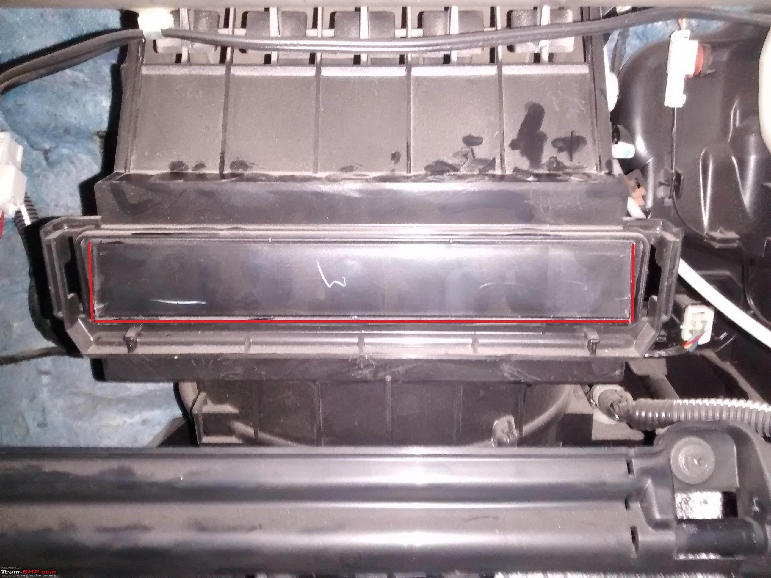

Once the glove box is out of the way, the box in question was sealed, so take the cutter and cut any 3 sides, I cut the bottom and the two sides.
DIY: Adding a Cabin Air Filter to the Honda Brio / Amaze / Mobilio-img_20151124_193604772.jpg

1. No modification was done whatsoever with the box, originally the air was passing through the box, all I did is add a layer of protection (read, the filter) in the path and the fact that it's got a provision for a filter makes it very easy.
2. The flap is quite rigid when you close it. I ran the blower after the installation and didn't notice any air leak. You don't need the sealing. Sealing will just make it difficult when you want to replace the filter.
