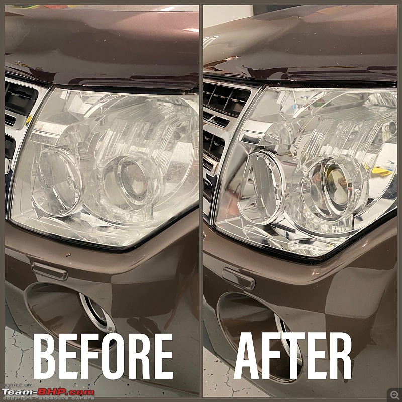

I did a headlight restoration on my Pajero, results as below:
DIY: Restoring the Headlights-fb24ee2d917945b09a999f9a6bd16013.jpeg
As the discolouration wasn’t extensive, the process was fairly straightforward.
