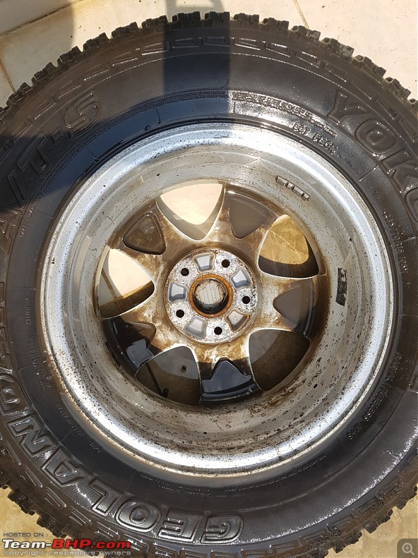

So after I had trudged those last 2 flights of stairs, I finally got down to cleaning. Boy let me tell you, it takes a lot to scrub off all the gunk thats been accumulated.
Here is an interesting picture. This vehicle was pressured washed and properly scrubbed One week ago.
Rust-Oleum Automotive Peel Coat : A Plasti Dip alternative for your wheels-wheel_in.jpg
