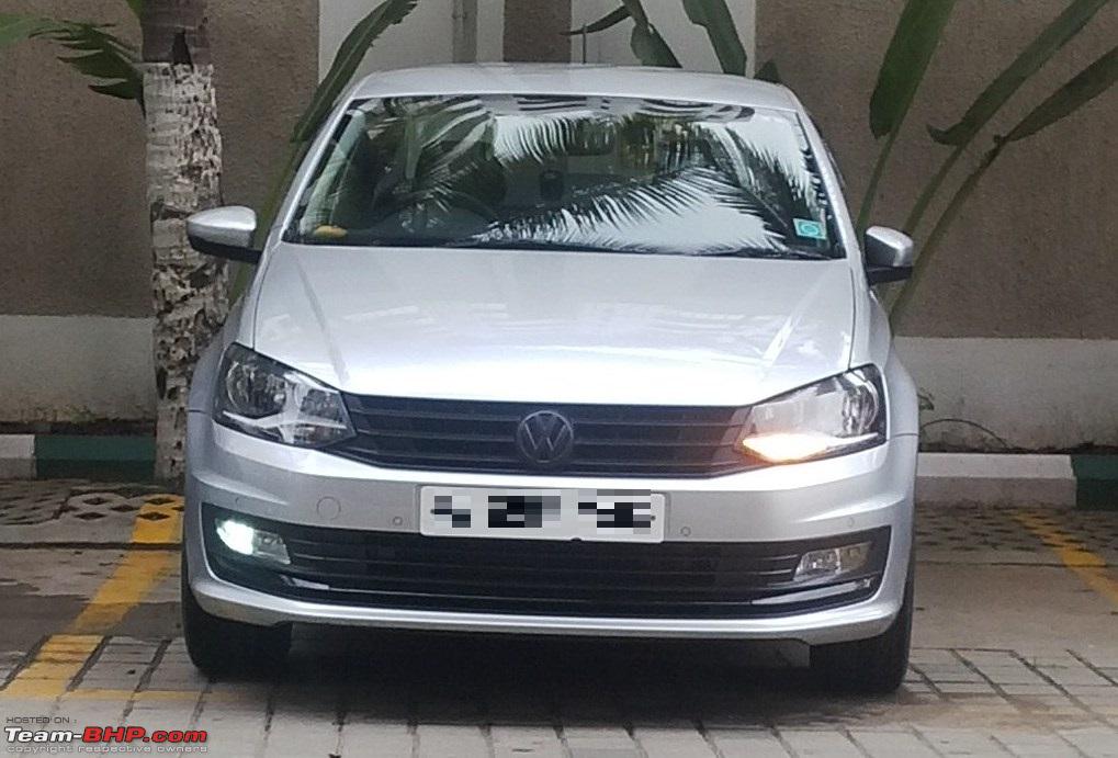

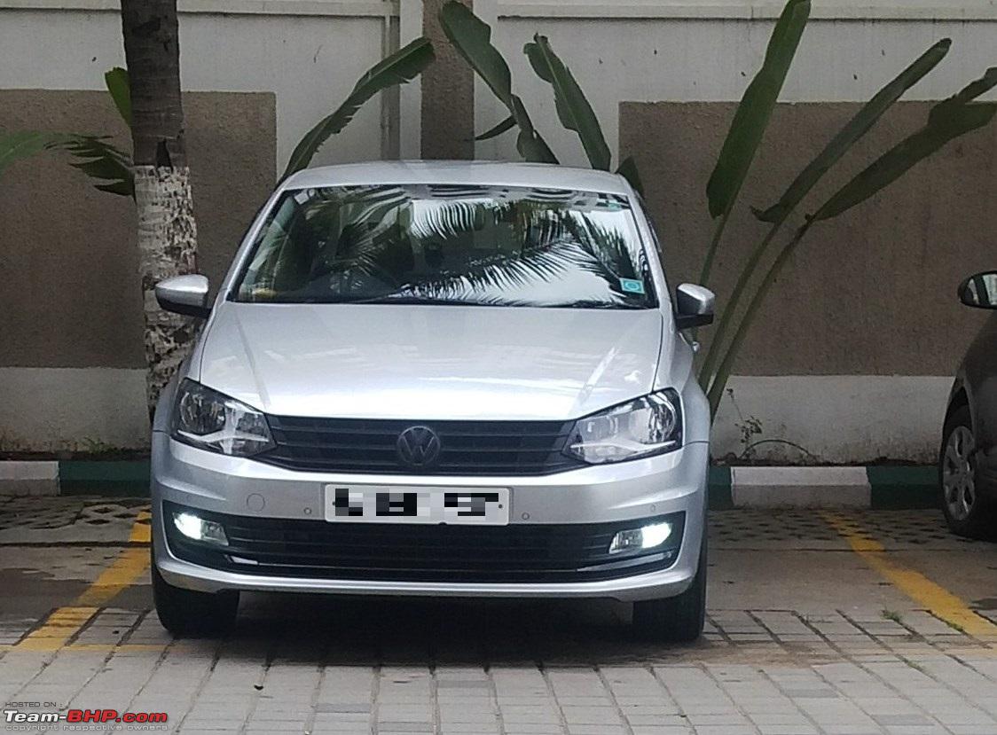

I managed to complete installation of BCM max and auto headlight wiring this week. Here are few pictures that I captured after completing this task.
Auto headlight switch with dimmer
Polo GT TSi Install: OEM Bi-Xenons with BCM Max Upgrade EDIT: 6C RLS + Auto-dimming IRVM installed!-autoheadlight-switch-dimmer-range-controller.jpg
DRL beside fog light (none OEM)
Polo GT TSi Install: OEM Bi-Xenons with BCM Max Upgrade EDIT: 6C RLS + Auto-dimming IRVM installed!-drl-beside-foglight.jpg
DRL off with blinker
Polo GT TSi Install: OEM Bi-Xenons with BCM Max Upgrade EDIT: 6C RLS + Auto-dimming IRVM installed!-drl-off-blinker.jpg
Auto dimming IRVM
Polo GT TSi Install: OEM Bi-Xenons with BCM Max Upgrade EDIT: 6C RLS + Auto-dimming IRVM installed!-irvm.jpg
Regards.
antardaksh is offline   (6) Thanks
