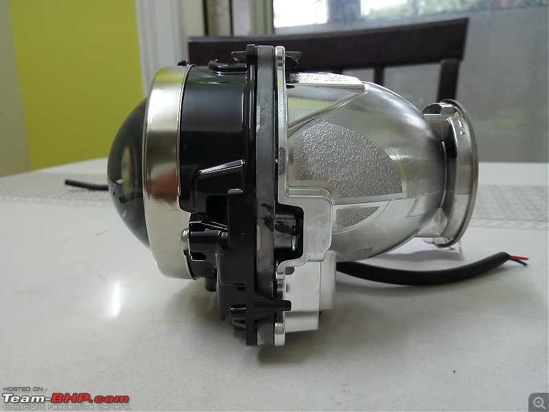

It's not the lens. It's the internal element. Here's a picture of the stock projector
DIY: S-Cross Headlight Upgrade to Morimoto Mini D2S Stage III Bi-Xenons-1.jpg
The middle piece has a rectangular shape to pass the light out. In the next picture which I captured from a video I took when dis-assembling the projector will show the rectangle where the blue arrow is. Sorry about the poor quality, but I hope you guys got the idea. The light that's coming out of that rectangular area is all that is really being projected
DIY: S-Cross Headlight Upgrade to Morimoto Mini D2S Stage III Bi-Xenons-scross-projector.jpg
And this - is the Morimoto! Nothing... the reflector is projecting everything straight onto the lens!
Great insight boss! This means that upgrading to 35W bulb will help but it again would be restricted by same design and actual gains would be far less than what is expected after spending $$$
