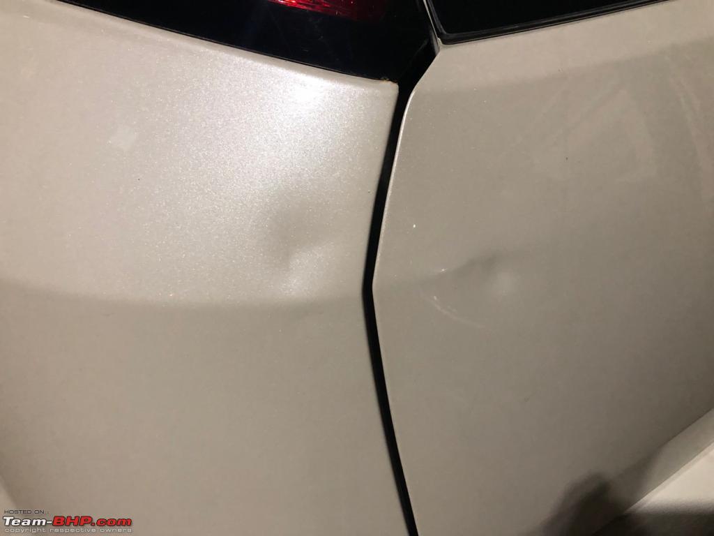

Another paintless repair DIY, reversed into another cars open rear door. It was completely my mistake as i had parked the other car too. After parking i got into my car to reverse and didn't realise that someone had opened the rear door of other car. There was very little gap between my car and wall on the driver side so i was concentrating on that and bam. The car i hit was facing the other side and its rear door edge hit my cars rear quarter panel and the hatch door. There was dent but no scratch and luckily no damage to the other car.
Here how it looked after the hit

I called couple of paintless dent repair shops but nobody was interested in such small work.
Then thought of trying the DIY, removed the hatch door pad and both dents were accessible but the quarter panel was really difficult to access as it was curved and the access was really small and panel had really sharp edges.
Tried pulling it out with the dent repair took, it did 40-50% of work.
Dent repair tool.
DIY: Paintless dent removal via the Glue gun method-whatsapp-image-20200130-14.22.09.jpeg

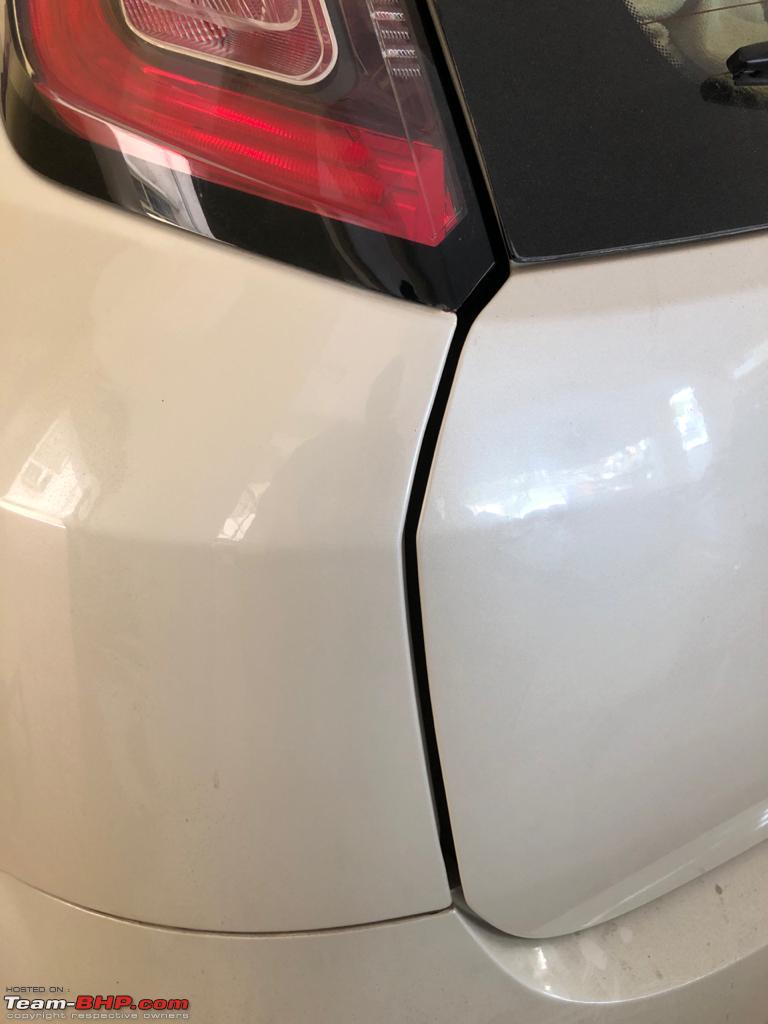

Then by using the handle of the rubber mallet, pushed the dent back in shape, like using a lever. It was really difficult but managed to fix most of it. Lots of bruises and cuts in hand, tried using a glove but due to very small space, couldn't grip the wooden handle properly.
The rear hatch dent was relatively easy one but i foolishly tried using metal tool and it left sharp marks. I removed most of those by hitting slowly with rubber mallet and keeping a wooden block behind. It looks much better now.
After all the work done, but i have to admit that you can see still see the dent and undulations in person. Camera image it looks much much better.
DIY: Paintless dent removal via the Glue gun method-whatsapp-image-20200130-14.21.07-1.jpeg
DIY: Paintless dent removal via the Glue gun method-whatsapp-image-20200130-14.21.07-2.jpeg

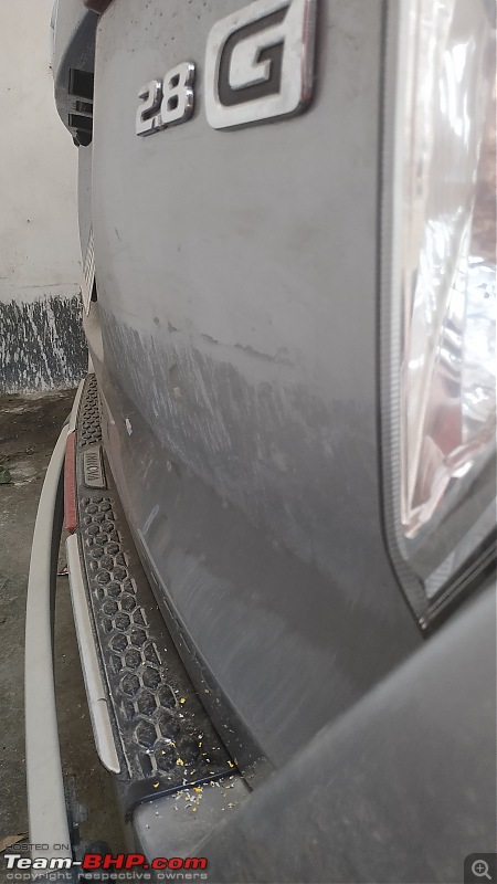

Sometime back I got two dents on various occasions on the boot lid of my Crysta. One of them was incidentally right on the TBHP LTD sticker, not sure what I hit there but may have been also caused by someone at any hotel or car wash having unnecessarily pressed there with all might while pulling down the lid.
Nevertheless TKM Service Center quoted me 11K if I go without insurance and I decided to go for the NCB as only few days were left for renewal.
I decided to give a mass market dent puller kit a try, there were plenty on amazon and I selected this one
The two dents
DIY: Paintless dent removal via the Glue gun method-img_20210526_174157.jpg
DIY: Paintless dent removal via the Glue gun method-img_20210526_174210.jpg

Suddenly the Mentos Moment happened. I took a hand sanitizer and soaked a few sprays on a piece of cotton and slowly started applying it on all sides, especially around the northern tip of the glued area. I may have just applied for maximum 10-15 seconds and with the subsequent peeling attempt the glue and the pad completely came off. Absolutely no damages to the underlying paint. I did gently rubbed the residual sanitizer dry from the applied area.
The traction pad stuck with glue on the bigger dent, note I had to take off the LTD sticker
DIY: Paintless dent removal via the Glue gun method-img_20210529_121732.jpg
The final state of the bigger dent, as good as new
DIY: Paintless dent removal via the Glue gun method-img_20210529_123412.jpg
The final state of the smaller dent, did not improve much, I let it stay and never bothered again
DIY: Paintless dent removal via the Glue gun method-img_20210529_132705.jpg

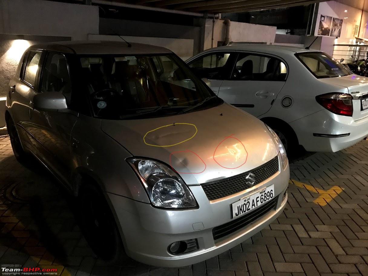

My Swift had a major bonnet damage after a tree branch fell on it during a storm while we were vacationing in Wayanad. At first sight, the damage was immense & bonnet was literally bent from center & lifted upwards towards the front.
Being a Maruti has its benefits at such occasions, I just opened the bonnet & slammed it from inside till it came back to shape, well almost! Took me some 15mins for the job and never bothered to repair it again as I was anyway planning to sell the car.
Below picture will give you an idea, the yellow marker highlights the point of impact and red ones were the other remaining dents. This is more pronounced in this night picture, but you could easily miss these during the day as is evident in the second picture.
DIY: Paintless dent removal via the Glue gun method-inkedimg_8071_li.jpg
DIY: Paintless dent removal via the Glue gun method-img_8778.jpg
