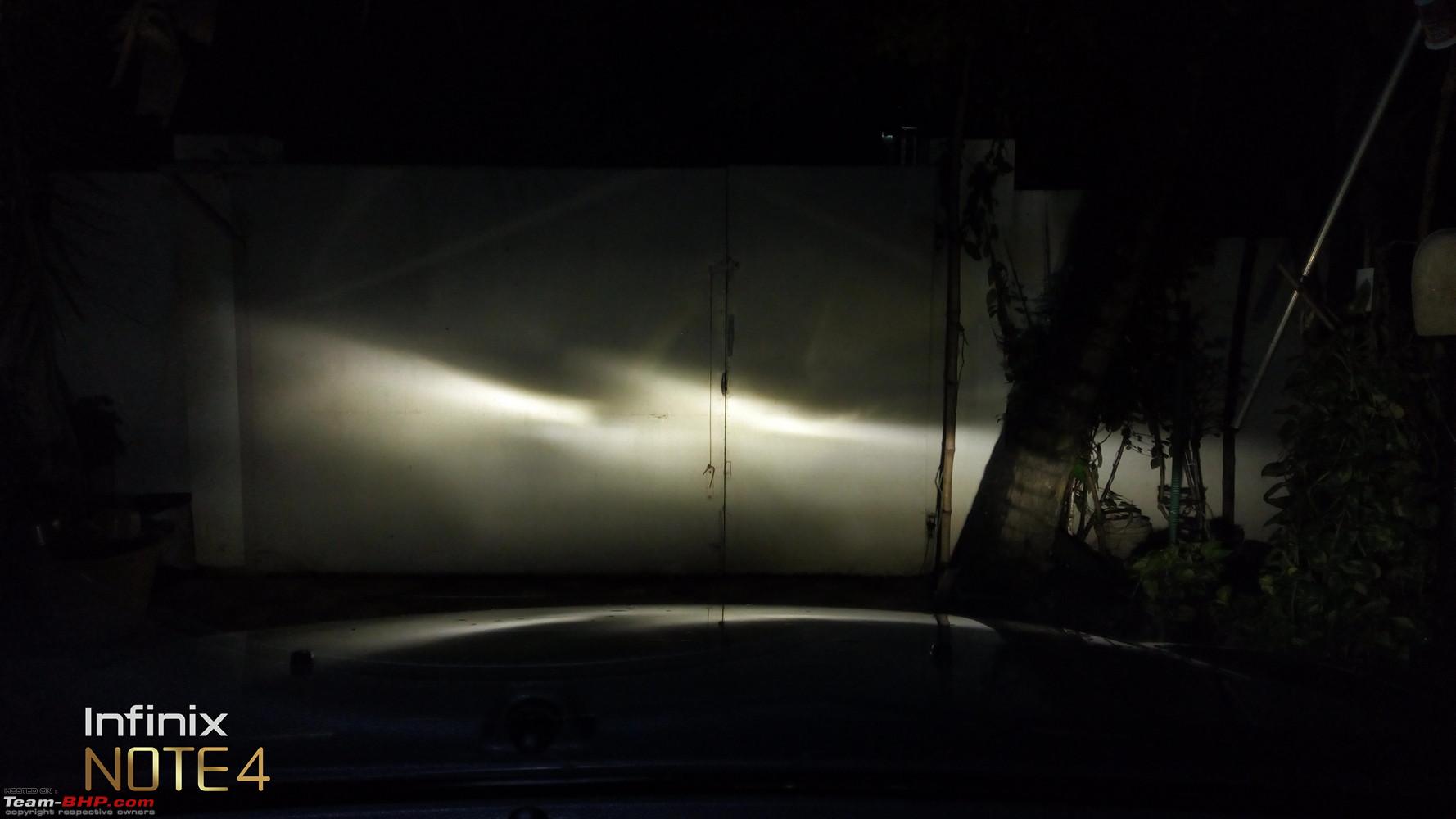

The next type of lamps are very common nowadays. These are 6000K CSP LED bulbs. I got these from AliExpress from a company called OSLAMP. They are very good, but tend to burn out if you keep the headlamp's dust cover on, as there is no cooling fan and only a heat sink. I have already uploaded pictures of these in previous posts. Build quality is very good. This would also be good for projector setups, as they mimic halogen filament placement closely.
DIY: Ford EcoSport LED Headlights upgrade-2f8017dc18ccf195fb2fcef0d4cee3ed.jpg
Here's the beam pattern. These have a very good low beam and high beam pattern. But in some conditions, the white light gets scattered and the range is affected.
DIY: Ford EcoSport LED Headlights upgrade-ecosport_vivekgk_007oslamp25w5500klb.jpgDIY: Ford EcoSport LED Headlights upgrade-ecosport_vivekgk_008oslamp25w5500khb.jpg
You can see that the beam pattern closely matches that of the halogens, and the brightness is much more. I've been using these for more than a year now. One bulb burnt out because of overheating, but I ordered another set immediately.

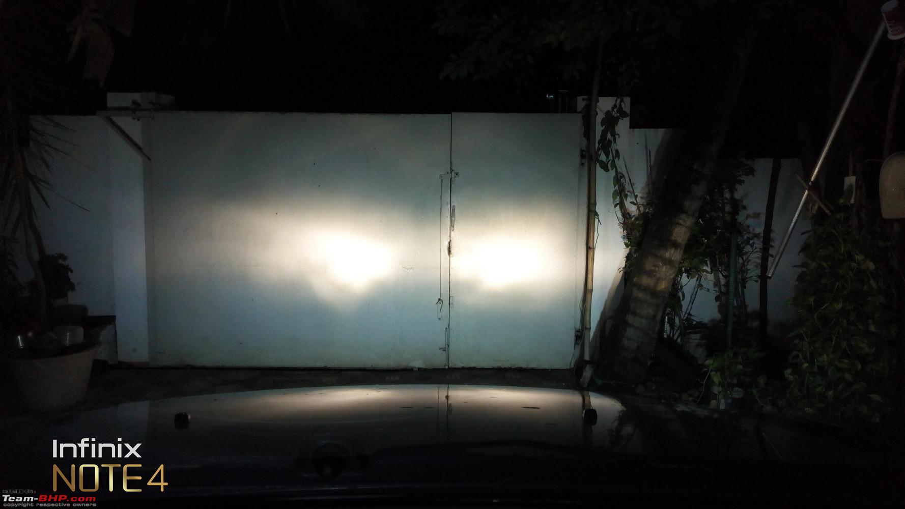

Finally, I have the new 4300K HLXG LEDs that I just got last week. These are supposed to be the best of both worlds, as you get the correct color for longer range and for rain/fog performance, as well as the increased brightness and instant startup of LEDs.
DIY: Ford EcoSport LED Headlights upgrade-ecosport_vivekgk_013hlxg4300kled.jpgDIY: Ford EcoSport LED Headlights upgrade-ecosport_vivekgk_014hlxg4300kled.jpg

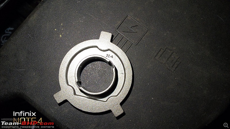

DIY: Ford EcoSport LED Headlights upgrade-ecosport_vivekgk_017hlxg4300kledclamp.jpg
This is the clamp for attaching the bulb to the standard H4 reflector holder. Note the asymmetrical guides to ensure the bulb is installed correctly.
DIY: Ford EcoSport LED Headlights upgrade-ecosport_vivekgk_018hlxg4300kled1.jpgDIY: Ford EcoSport LED Headlights upgrade-ecosport_vivekgk_019hlxg4300kled2.jpg
This is what it looks like, fitted inside the reflector. Note that the bulb is angled to the driver side.
DIY: Ford EcoSport LED Headlights upgrade-ecosport_vivekgk_020hlxg4300kledlb.jpgDIY: Ford EcoSport LED Headlights upgrade-ecosport_vivekgk_021hlxg4300kledhb.jpg

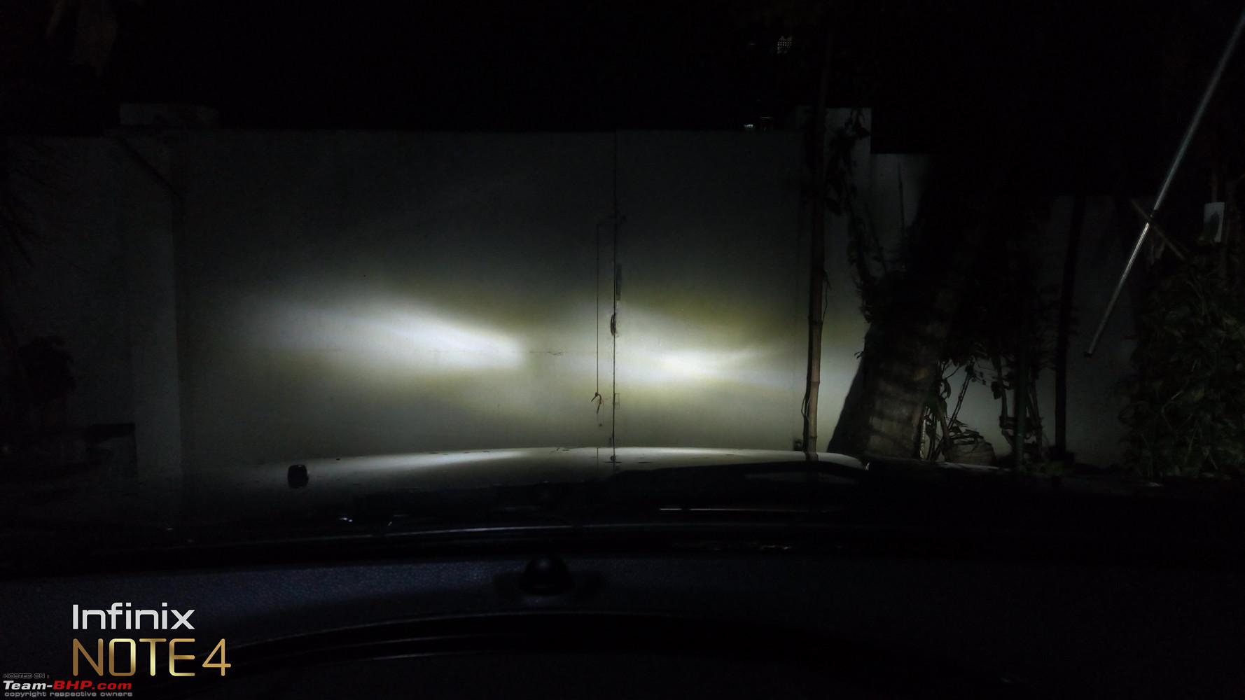

With the LED fog lamps on:
DIY: Ford EcoSport LED Headlights upgrade-ecosport_vivekgk_022hlxg4300kledlbfogs.jpgDIY: Ford EcoSport LED Headlights upgrade-ecosport_vivekgk_023hlxg4300kledhbfogs.jpg
With only the fog lamps on:

Originally Posted by Vid6639 (Post 4366217)
Experiment #2 Xenon Depot Xtreme LED PRO:
After the failed attempt, I did not give up but decided to go deeper into the LED deisgn. Just the light source matching between LED and Halogen was not enough. I had to look at the LED construction as well. Discrete vs Array. Domed LED's were not preferred. You can clearly see the difference in the below 2 images of the CREE array LED and the CSP LED. The CREE XHP50 Hikari LED's have the right design in terms of light source location vs the halogen but the light source itself is quite different. It's more round vs the straight 3 in a line CSP LED that exactly matches the halogen bulb source. Also, instead of fan which can go bad being active I looked at heat sink models with fins for cooling.
