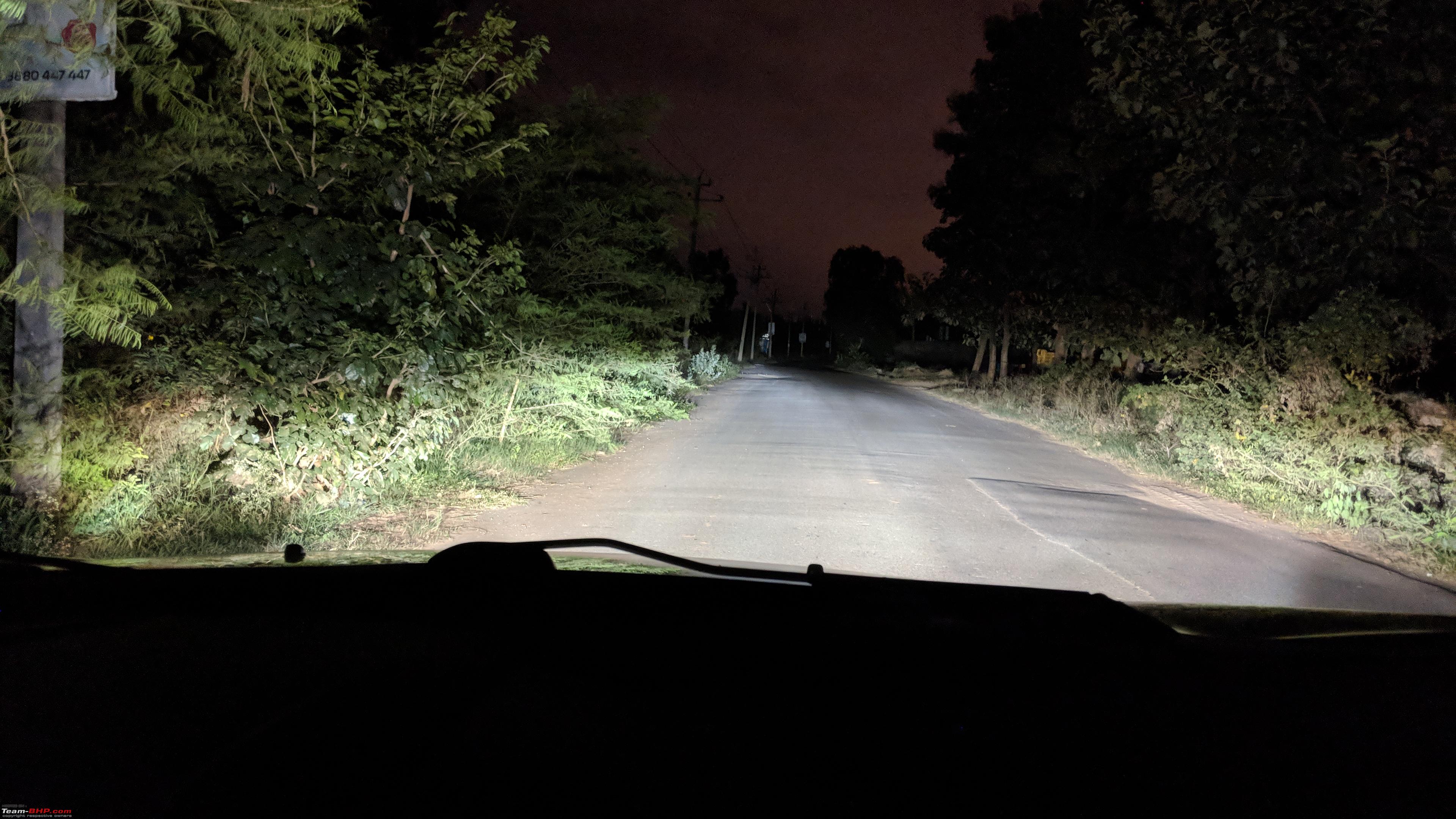

I had ordered the iphcar/sinolyn H11 projector fog lights from Aliexpress. These are the same ones that Xenon planet and blaze india sells.
Wasn't getting time to fit these in till last week. Tried to fit the projectors and the mounting holes do not align with the OE ones. Had to trim the plastic around to get the larger projectors to fit but the mounting holes just wouldn't match. Found another BHPian's Ecosport who had it fitted from Evo. It was fixed using M-seal which meant would be a pain to remove and looked like the OEM fogs can never be fitted back if these projectors went bad. Looking at the quality they won't last too long for sure.
Thankfully BHPian Libranof1987 sent pics of his install and it was quite obvious. All 4 mounting holes don't align but 2 will, so you if you bend the bracket you can get 2 screws to align well. Even the stock fogs only have 2 screws with other 2 as guide points. Now I need to figure this bit out.
But what I did temporarily was fit the HID bulbs in the stock fog lights. The result was scarily good. Yes it will not be comfortable for oncoming traffic but it wasn't that bad.
Here are some pics:
Low Beam LED lights:
DIY: Ford EcoSport LED Headlights upgrade-img_20180907_193158.jpg
Only fog lights. Not even low beam is on:
DIY: Ford EcoSport LED Headlights upgrade-img_20180907_193146.jpg
Low beam LED+Fog lights:
DIY: Ford EcoSport LED Headlights upgrade-img_20180907_193151.jpg
Low Beam+High Beam+Fogs:
DIY: Ford EcoSport LED Headlights upgrade-img_20180907_193211.jpg
The fog lights are Xenon Depot H11 HID 4300K. https://www.xenondepot.com/H11-HID-K...1.htm?CartID=1
The LED headlights are Xenon Depot LED H4 5500K. Details on Page 1.
The fog lights are fitted in the stock Valeo foglamp unit and they whoop the headlights in illumination!
However the LED headlights are still better than stock but thanks to the seriously crappy reflector design, the output is just no match. When I got some more time, I will give the projectors a second try to fit them but now I am in no hurry.
In conclusion, For the Ford ecosport - Don't bother with LED headlights. Get some upgraded bulbs like Philips Xtreme Vision or Osram Nightbreaker.
Put 3000-4300K HID in stock foglights or if you feel guilty for oncoming traffic, get the 2.5inch projectors from Aliexpress (not 3inches as these are bigger than stock).
https://www.aliexpress.com/item/Free...5c142e0eeGxiJx
I got the HID kit from USA but you can also try the Osram one from Amazon: https://www.amazon.in/Osram-Xenon-42...rds=osram+dh11

Are these stock Fog lamps with HID? This output is amazing and I think it will be a killer reply to those insane people with lights flashing all over from their vehicles.
Yeah these are the stock fog lamps. All I did was replace the bulbs with 35w 4300k hid bulbs. Plug and play no wiring change. Just needed place to secure the ballast which was also easy. Both sides took around 20 mins to install. 5 mins for bulb change. 15 mins to cable tie the ballast in engine bay.
