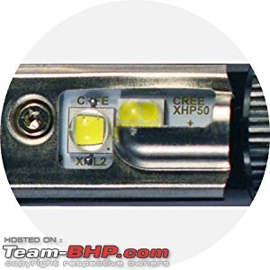

A close look at the LED light source themselves. The low beam is a CREE XHP50 2x2 array:
DIY: Ford EcoSport LED Headlights upgrade-img_20180305_093846.jpg
High beam is a CREE XML2:
DIY: Ford EcoSport LED Headlights upgrade-img_20180305_093857.jpg

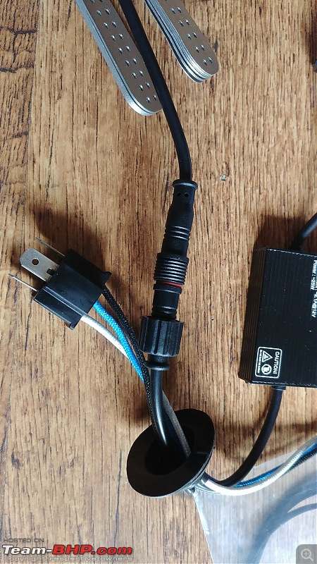

The entire kit comes with the H4 wiring harness, LED driver, grommet for sealing the dust cap and zip ties:
DIY: Ford EcoSport LED Headlights upgrade-20180113_143946.jpg
This is the connector that connects the LED bulb to the driver circuit:
DIY: Ford EcoSport LED Headlights upgrade-20180113_144019.jpg
Entire bulb wired up. Everything left of the grommet goes inside the headlight housing and on the right you need to zip tie them on to something:

Good to know that the LEDs you've bought fit well in the low-beam housing, that was one of my concerns while considering the Ultinon LEDs.

The Lasfit LED's were on my mind as well but for H4 the design was totally off compared to halogens.
Also, I just saw the beam pattern on your thread. The light output has gone up significantly but as you can see the cut off isn't sharp at all vs the Osram night breaker halogen. Infact the entire beam has gone up which is way too high. In the photo against the wall, the NBU has a sharp cut off just below the height of the wall but the LED is way too high. This means total glare to oncoming and worse is it has more foreground light which means your eyes will not adjust to night time driving effectively.
It has a good hotspot but outside the hotspot the drop in light is too much which is again not what is desired.
In my case the LED bulbs were truly Plug and Play in terms of the H11 socket type. Although the LED Drivers do not have a proper housing. I will possibly use Insulation tape and make them stick to a convenient part in the space available.
The H11 or H4 wiring is truly plug n play even in mine. But as you can see the Lasfit has a huge cooling fan. How exactly did that cooling fan get accommodated through the retainer pin and what about the dust cap and wiring?
