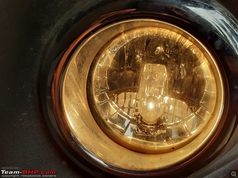

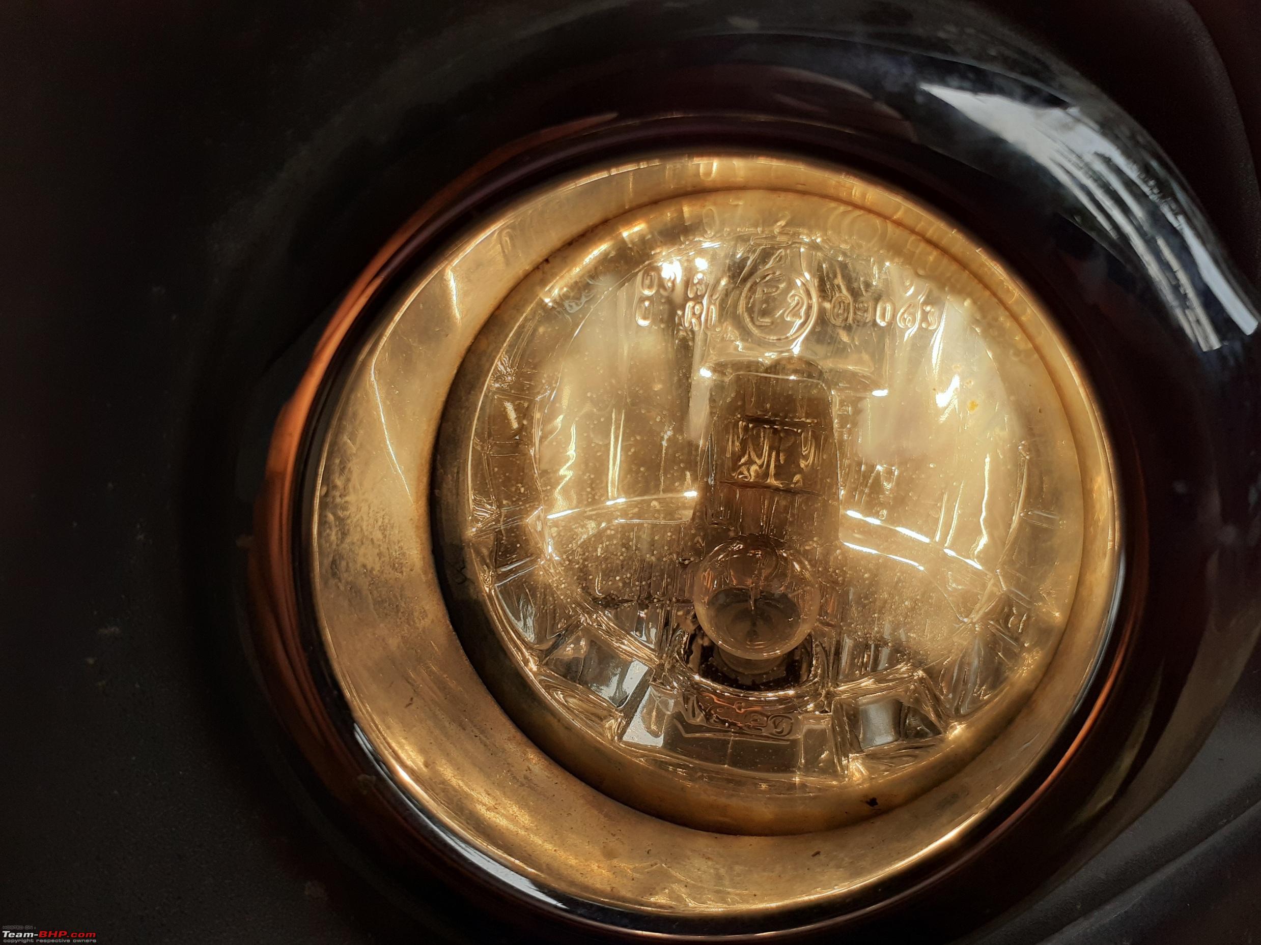

I had ordered the iphcar/sinolyn H11 projector fog lights from Aliexpress. These are the same ones that Xenon planet and blaze india sells.
In conclusion, For the Ford ecosport - Don't bother with LED headlights. Get some upgraded bulbs like Philips Xtreme Vision or Osram Nightbreaker.
Put 3000-4300K HID in stock foglights or if you feel guilty for oncoming traffic, get the 2.5inch projectors from Aliexpress (not 3inches as these are bigger than stock).
We have a 2016 Ecosport Titanium + TDCi in our garage, it has done around 70k km. One of the biggest issue for me has been the light output, which in one word is hopeless. At around the 25-26k km mark, I tried 100/90 watt bulbs with a relay kit. The improvement in lighting was decent & enough for me. Though as the car approached the 55k km mark, I noticed that the reflectors were getting faded (I guess due to excessive heat). So, I removed the 100/90 watt bulbs & went back to the OE 60/55 watt bulbs.
Now I want to give projector fog lights a try & hopefully sort out the lighting issue once & for all. From your post it seems Ecosport is a bit complicated to work on, like most Fords. I want to go the projector way & not the HID in stock fog light way. What would you suggest? What size projector would fit in the Ecosport? I don't mind getting rid of the chrome cover if needed. I checked both the fog lights of the Ecosport & the Swift, to me they looked to be of similar size, the Swift has a 3" fog light.
The next issue is the wiring. Can I run the HIDs with the stock fog light wiring? In the 2015 facelift, Ford introduced these stupid DRLs in the top end Titanium + variant. The DRLs are housed inside the fog lights & are yellow in color . On close inspection, I could see that there are two bulbs inside the fog light housing. I don't mind losing the DRLs, just that fog lights shouldn't be on all the time. Thank you in advance.
DRL on:
DIY: Ford EcoSport LED Headlights upgrade-drls-.jpg
Fog light on:
DIY: Ford EcoSport LED Headlights upgrade-fog-1.jpg
DIY: Ford EcoSport LED Headlights upgrade-fog-2.jpg
