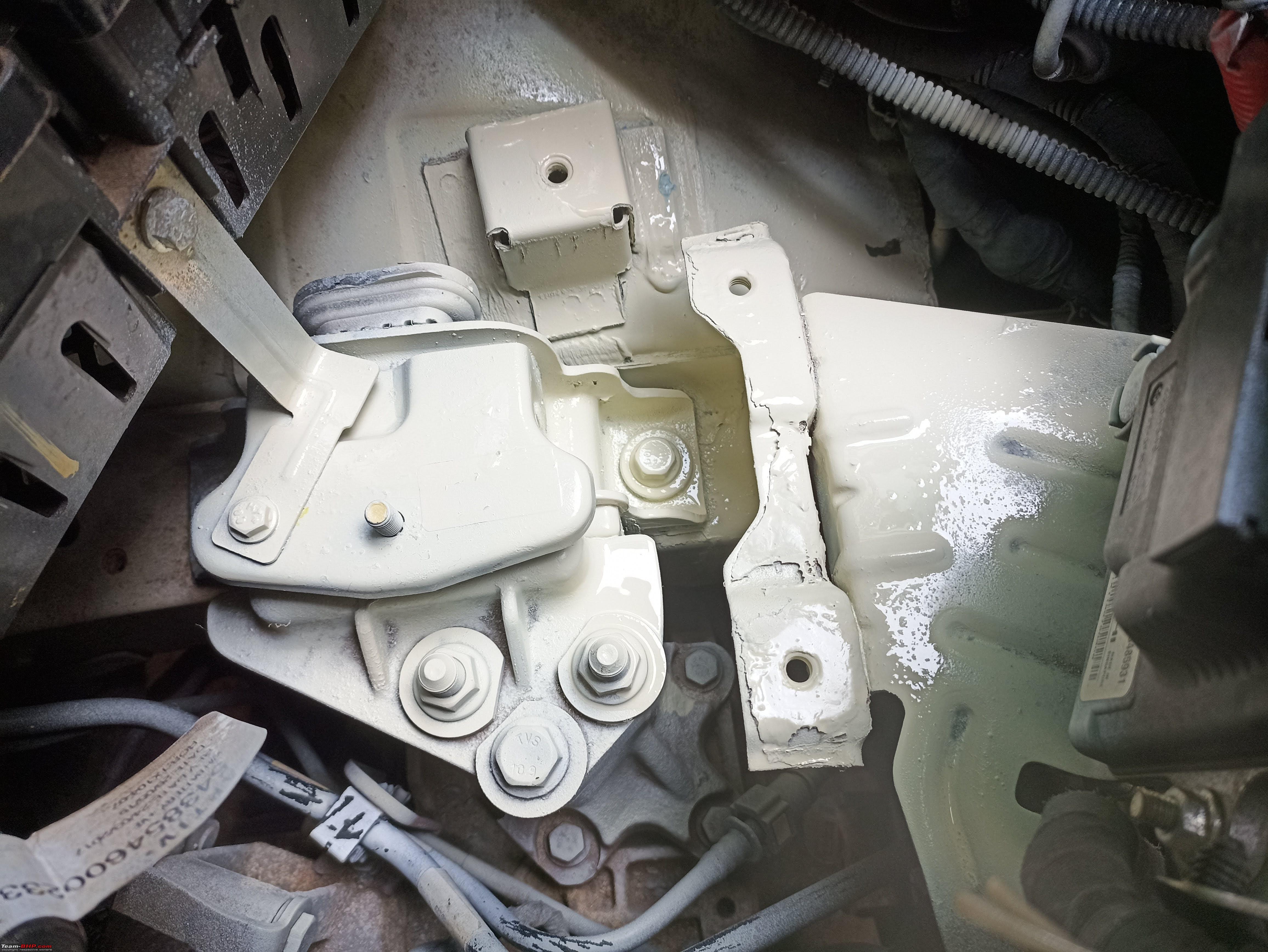

Which rust converter do you use? I too have my battery tray rusted. Any suggestions team?
And what shall i do of engine mounts.?
iampulo is offline   (1) Thanks

Patiently did this over 3 days. Polished away all the grime and rust using wire-polish tool with 3 coats of lacquer and 2 coats of clear top coat. Its been holding up pretty well since.
Some images attached. The tray costs not much to replace. I don't think i may have saved much by renewing the existing one. But then its not money savings that we salvagers/DIYers look for, is it?
Its a rather common issue in most budget cars. I'm surprised the car-makers have not found a fool-proof way around it with correct materials of the tray and precise drain ducts to avoid spills anywhere on the vital parts like mounts / chassis underneath the tray. The battery acid is very corrosive and aggressively eats through any metal it contacts.
