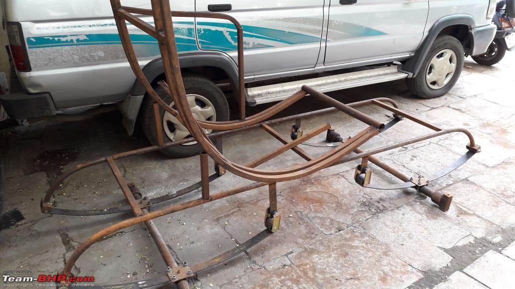

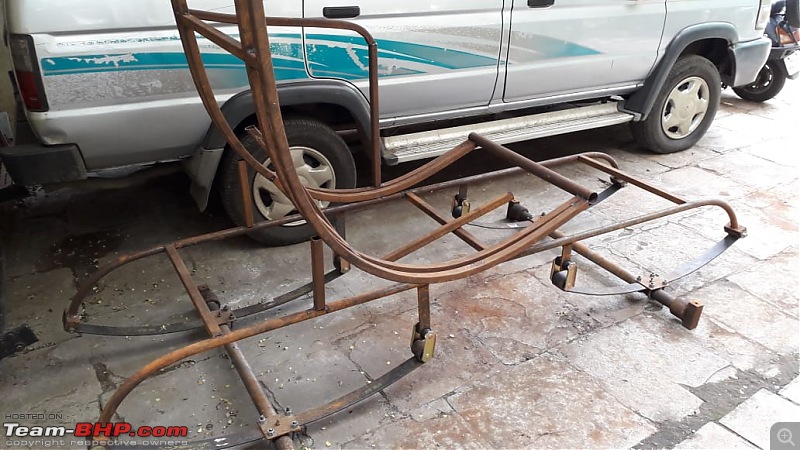

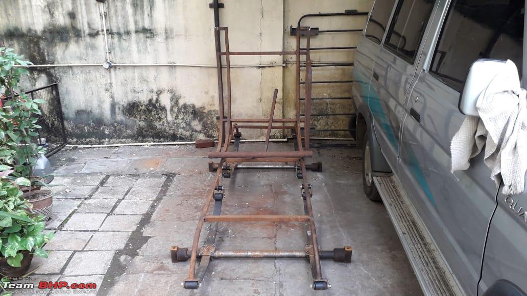

Bare bones "chassis" taking shape
Wheels attached

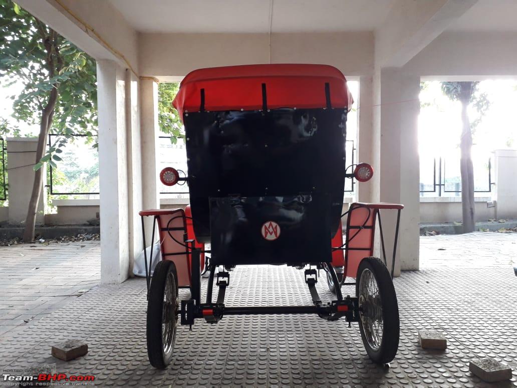

Back view

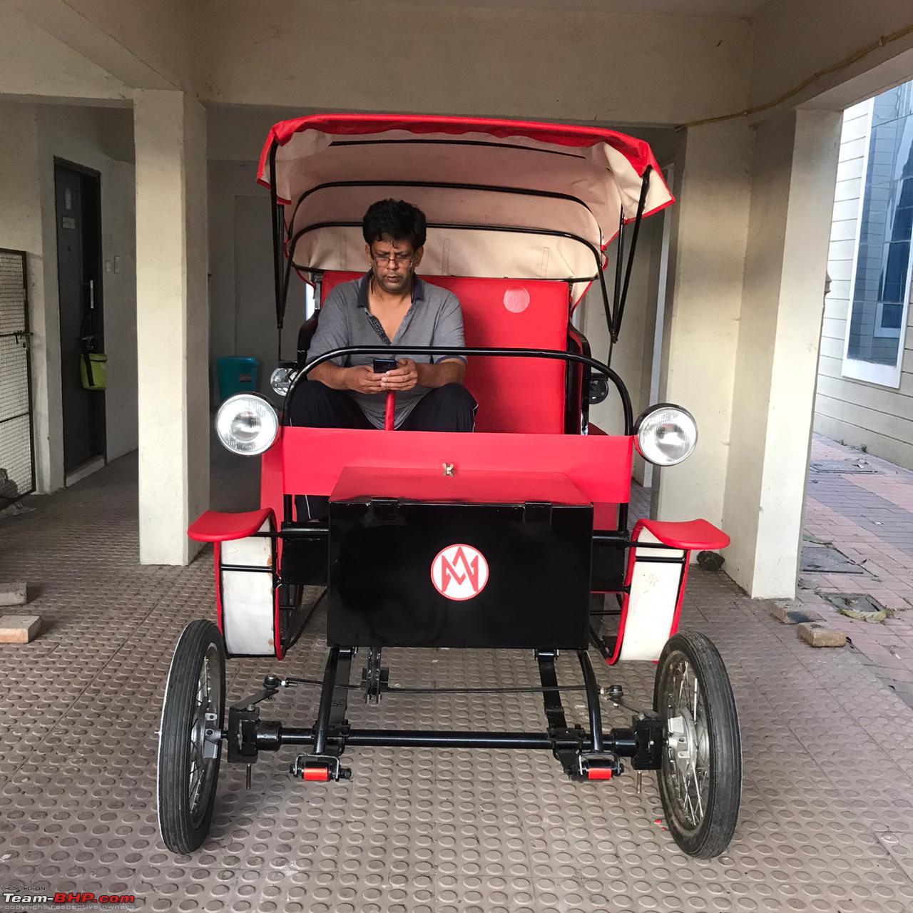

Lo Behold!
My hand made "convertible"!
She is an EV, running on 48 V, 900W electric motor. Perfect for visits to your local tobacconist or milkman.

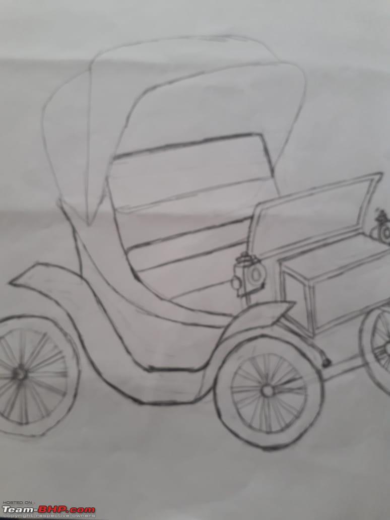

We (me and my wife) started off with what kind of car. We wanted something which would be different as well as fun. After numerous rounds of discussions, she came up with the sketch. This is literally our proverbial "drawing board"
