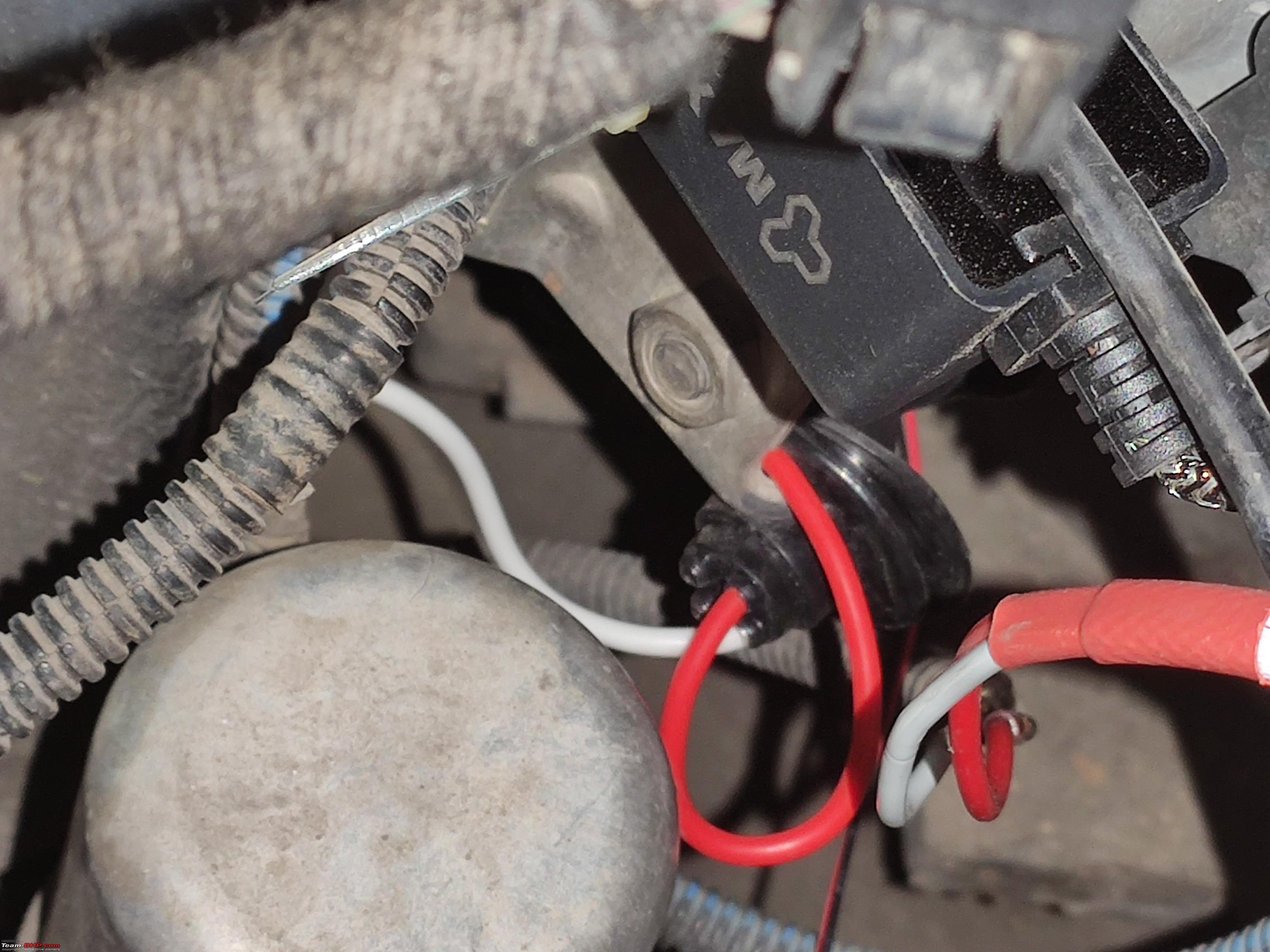

Currently having a real hard time lowering right side low beam. Metal bracket of horn is obstructing any more movement of hid bulb ends.

Oops you might've misunderstood me. I'm running AES projectors which have a different bracket compared to iph ones. Adjusting the beam does require removing entire projector, loosening 2 screws and swivel projector up and down in its bracket.
The rear end of HiD bulb was fouling with horn bracket, preventing anymore movement, I simply bent the horn bracket away with my hands.
Another problem I faced was horn assembly touching projector which changed its sound, pulling the horn upwards solved it all.
