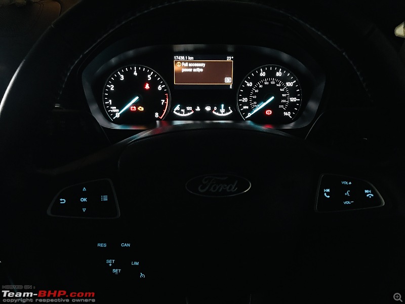

All thanks to Naveen and his post on TeamBHP forum that I got to know such a fantastic way to swap my instrument cluster with his kind help!
Few days back with the help of a fellow member (Raghunathan TE) of Facebook group EcoSquads of which even I'm a active member of got the instrument cluster procured from eBay UK website and approached Naveen Kumar for the important and entire process of programming and installation!
A humble and kind helping nature of his was something impeccable!!
The odometer reading was just about 153kms when installing the newly procured cluster which means it was hardly used and it's April 2019 manufactured ST Line variant (international top end variant of EcoSport) cluster so completely satisfied!!
All the icons along with Cruise control and traction control icons work very well as NAVEEN had installed the same firmware which was running on my stock instrument cluster! But the new one lacks the icons for fuel filter and engine glow plug!!
And I can now get info about the calls on the odometer itself along with changing and selecting the audio source same as titanium s cluster does!!
Completely contented with the upgrade and a investment worth every penny!
Benefits of Upgrade:
-Call functionality via instrument cluster where in you can access your incoming outgoing and missed calls!!
-Displays bigger kmph (in my view tab)
-Browse and select audio source and select and view song playing
-Just imagine if you had a mobile connected via Bluetooth and you receive a call while backing up the car the sync 3 screen will be displaying the rear camera and hence you would not be able to know who is calling but not any more as the caller info displays on the instrument cluster itself!!
-And also compass is displayed on instrument cluster in short-form (In the right hand bottom corner)
The instrument also supports lane departure warning etc and also has engine auto off while waiting on traffic signals icon but those features are not available in India!
All thanks to TeamBHP and EcoSquads for the entire process of upgradation and a special thanks to Naveen for posting the entire process and for helping me personally to get it installed..!
