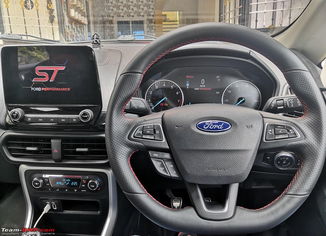

This post is about adding the features mentioned below

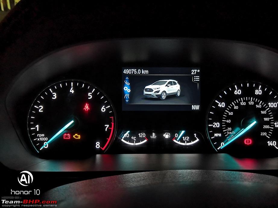

1. TFT 4-inch display instrument cluster (Most anticipated DIY among Ecosport 2016-2019 owners).
2. Housing Assembly - Steering Column with indicator switch on left and wiper switch on right (Like old Ford cars).
3. New sports multifunction steering wheel with cruise control switch.
4. Sports Ford performance themes for Sync 3 and instrument cluster.

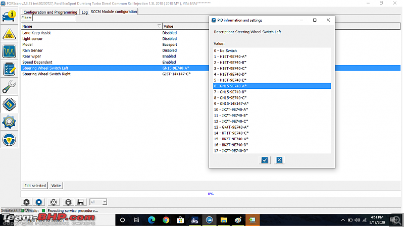

Select IPC Module Configuration (As Built Format) and then click play button on the bottom left side.
Note: If you notice there are two IPCs
1) Module Configuration (As Built Format)
2) Module Configuration.
The differences are the As Built is Hexadecimal based configuration, the other one is a simple direct configuration enable/disable option where the Forscan will convert the selected option to hexadecimal.

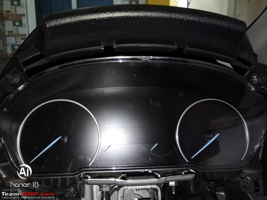

Installing New instrument cluster MID.
The main reason to do this upgrade is that though car looked bigger and the interiors looked premium, the instrument panel was looking outdated and its look didn’t give a motivation to drive the car. This was the standard instrument cluster on all EcoSports until 2019. Later, Ford started to provide a 4-inch instrument cluster which looked great.
First thing - the cluster panel has to be removed.
DIY: Upgrading the Indian EcoSport Titanium to the Global ST-Line Variant-10.png
The panel can be pulled out gently using your hands.
DIY: Upgrading the Indian EcoSport Titanium to the Global ST-Line Variant-11.png
The panel has been removed and the four small bolts have to be removed.
DIY: Upgrading the Indian EcoSport Titanium to the Global ST-Line Variant-12.png
Once the cluster blots are removed, the cluster can be easily pulled out and then the cluster connector should be disconnected.
DIY: Upgrading the Indian EcoSport Titanium to the Global ST-Line Variant-13.jpg
Once the old cluster is removed. The new cluster can be connected in the same way as it was before being removed.
DIY: Upgrading the Indian EcoSport Titanium to the Global ST-Line Variant-14.jpg

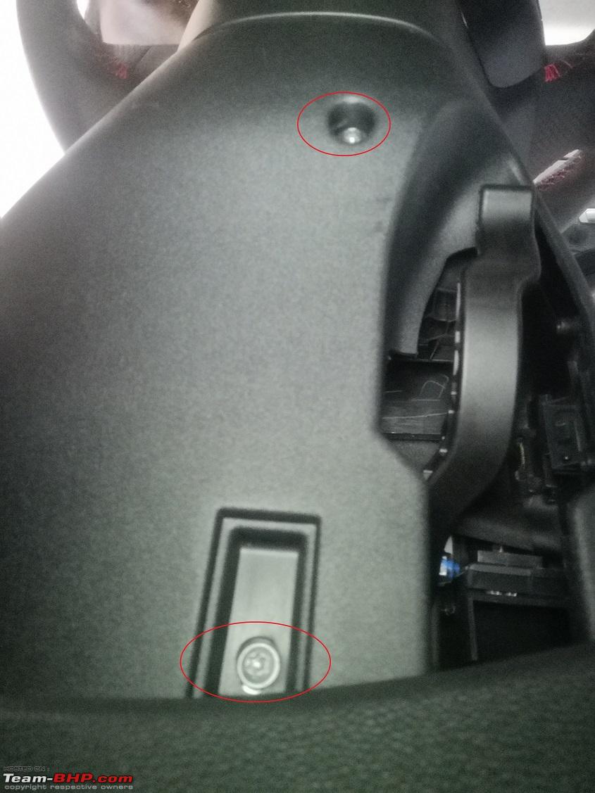

Then remove the two torx screws found on the lower panel on the steering.

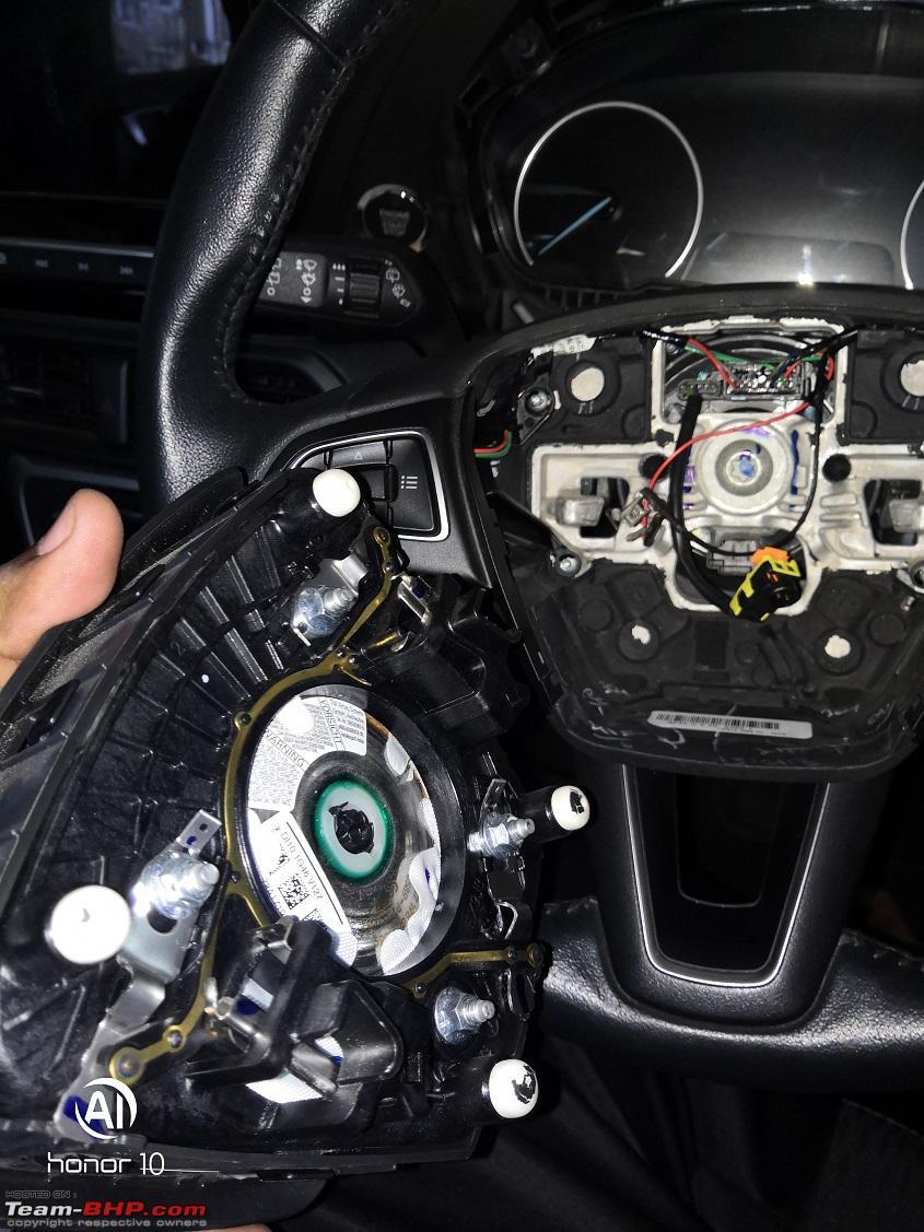

Rotate the steering wheel as shown in the image below to remove the airbag.
DIY: Upgrading the Indian EcoSport Titanium to the Global ST-Line Variant-17.jpg
Behind the steering wheel there will be two holes. We need to insert a flat screw driver to disengage the airbag connectors.
DIY: Upgrading the Indian EcoSport Titanium to the Global ST-Line Variant-18.jpg
Insert with patience once a click sound is heard. This means the airbag has been disengaged.
The operation should be done on the bottom side hole as well. Then the airbag will pop out.
DIY: Upgrading the Indian EcoSport Titanium to the Global ST-Line Variant-19.jpg
DIY: Upgrading the Indian EcoSport Titanium to the Global ST-Line Variant-20.jpg

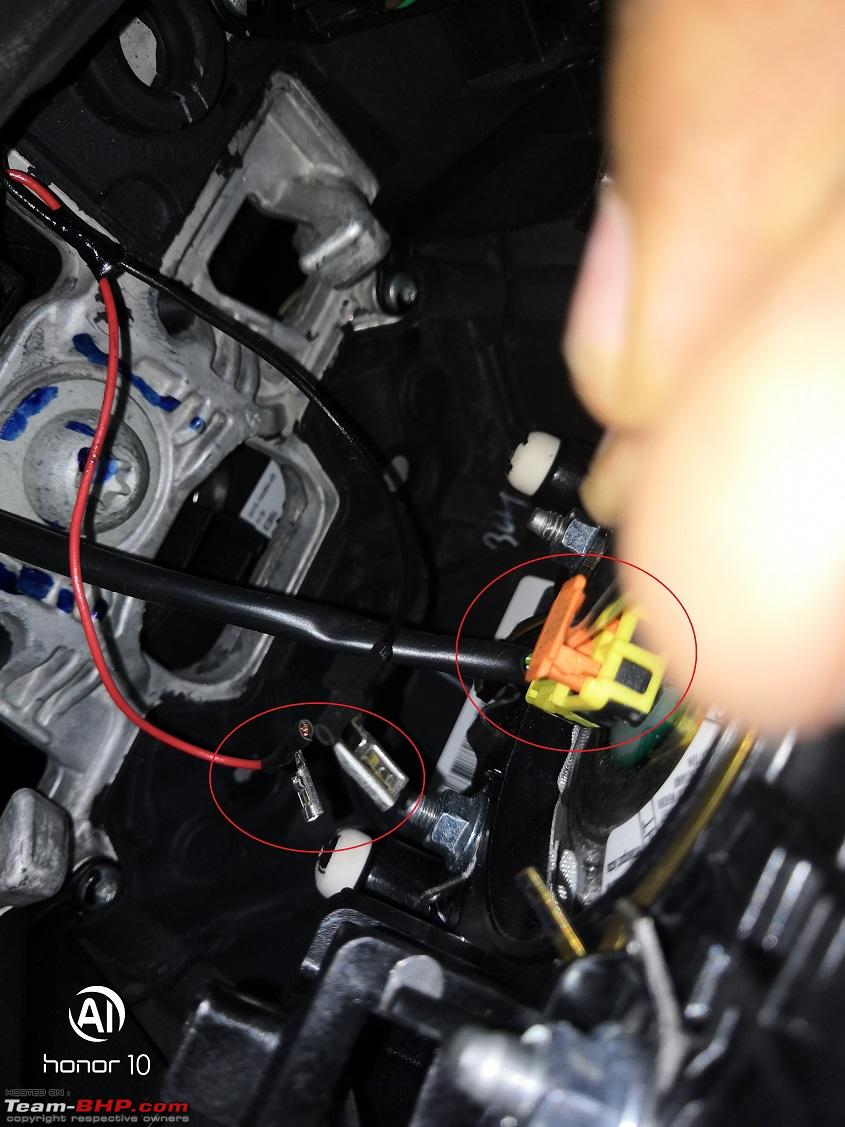

Disconnect the airbag and horn terminals using a flat screw driver.
DIY: Upgrading the Indian EcoSport Titanium to the Global ST-Line Variant-21.jpg
DIY: Upgrading the Indian EcoSport Titanium to the Global ST-Line Variant-22.jpg

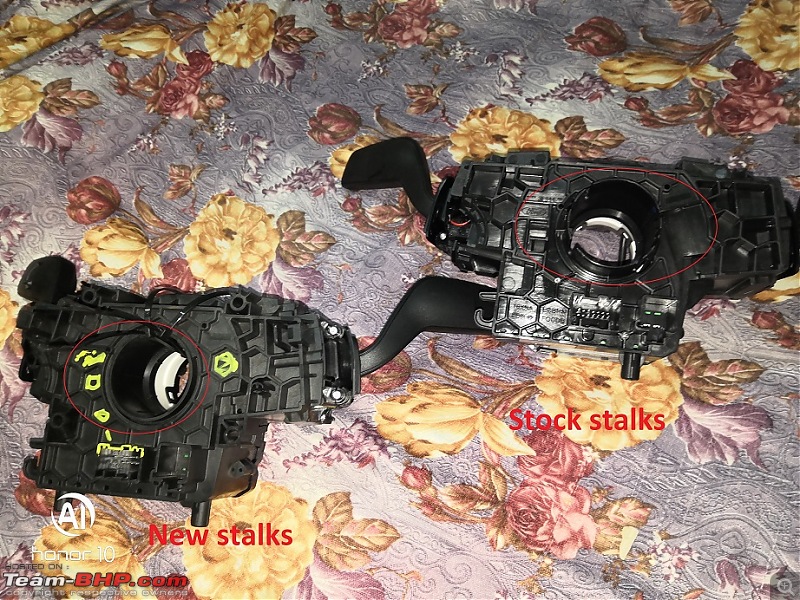

This is current Housing Assembly - Steering Column.
DIY: Upgrading the Indian EcoSport Titanium to the Global ST-Line Variant-25.jpg
Behind the Housing Assembly - Steering Column, there is metal clamp that has to be removed.
DIY: Upgrading the Indian EcoSport Titanium to the Global ST-Line Variant-26.jpg
Once the metal clamp is removed. Disconnect the connector and gently pull the Housing Assembly - Steering Column out.
DIY: Upgrading the Indian EcoSport Titanium to the Global ST-Line Variant-27.jpg

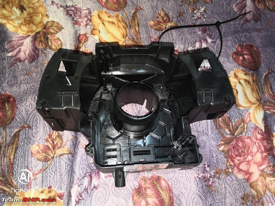

Once the Housing Assembly - Steering Column is removed, use a plastic tag to tie the clock spring as it tends to move freely and it has a thin wire inside that will carry the steering switch and airbag signals to the SCCM module.
The stock Housing Assembly has a plastic circular support which fits on the steering column. But the new Housing Assembly did not have it.
DIY: Upgrading the Indian EcoSport Titanium to the Global ST-Line Variant-28.jpg
So I decided to use the stock Housing Assembly frame with the new Housing Assembly components. I removed the components and installed it on the old frame itself.
To be continued on next reply section.
Continuation

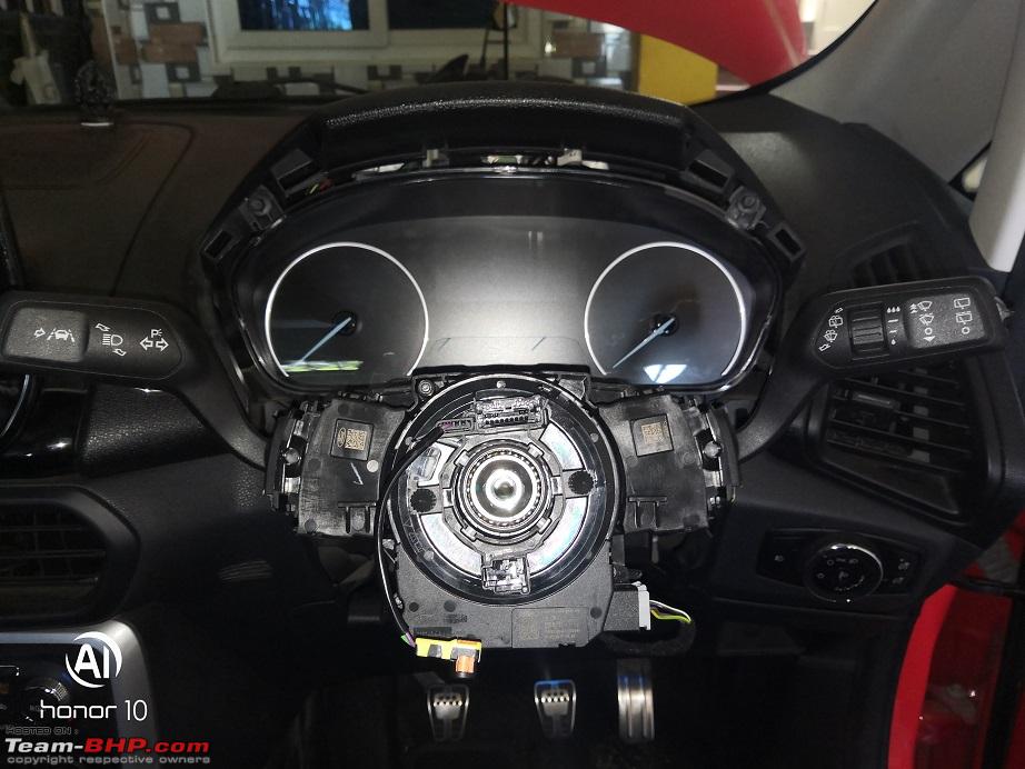

DIY: Upgrading the Indian EcoSport Titanium to the Global ST-Line Variant-29.jpg
The clock spring was removed first and then the PCB board. But the board was a kind of plastic molded fit. So I had a hard time removing it using a wire cutter.
DIY: Upgrading the Indian EcoSport Titanium to the Global ST-Line Variant-30.jpg
DIY: Upgrading the Indian EcoSport Titanium to the Global ST-Line Variant-31.jpg
DIY: Upgrading the Indian EcoSport Titanium to the Global ST-Line Variant-32.jpg
I removed the board from both the Housing Assemblies. These looked identical except for the two connectors. That will mount the indicator and wiper switch.

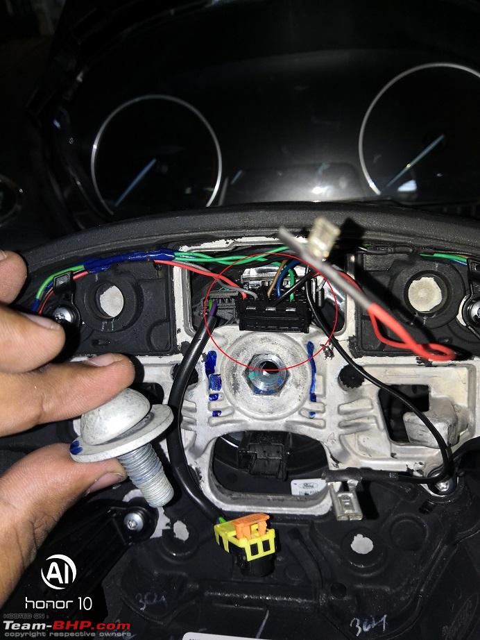

Then connect the multifunction, horn and airbag connectors.
DIY: Upgrading the Indian EcoSport Titanium to the Global ST-Line Variant-37.jpg
DIY: Upgrading the Indian EcoSport Titanium to the Global ST-Line Variant-38.jpg

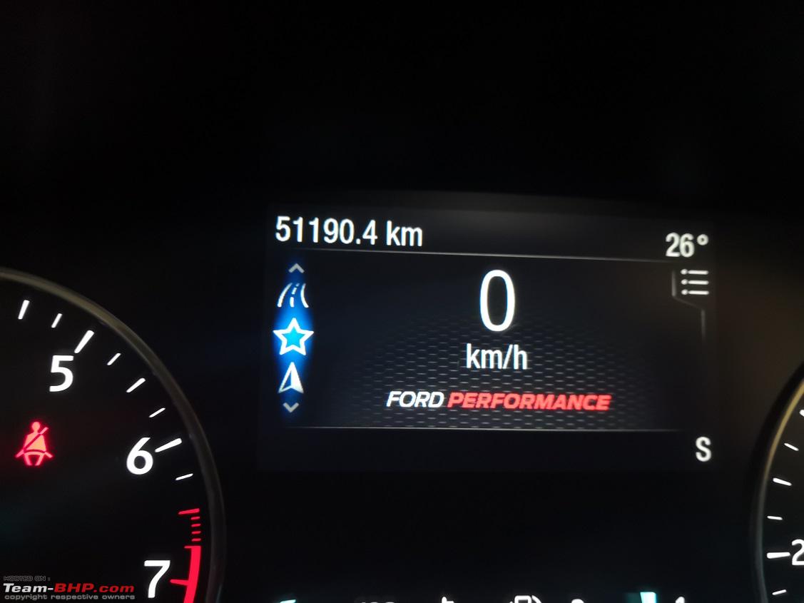

So now everything was fitted fine. But when the ignition was turned on, the RPM meter was not working and the odometer showed a different mileage.
This cleared my doubt that the driven mileage will be stored in the cluster module, but not on the engine ECU. The cluster had lot of STline variant features like lane departure warning, TPMS, Engine oil life, Traffic sign recognition, Blind spot detection and more. So I thought this is a complete mess I made.

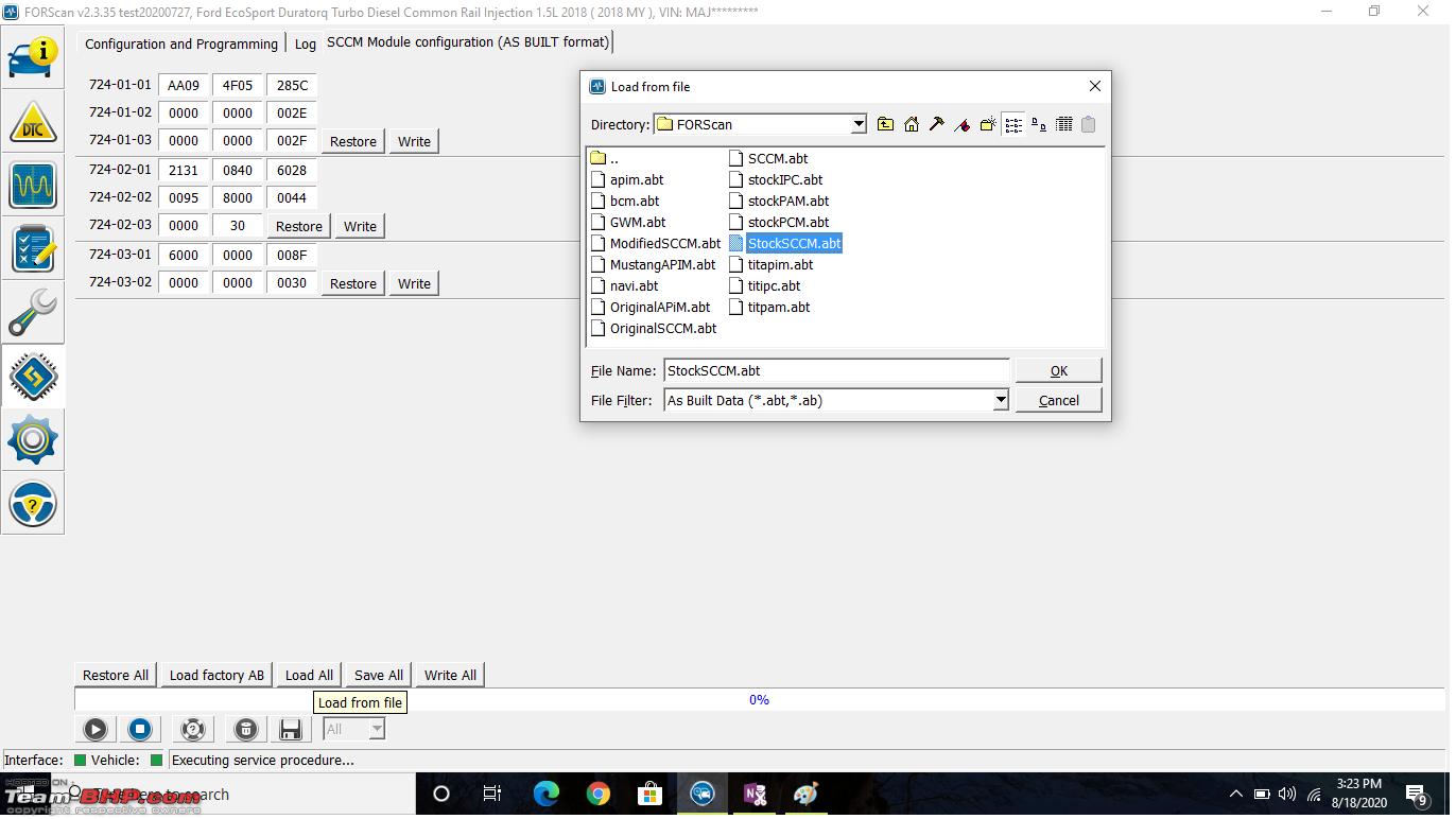

But later I found out that each module had to be configured. The manufacturer uses configuration programming to enable/disable features in the same hardware module which is shared in all variants e.g. Ambiente (Lower variant) and Titanium (Higher variant) have the same hardware modules like Body Control module. But the features of Titanium are just disabled using configuration programing.
So I’m done with installing the new Instrument cluster (MID), Steering wheel and Housing Assembly - Steering Column. Now I need to load the stock configuration to the new modules. First I need to load the stock configuration to IPC module. To do that, open the IPC module configuration. Load the saved configuration and click on the Write all button at the bottom.
DIY: Upgrading the Indian EcoSport Titanium to the Global ST-Line Variant-39.png

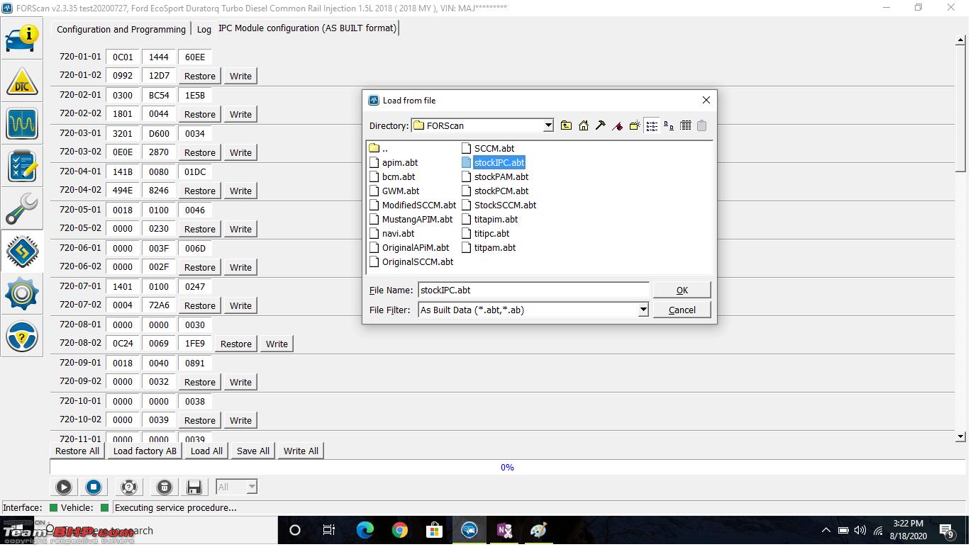

The write all operation will write the configuration to the module memory. Similarly, load the stock configuration for the SCCM module and write it.
DIY: Upgrading the Indian EcoSport Titanium to the Global ST-Line Variant-40.png
After loading the stock configuration, the instrument cluster and stalk started to function as expected, but the total driven mileage was different and the cruise control switch was not working.
DIY: Upgrading the Indian EcoSport Titanium to the Global ST-Line Variant-41.jpg
Actual km driven in my car during the installation: 49075
According to the new instrument cluster: 5794
To fix the mileage driven, I need to update the odometer. To do so, open IPC odometer Write function in Forscan .
And enter the actual km driven.
DIY: Upgrading the Indian EcoSport Titanium to the Global ST-Line Variant-42.jpg
Note this feature helps only to increase the mileage, it will not allow you to decrease it.
This below image is just to show you clearly, as the previous image was not clear.
DIY: Upgrading the Indian EcoSport Titanium to the Global ST-Line Variant-43.png
After this, the actual total km driven came back.
DIY: Upgrading the Indian EcoSport Titanium to the Global ST-Line Variant-44.jpg
Now I need to fix the steering cruise control switch. So open the SCCM module. Change the steering wheel switch with the part number (the part number is present below the switch) and write it.
DIY: Upgrading the Indian EcoSport Titanium to the Global ST-Line Variant-45.png
That’s all. The configuration programming is completed. All the expected things have started to work as expected. This was an amazing moment, as all my dreams came true and made my EcoSport as in European markets.
But somehow, I was still not happy and something was missing. So I looked into the APIM module to check whether the Splash screen on the Sync 3 could be updated and yes it did worked.
Just needed to select the splash screen we need and write it to APIM module configuration.
DIY: Upgrading the Indian EcoSport Titanium to the Global ST-Line Variant-46.png
DIY: Upgrading the Indian EcoSport Titanium to the Global ST-Line Variant-47.jpg
Then I was looking into the IPC module for extra functionalities. I found the Ford Performance view. Changed it and wrote the configuration to module memory .
DIY: Upgrading the Indian EcoSport Titanium to the Global ST-Line Variant-48.png
DIY: Upgrading the Indian EcoSport Titanium to the Global ST-Line Variant-49.jpg
I have updated my Ford Sync to 3.4 as Jithin's post on Facebook EcoSquads - The GANG of Ford EcoSports group.
That should bring the turn by turn direction to the MID when using google maps. But it did not work as the Gateway module needed to be configured to send the direction signal to the MID. As of now, it is only showing Android Auto and CarPlay but not the direction. I’m still working on it and will update once it is fixed.
DIY: Upgrading the Indian EcoSport Titanium to the Global ST-Line Variant-50.jpg
Now I was done with the DIY and Testing started. After testing, all the module upgrades worked as expected. I have driven the car for 2,000 km post the upgrade. So far no issues.
Now, each time I drive my car I feel like driving a premium car with international driving style, more a information loaded cluster and sporty red stitched steering wheel.

One query out of curiosity - why did you change the LH/RH stalks to reverse the wiper & lighting controls? Is it just to make it align visually with the international spec or you prefer this orientation as a user? It was a good thing that Ford corrected the orientation for our market, I really appreciated it when they did it. The reversed orientation means - you cannot quickly work the indicator when your left hand is on the gear stick & you have to move hand to the steering. With the indicator stalk on RH, you can always have access to it with right hand which is on the steering at all times.
This in fact has always been an important & safety aspect in my car decision making & I have never shortlisted cars that do not respect our RHD orientation & keep their EU/US spec stalk orientation.
I think it all comes down to what you are used to. I have been driving a Santro for 7 years, and was used to the RHS indicator stalk. When I switched to Duster 3 years back, I was finding it really hard to adjust to the LHS indicator stalk. But then it was a matter of getting used to, and post 3 years, I find it really hard to adjust to my brother's WagonR stalks. I now prefer the LHS config for indicators.
But I do agree with your safety aspect of left hand engaged controlling the gear lever. For me, it's not a big deal, as I don't drive with one hand on the steering and other on the gear lever.
Welcome to TBHP & what a way to announce your arrival. Fantastic project & nicely detailed implementation too. Thanks for sharing. Its a boon when customization of parameters / BCM are available via software like VCDS / Forscan. Us lesser mortals with Tata/Suzuki/Mahindra etc cars have to live with the answer "it can't be done" by the ASC folk.
Thanks Reinhard, I agree its the good thing Ford corrected the orientation for indian market . But Im used to it for past 5 years with my old Ford Figo and I do lot of European road trips. So I changed it in my car as well. And its purely a user preference .
