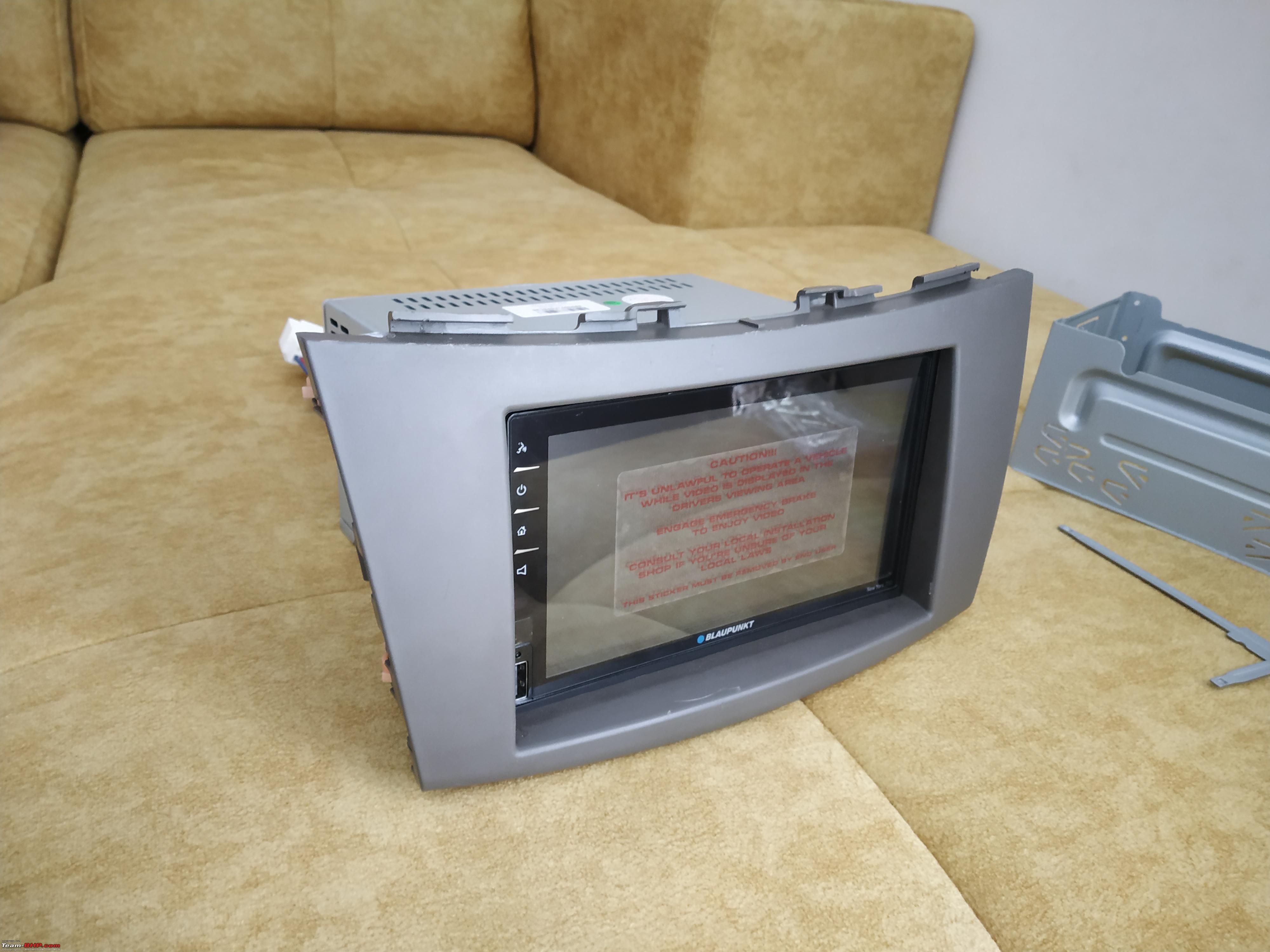

Update: On yesterday, I placed an order for an all new Head Unit with Android Auto that will get delivered on 18th.
Justice delivered. The BT buttons were mute spectators to the functional stereo buttons in the absence of a compatible HU.
Without too much thinking, although I had almost shortlisted the Blaupunkt New York 750, especially after knowing that Bhpian was already using one and I had seen it too, I took plunge and got a juicy deal at 11889/- due to the recent sale on Flipkart.
Let the pictures talk:
DIY: Steering-Mounted Audio & Bluetooth Controls (1st-Gen Ertiga)-img_20201017_144901.jpg
DIY: Steering-Mounted Audio & Bluetooth Controls (1st-Gen Ertiga)-img_20201017_144908.jpg
DIY: Steering-Mounted Audio & Bluetooth Controls (1st-Gen Ertiga)-img_20201018_072919.jpg
DIY: Steering-Mounted Audio & Bluetooth Controls (1st-Gen Ertiga)-img_20201019_103838.jpg
DIY: Steering-Mounted Audio & Bluetooth Controls (1st-Gen Ertiga)-img_20201022_114232.jpg
DIY: Steering-Mounted Audio & Bluetooth Controls (1st-Gen Ertiga)-img_20201022_114301.jpg
DIY: Steering-Mounted Audio & Bluetooth Controls (1st-Gen Ertiga)-img_20201019_112452.jpg
DIY: Steering-Mounted Audio & Bluetooth Controls (1st-Gen Ertiga)-img_20201019_110102.jpg
The HU also came with a complimentary reverse camera that I am yet to wire.
Overall, the product performs as promised. The Audio quality is definitely better to my outgoing Kenwood U5130 BT by many notches. Android Auto is wired and I am trying to see if my phone can manage this wirelessly (else I may be forced to buy a new phone, LOL) since I have heard many phones support wireless Android Auto (I am new to this as of now).
The JBL GTO 609 components now sound a LOT better with this HU. Vocals are clear and the low end bass also fantastic when I compare this with the Kenwood unit that I had.

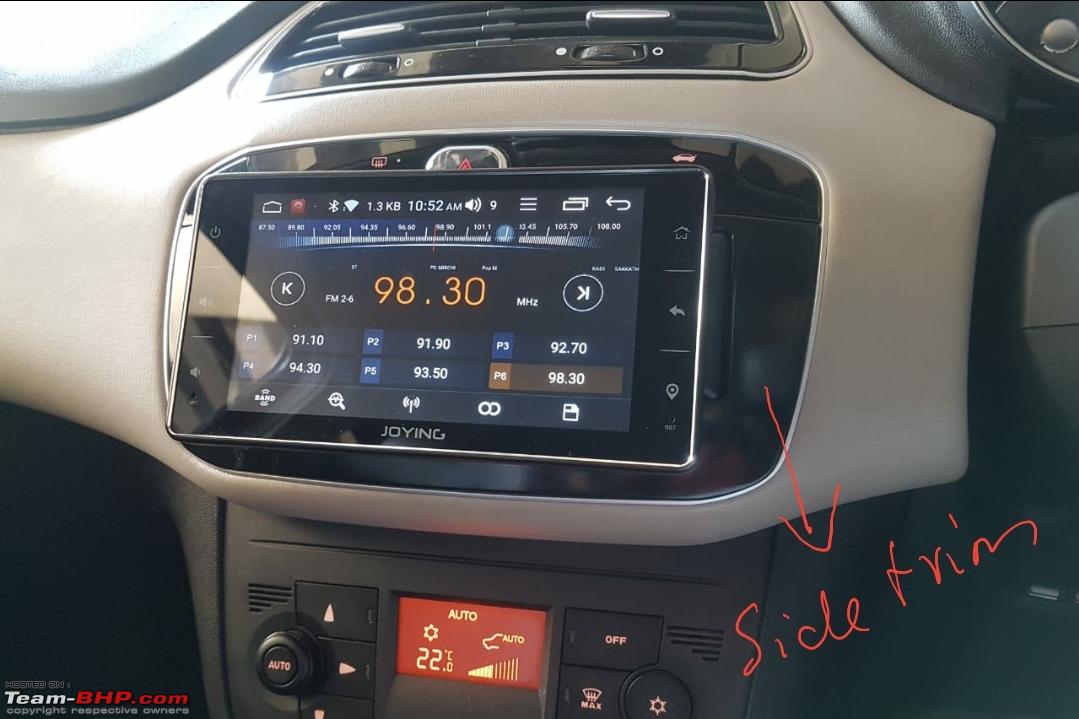

Sharing few images of the install from my friend's Punto/Abarth.
DIY: Steering-Mounted Audio & Bluetooth Controls (1st-Gen Ertiga)-img20201105wa0010.jpg
DIY: Steering-Mounted Audio & Bluetooth Controls (1st-Gen Ertiga)-img20201105wa0009.jpg
DIY: Steering-Mounted Audio & Bluetooth Controls (1st-Gen Ertiga)-img20201105wa0007.jpg
As you rightly say, the form factor for all Android HUs will more or less remain same. Also, there is enough space in the Linea to slide in the Android HU after taking out the OE HU.
DIY: Steering-Mounted Audio & Bluetooth Controls (1st-Gen Ertiga)-images-26.jpeg
Also notice enough space above and below OE HU except that the Hazard switch may be partially covered like you see in Abarth too.
And yes, all steering controls work on my friend's car.
