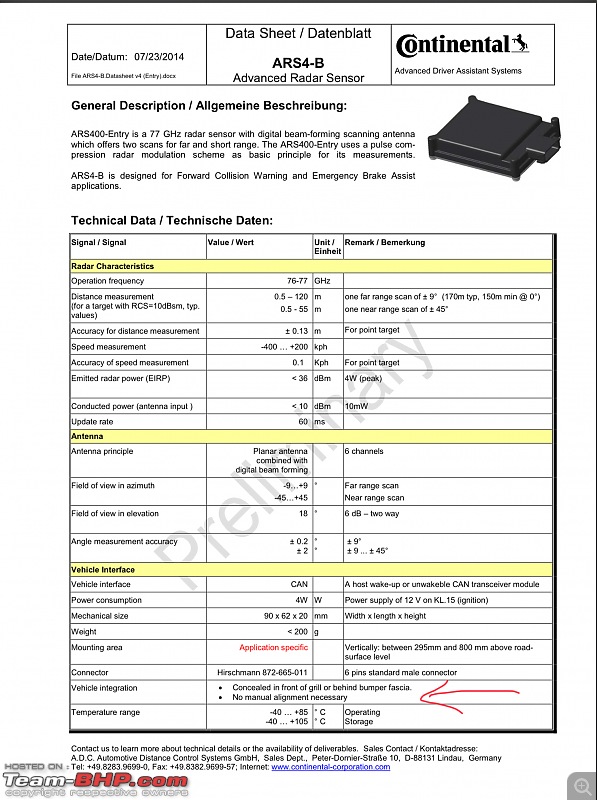

Amazing work man, that's some serious research and experimenting to get this complete. And I am thrilled about this since this domain is my bread and butter since a few years though I work for a different company and not VW. What is more interesting is your feedback about its performance in Indian conditions. I do extensive vehicle tests but in European countries and someday would like to do the same in India, if my company gives me a chance. However the system I work on its a much complex one compared to the setup in the Tiguan.
Speaking about the radar calibration, what you have shown is a Continental ARS radar which is also used by us but an advanced version. Calibration is very important and two things to note here is 1. The radar does have a self calibration feature which usually happens if there is a shift due to a slight dislocation, flex etc and this is done after every soft reset of the radar unit, or if there is a sudden impact on the area where the radar sits. This happens over a 2km drive and on its own. 2. The radar can detect any major calibration issues or non calibration from when you fit a new one out of the box and if this happens, it won't allow the safety or ACC features to work along with a DTC triggered. The radar has its internal IMU and self diagnosis. Even then you will have to drive for a bit after resetting the radar. Apart from this unlike the camera, calibrating the radar isn't necessary through special means.
DIY: Adaptive Cruise Control (ACC) retrofit on our VW Tiguan-951b82d1c9c544ac9b1903932cfc1b5e.jpeg
Image source http://continental.automotive-approv...DNdiQCIaRDQv_a
Hence I think what you got is a pre calibrated radar from the car it was picked up from and the same thing would work here without the need of re calibration and the minor calibration would have been automatically done. So be careful if you ever have to reset the whole radar unit in the future. But enjoy the feature
One question I had was regarding the radar settings in the coding tool. If you haven't already done this before, then do check the coding of the radar especially for LHD/RHD driving and some other regional settings. They would be used to determine some decision making algorithms and you don't want them to be swapped. How is the performance in two lane roads with oncoming traffic?
Thanks for the appreciation and an even bigger thanks for sharing extensive details about how this Radar works. As you right said, during the installation, the radar was indeed coded for RHD.
I think I'll drive for a while longer to comment on the performance on two lane roads, but I believe this could be slightly risky since it does start detecting vehicles while sometimes come in the line of sight especially during overtaking manouevers. The immediate consequence of that could be someone banging into the car from the rear as the Tiguan definite slows down when it detects an obstacle or when it senses a in the preselected safe distance.
Glad to read about the partial self calibration characteristic, and yes, a reason for buying a radar from a car, was the hope that it would be calibrated. I did speak to Volkswagen about the calibration aspect and they said they'd need to send the car to the Regional Training Centre, Plant or possibly arrange a Flying Doctor for calibration issues if any. This scenario should most likely improve if they introduce more vehicles with Radar enabled features. I will keep sharing updates about the performance of this radar
