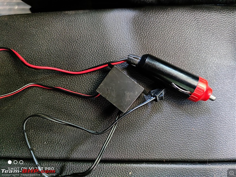

12V El-Wire Driver
DIY : Neon Highlights for the dashboard (Renault Triber)-img_20210313_153409min.jpg

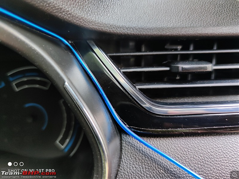

Steps :
  1. Figure out how you're going to route the el-wire, I would recommend routing it via the glossy surfaces as the tape can hold on stronger to these surfaces.
    DIY : Neon Highlights for the dashboard (Renault Triber)-elwire.jpeg
  2. Clean the surface with isopropyl alcohol on a micro-fiber cloth
    DIY : Neon Highlights for the dashboard (Renault Triber)-img_20210313_152619min.jpg
    DIY : Neon Highlights for the dashboard (Renault Triber)-img_20210313_152725min.jpg
  3. Place the double sided tape
    DIY : Neon Highlights for the dashboard (Renault Triber)-img_20210313_152855min.jpg
  4. Place the el-wire
    DIY : Neon Highlights for the dashboard (Renault Triber)-img_20210313_152931min.jpg
    DIY : Neon Highlights for the dashboard (Renault Triber)-img_20210313_152959min.jpg
  5. Route the cables to the driver and socket
    DIY : Neon Highlights for the dashboard (Renault Triber)-img_20210313_153701min.jpg

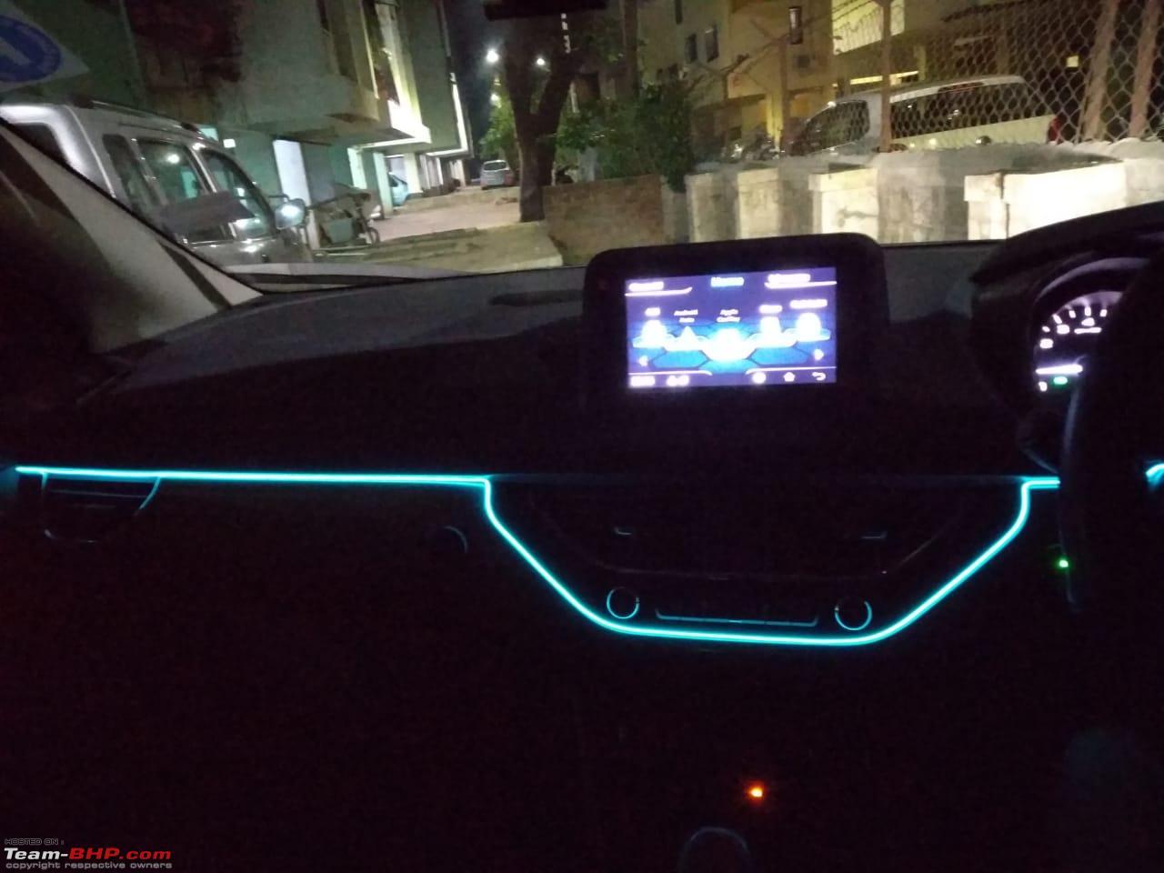

Nice job. This is one of the cheapest and coolest mods one can go for. Technically its EL (Electro-Luminescent) wire, not neon per say I believe. Works with the principal of luminescence from a copper based electric conductor wire when subjected to a high frequency alternating current (AC) supply. The black little box is a compact inverter that converts the 12V DC supply from car electricals to an AC supply to this wire.
I have installed it in both my cars - Nexon & Alto K10. Fantastic results. I opted for what typically is called "Ice Blue" colour. Luckily I didn't have to use any adhesives / tapes anywhere at all. Complete setup I could achieve (DIY) by just plugging the edge into panel joints as its supposed to be. In the Nexon I have hooked it up to the ACC fuse. So its always ON when car is running. In the Alto I found it easier to hook it up to the position lamps. So the ambient light strip turns ON when car lights are switched on. Thanks for your thread. Here are a few shots of my setup.
DIY : Neon Highlights for the dashboard (Renault Triber)-inparking.jpeg
DIY : Neon Highlights for the dashboard (Renault Triber)-onroad.jpeg
DIY : Neon Highlights for the dashboard (Renault Triber)-img_20210117_123904.jpg
DIY : Neon Highlights for the dashboard (Renault Triber)-img_20210117_210800.jpg
