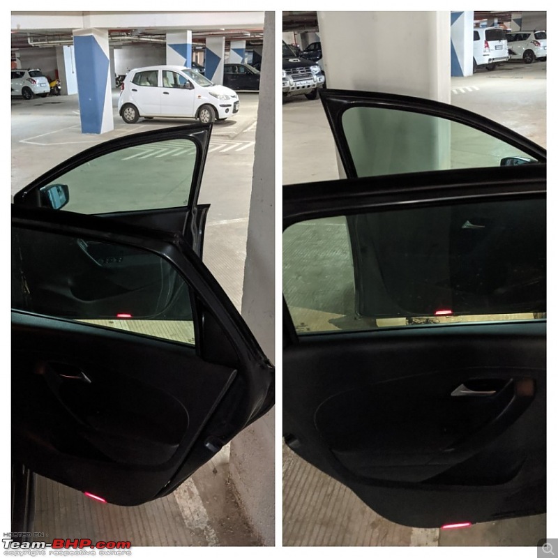

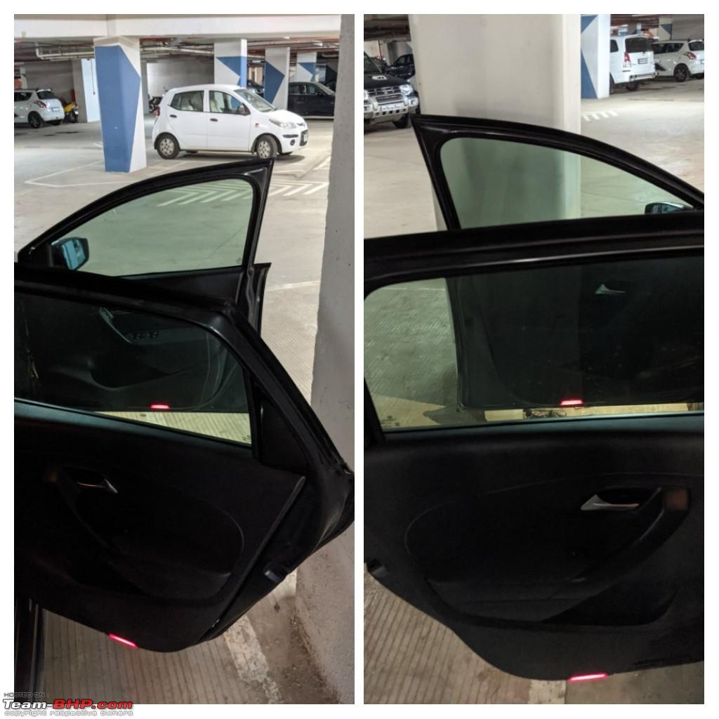

Courtesy lights on door panels
VW Polo GT TSI | Lockdown DIY updates | Boot light, lock & unlock switch, puddle lamps-courtesy-lights.jpg
I am a big fan of lights, because I find that they really up the premium quotient of the car. A common feature in high-end cars is the courtesy lights in the door panels. In the VW family, this feature is available in the Jetta and higher segment cars. So sometime in 2019 when I saw this post by user Benzinkopf on the UK POLOS forum, I immediately knew that I wanted these in my car too.
I reached out to Benzinkopf, and he was more than happy to help. His real name is Amir, and he is from Malaysia. We have kept in touch ever since, and I find it very helpful to bounce ideas off him. He is a 3D printing expert, and keeps designing and printing small parts for his DIYs.
VW Polo GT TSI | Lockdown DIY updates | Boot light, lock & unlock switch, puddle lamps-brackets-templates.jpg
VW Polo GT TSI | Lockdown DIY updates | Boot light, lock & unlock switch, puddle lamps-template.jpg
VW Polo GT TSI | Lockdown DIY updates | Boot light, lock & unlock switch, puddle lamps-amir-1.jpg
VW Polo GT TSI | Lockdown DIY updates | Boot light, lock & unlock switch, puddle lamps-amir-2.jpg
The way Amir has done it, it requires a hole to be cut in the door panel. A 3D printed bracket specially designed to hold the courtesy light unit (part number 3GD 947 411, purchased on AliExpress) is then fitted into the hole. I took the electrical connections from inside the door panel itself.

Hi Gaurav. The part number is 3GD 947 411, and it is common to a lot of VW models like the Jetta, Touran, etc. I had purchased them on AliExpress. To power them, I have tapped the window motor for the +ve signal and door lock for the GND signal, so that each one lights up only when the respective door is opened. Hope this helps.

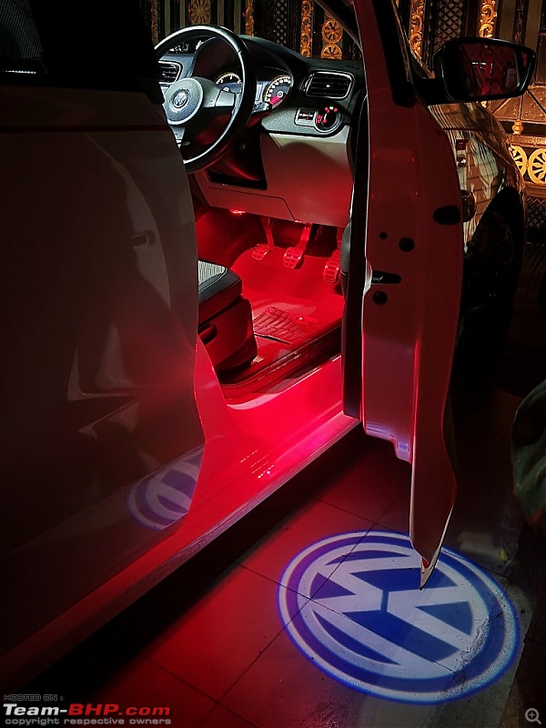

I wish I knew this earlier. I came across these kind of courtesy lights on AliExpress before the ban happened and ordered the ones which project the VW logo. Then lockdown happened and I had some time to execute it but faced some issues while cutting the door panels. If I look closely there are little gaps (negligible) around the lamp due to improper cutting. Also the fitment is a little poor due to that. I might try getting in touch with him via UKPOLOS forum to acquire these brackets.
VW Polo GT TSI | Lockdown DIY updates | Boot light, lock & unlock switch, puddle lamps-img_0324.jpg
(Minor gap on the left top corner)
VW Polo GT TSI | Lockdown DIY updates | Boot light, lock & unlock switch, puddle lamps-20210209_19505001.jpeg
Although I was happy with the final results (The logo looks a bit skewed due to the pavement)
