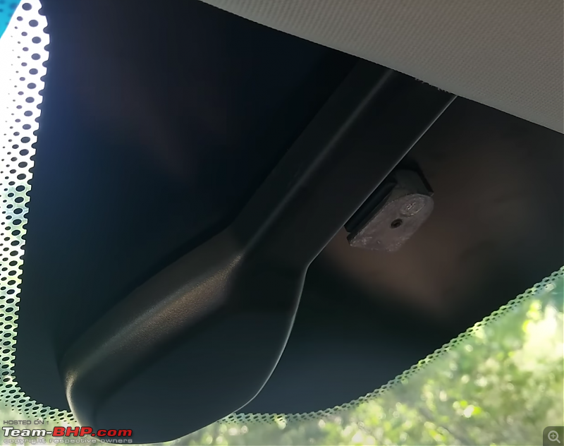

1. Pull the IRVM upwards to pull it out of its adapter.
2. Put the wedge button in the adapter.
DIY Install: Auto-Dimming IRVM without cutting wires-t-wedge-button.png
3. Use allen key number 2 to screw the grub screw.
(Note: Don’t screw it too tight otherwise you will break the mounting bracket. Do it gently and keep checking if it is tight enough or not.)
4. Take the auto-dimming IRVM and slide it in the wedge button. Make sure the orientation is correct, the button should be on the bottom.
5. Use a T20 Torx screwdriver and screw the screw provided here.
(Note: Make sure you don’t screw it too tight otherwise you will damage the IRVM.)

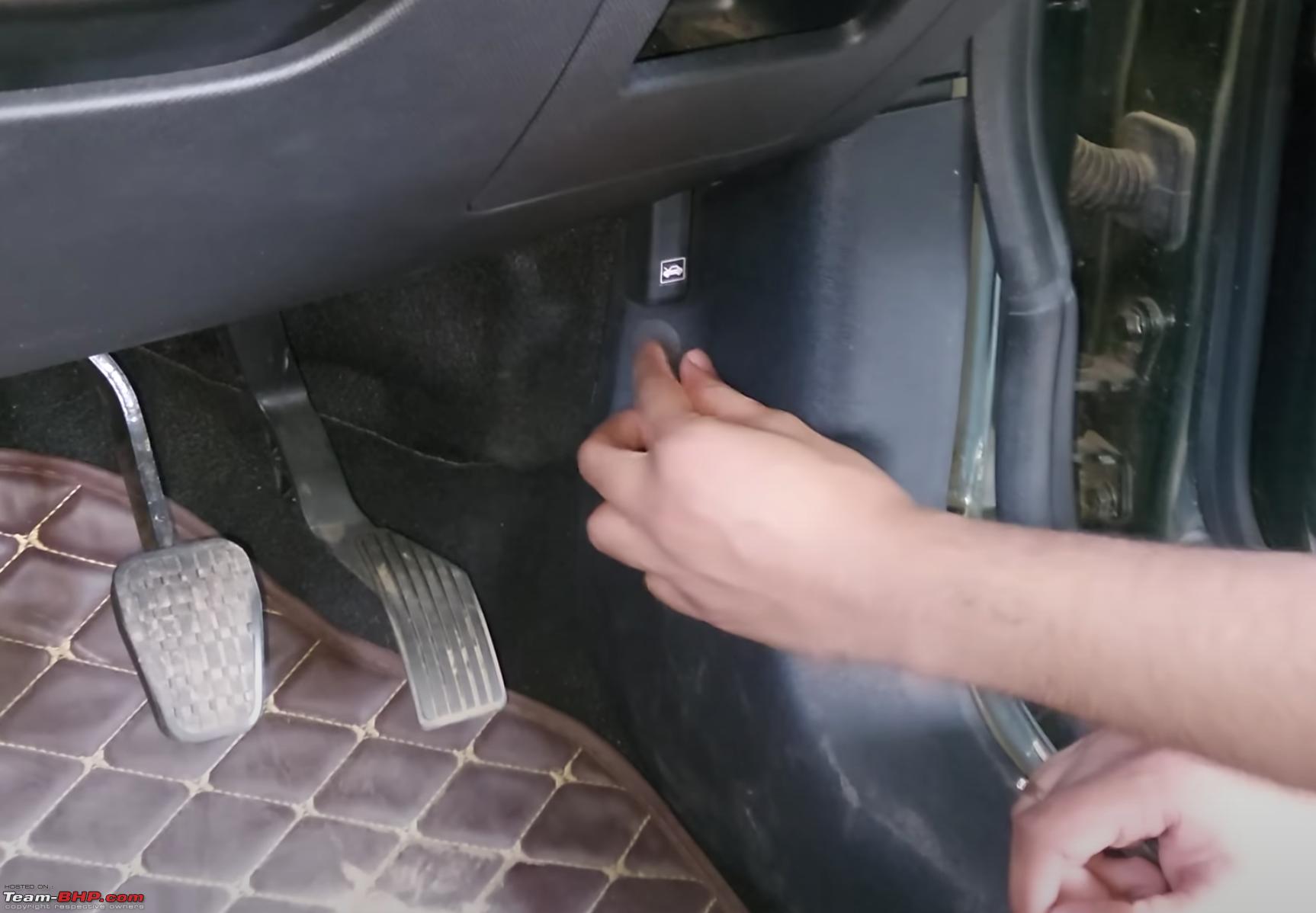

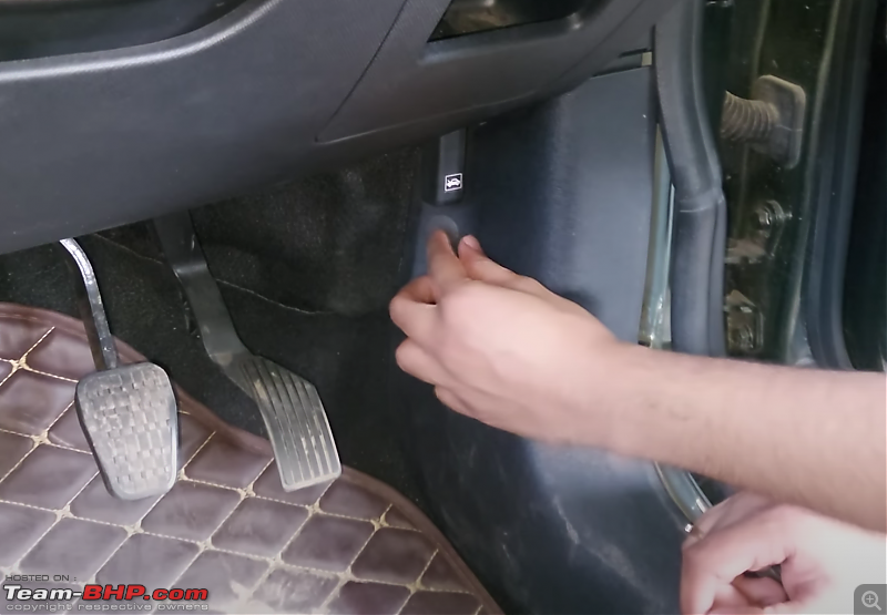

7. Remove the weather strip near Lower A-Pillar Trim, remove the tree clip just below the bonnet button and remove the Lower A-Pillar Trim.
(Note: Remove it gently as it is held at its place using clips. Using excessive force might break the clips and then you will be unable to put the panel back properly.)

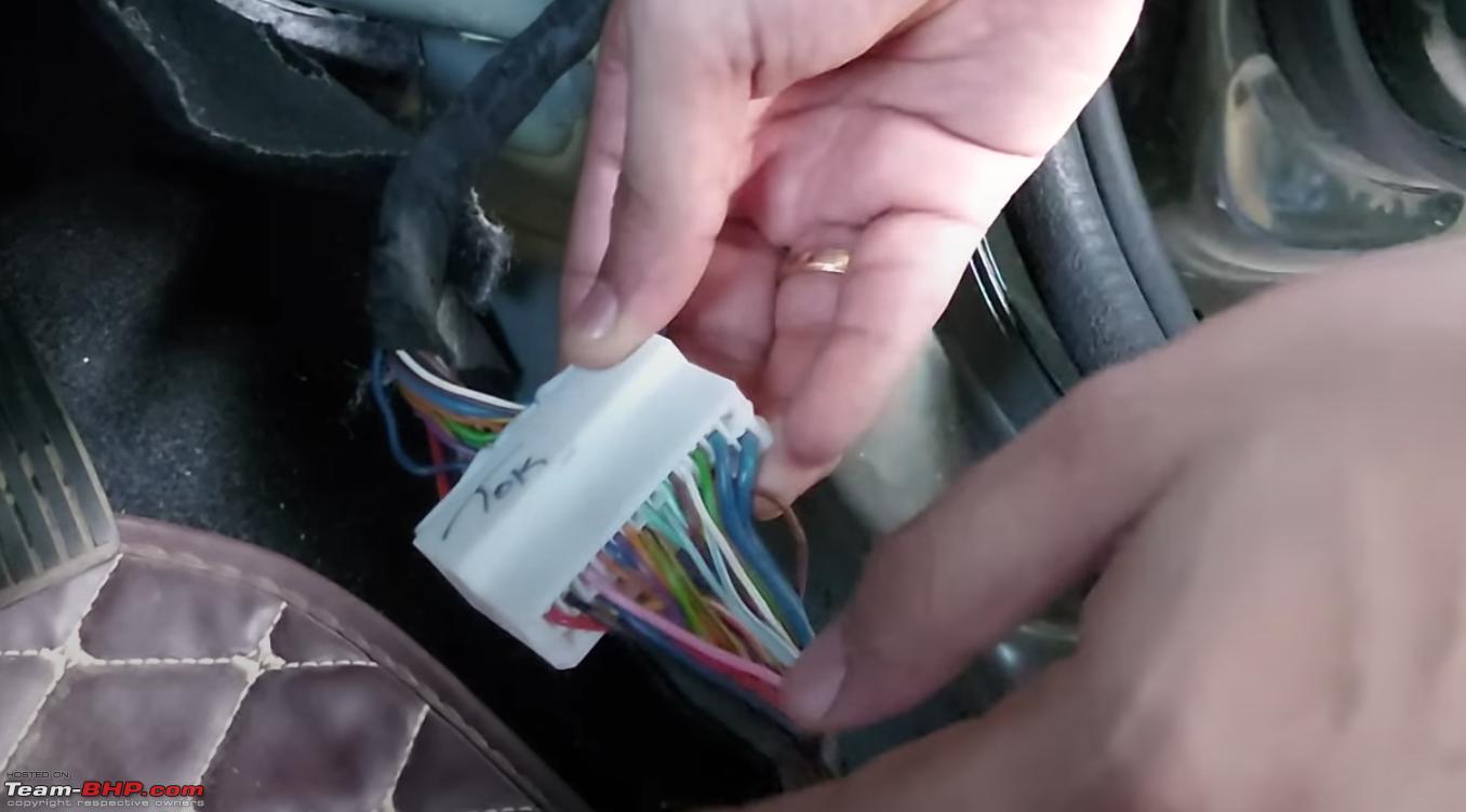

8. In the manual, there was an error regarding the wiring for Nexon but the wiring matched for Altroz. So, just to be on the safe side, I used a multimeter to check the correct connection point. Put the red terminal of the multimeter in the second slot with black wire and touch the black terminal on the car's body. Engage reverse gear, multimeter should show 12V, this means that this is the correct socket for the connection.

11. Now, we will connect the mirror’s black wire to the main black wire (reverse wire in 34 pin white socket, pin no. 2) we just used in step 8. Put the mirror’s black wire in the scotch lock. Put the scotch lock on the main wire and press it using pliers.

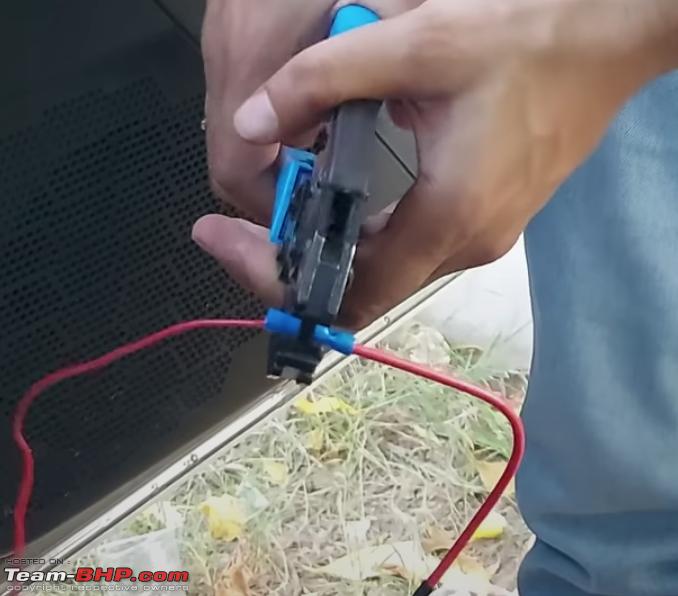

12. Connect the red wire to the fuse tap using a crimping tool.

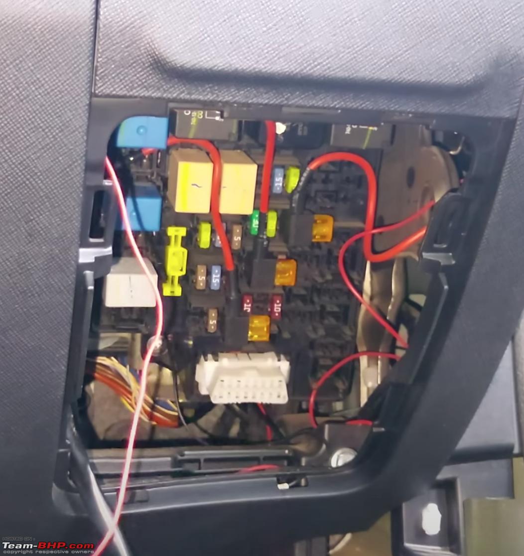

13. Remove the fuse box Panel.
14. Remove the F12 fuse which is the one used for ignition. Now, put the fuse in the fuse tap and put the fuse tap in the fuse box.
(Note: Push the wire from below so that you can put back the panel.)
