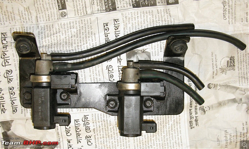

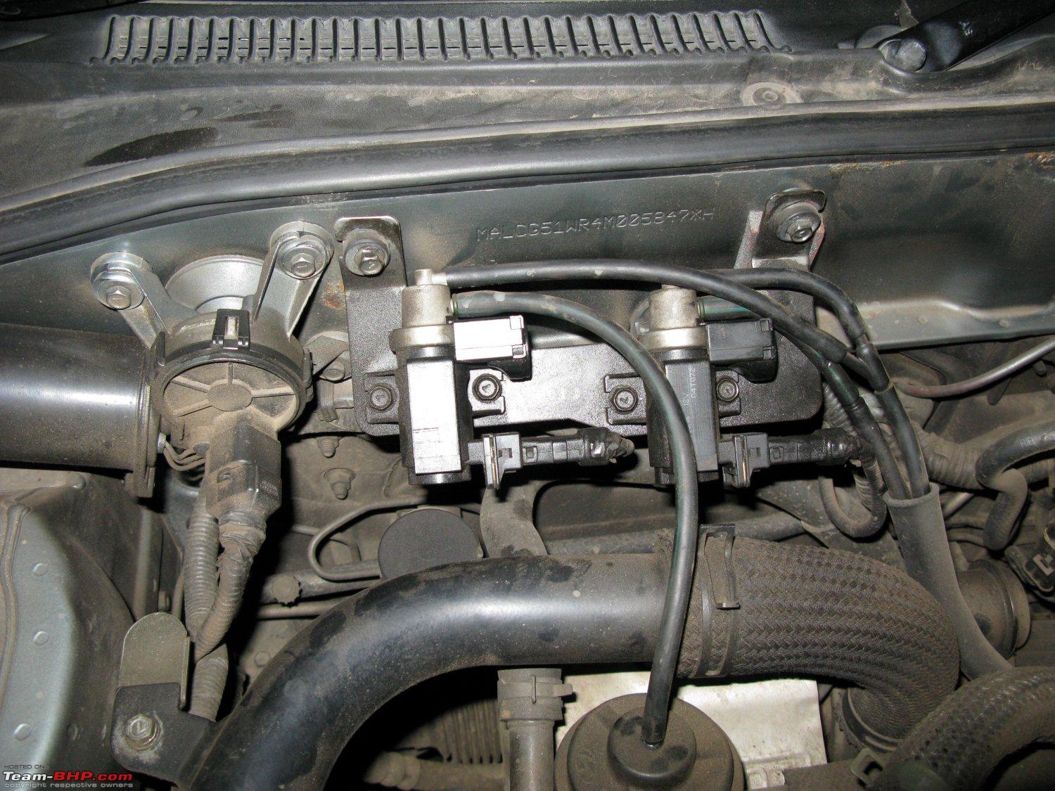

Photos, as demanded & promised
Accent Viva Crdi: Purge Control Solenoid Valves - Rs.16.5k! EDIT: Fixin it DIY style!-circuit.jpg
Accent Viva Crdi: Purge Control Solenoid Valves - Rs.16.5k! EDIT: Fixin it DIY style!-installed.jpg
Accent Viva Crdi: Purge Control Solenoid Valves - Rs.16.5k! EDIT: Fixin it DIY style!-uninstalled.jpg

But it sure looks like that setup is part of an Exhaust Gas Recirculation system. I would try and see if it was possible to plug the vacuum line going down to the round disc shaped vacuum diaphram. This would keep the EGR valve closed at all times, and give you more power.
Those solenoids are electrically controlled valves that allow the vacuum circuit to pull vacuum on the EGR valve. If they are stuck open you will be getting exhaust gas recirculation at all times, which will lower power. But rather than trying to repair it, I would see if it is possible to push it shut permanently. Then pull the vacuum line going to the EGR valve, and you will have more power and not spend any money.
