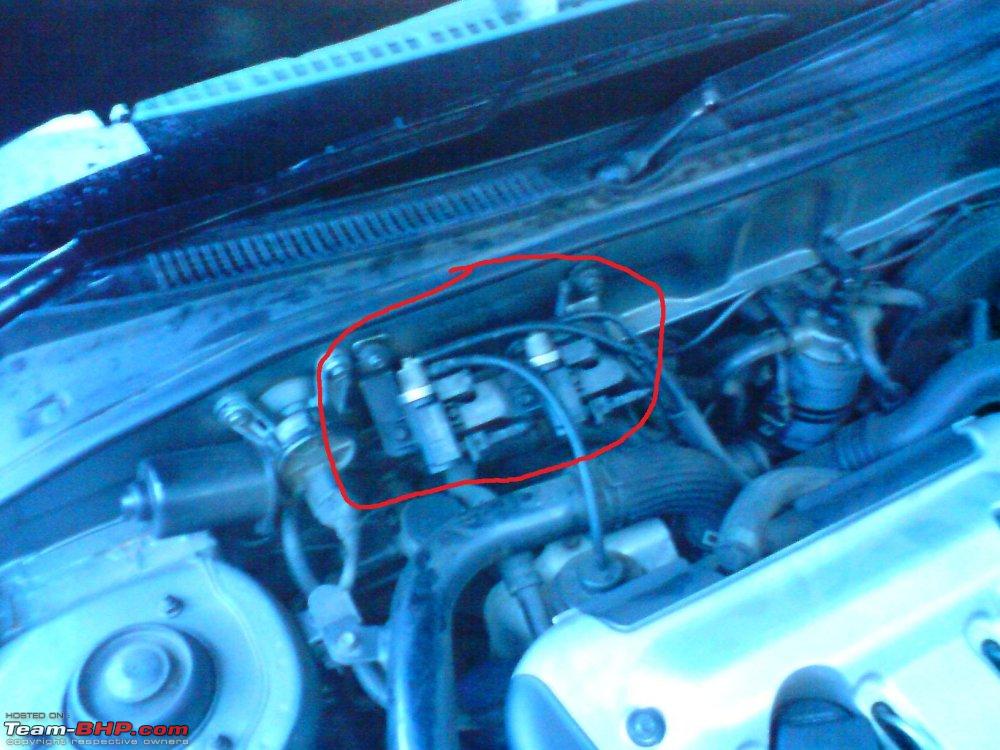

Adding pics of the Purge Control Solenoid Valves..

Update: Opened the valves from the car. One of them is definitely not working. If I blow into one, the air passes through. (Just like dadu predicted) The other one, is shut.
As far as I know, all solenoid valves should be shut in unconnected state.
So, I am working on the one which is open. Maybe some elbow grease will breathe some life into it.
