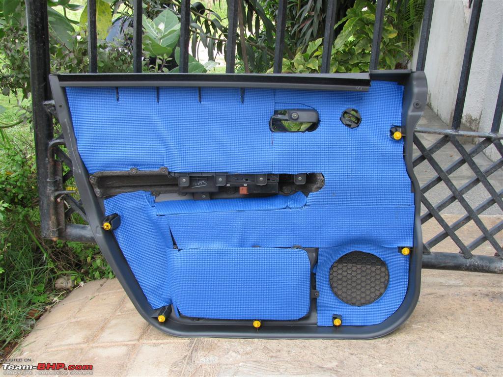

Originally Posted by intoxicangel View Post
A great idea, did the same for my Swift 2 weeks ago. Sound from the Compos upfront has definitely improved, the bass is richer alright!! But off late started hearing a sort of rattling from the left side door panel. Checked if all the plugs (the yellow expanding plugs that hold the panel onto the door) had sat correctly, all fine there. But still hear a rattle of sorts. Any ideas what that could be?
Check the image with the markings. That piece was vibrating quite often and we in fact used super glue to stick it off completely.
DIY : Damping the swift with yoga mats and making it rattle free-img_0681-large.jpg
Also the driver side window has started to rattle a lot during high volumes. Is that normal? Is it something to worry about and get checked or is that normal?
When you say window does it mean the door pads or the whole door by itself ?
Did a little insulation type work with the same material around the rear parcel wood board (basically the places where the panel touches the interiors of the car, like the door and the seats), now there is a rattle from the rear as well. Checked things like the spare tyre and jack etc.. all in place locked in tight. What could be the other reason? Tried opening the rear door panel, is a circus with plugs. Worry being if they would break, I know I can get replacement plugs.
Mate its a time consuming process and you need a lot of patience. Take time off on a Sunday and play some music with a lot of bass. Zero down on the plastics that rattle and mark them.
Once you open the door pad ensure that you have managed to took all nooks and crannies with some super glue.Check this door panel
DIY : Damping the swift with yoga mats and making it rattle free-img_0690-large.jpg
We ensured that all small vibrations are taken care of 1st by knocking the pads and checking for unwanted rattles. Where ever we couldn't stick the yoga mat, it was sealed off with the rubber adhesive.
