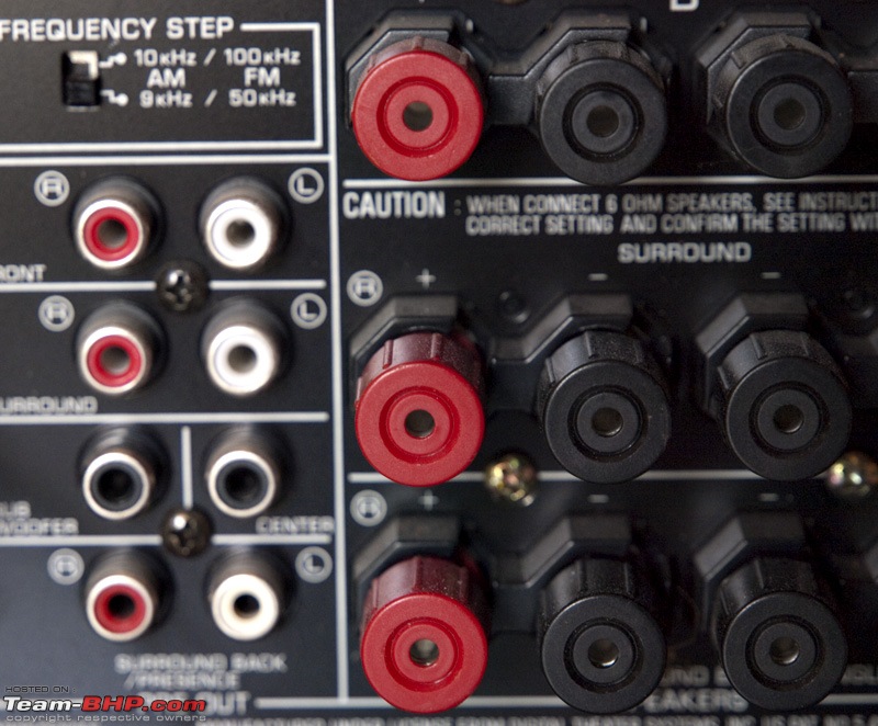

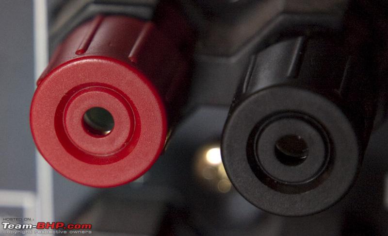

Originally Posted by Sam Kapasi View Post
You bought the wrong plugs. Guaranteed. The sizes of the terminals are standardized. Or you're putting it in the wrong hole, lol.
Originally Posted by Bass&Trouble View Post
There should be small plastic caps on the speaker terminals where the banana is to be shoved in. Did you remove those?
And do the banana pins you use have some sort of springy mechanism running along their length? If yes, pushing a bit harder could help.
This time while setting up the home theatre, I decided to take couple of close-up snaps of the connectors, which are clearly not banana plug terminals.
Does anyone still think these are banana plug terminals?

Old 24th June 2009, 09:52   #49
navin's Avatar
Join Date: Mar 2004
Posts: 25,409
Thanked: 9,968 Times
Samu can you stuff the banana plug in the hole in the center of the terminal?

Old 10th July 2009, 22:03   #51
naughty001
Posts: n/a
@ Samurai - those are definitely screw on type terminals. My old Pioneer A400x from around 15 years back had something like that. they will not accept banana plugs in any form or shape, nor will you be able to use any type of spade termination, all you can do is to use bare wire there unfortunately
