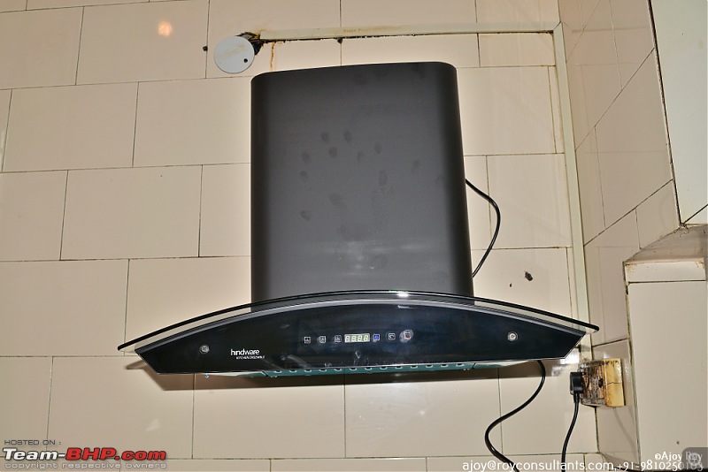

We bought a "Hindware" self cleaning chimney a few months back. Here are amy observations
. Self cleaning works like a charm. Switch the button and in 10 minutes oil collects in the receiver.
. The chimney is a "Baffle Filter" type, so in normal operation the oil intercepted by the baffles also collects in the drip tray.
. If there is a lot of heavy frying, then the baffles need to be cleaned with soap water once a week.
. We run the "Self Cleaning" (which is heater based) once a month.
Installed
One thing that I noticed is that a few brands are offering the same model, so it an OEM import.
